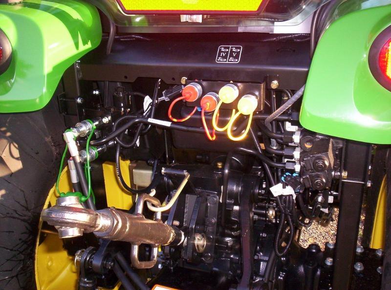

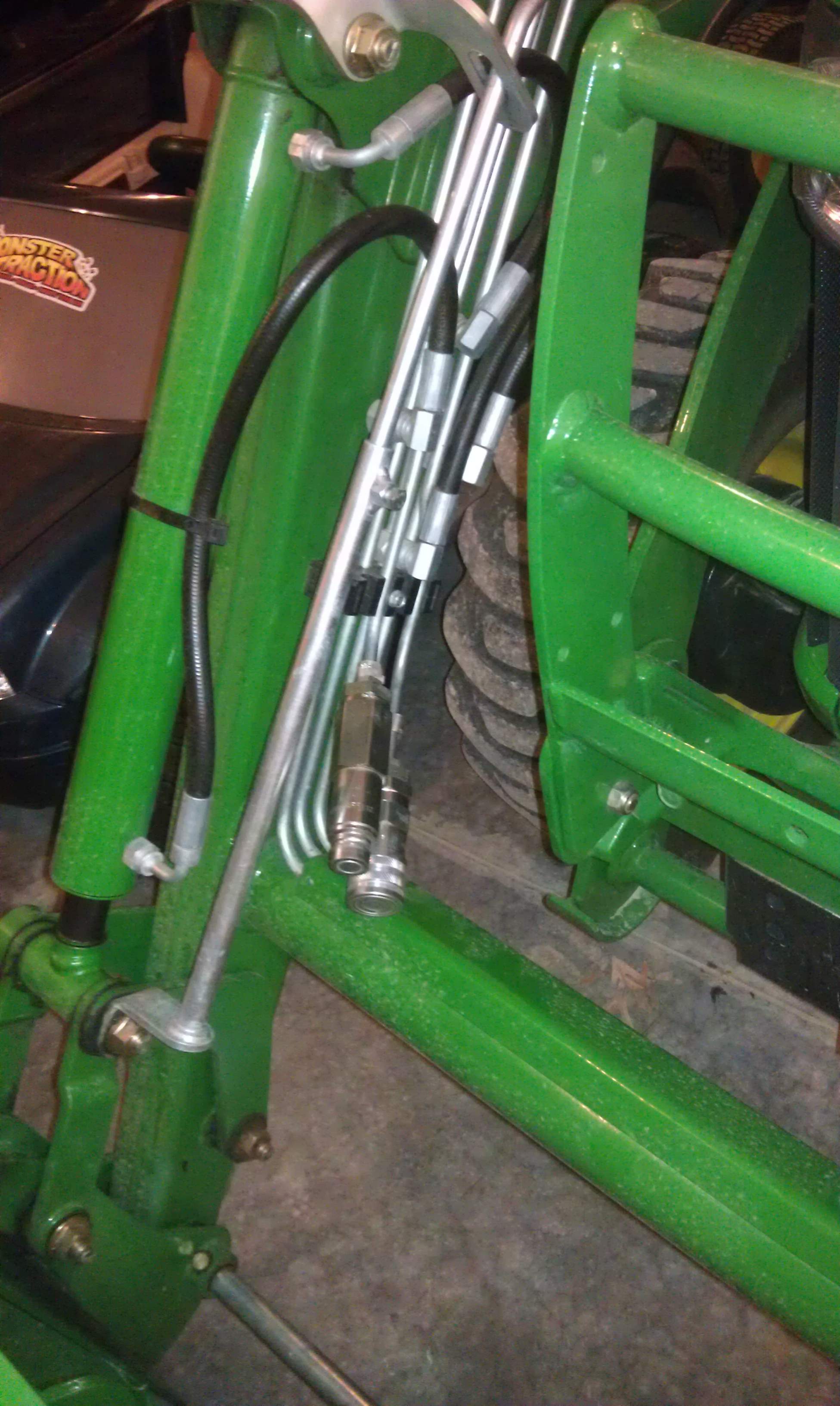

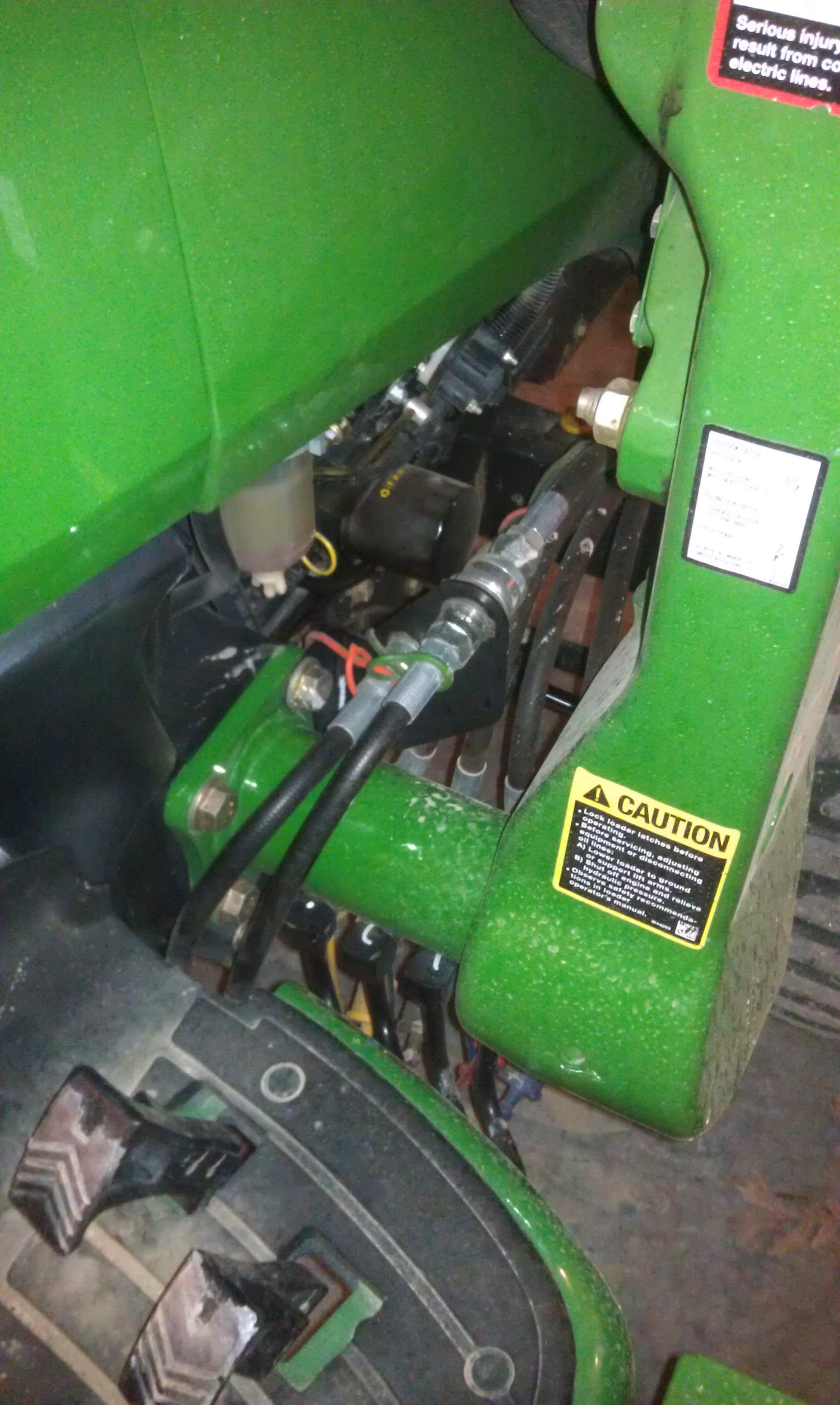

My tractor is not a cab model but you should have a set of 1/2" couplers for the third SCV just like in the bottom of the first picture. I think on the cab model they are in the middle. All the rest should look the same.

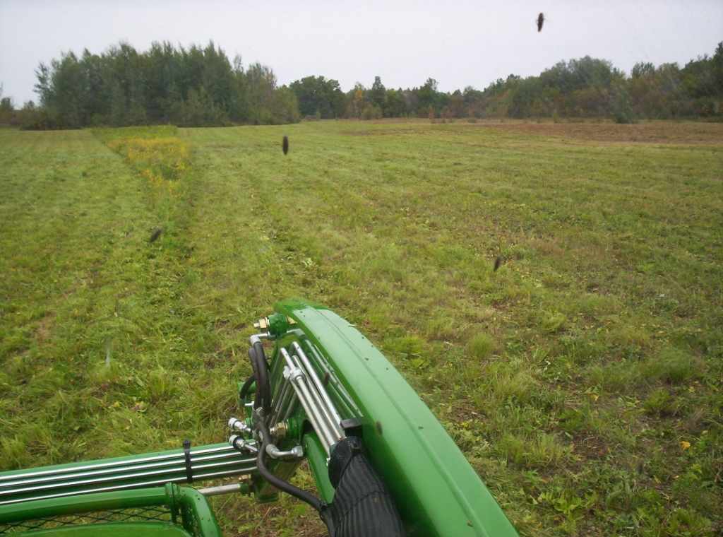

Are you sure you don't already have the 3rd function installed? You are describing my exact set-up but without the hardlines.

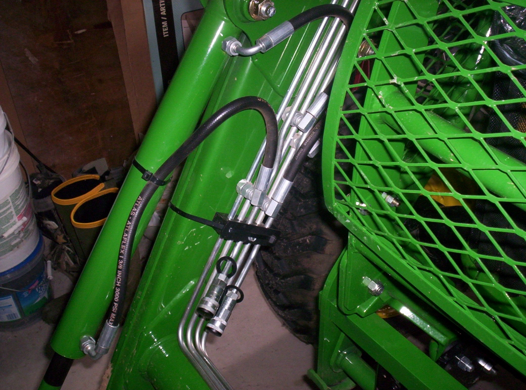

The part # is BW15630 for the hardline kit for your tractor. It runs about $350.
This is what the hardline kit looks like installed. If you look down the right loader arm you can see the quick connects at the end of the hardlines. There is also a detach point where the mid-mounts are located.

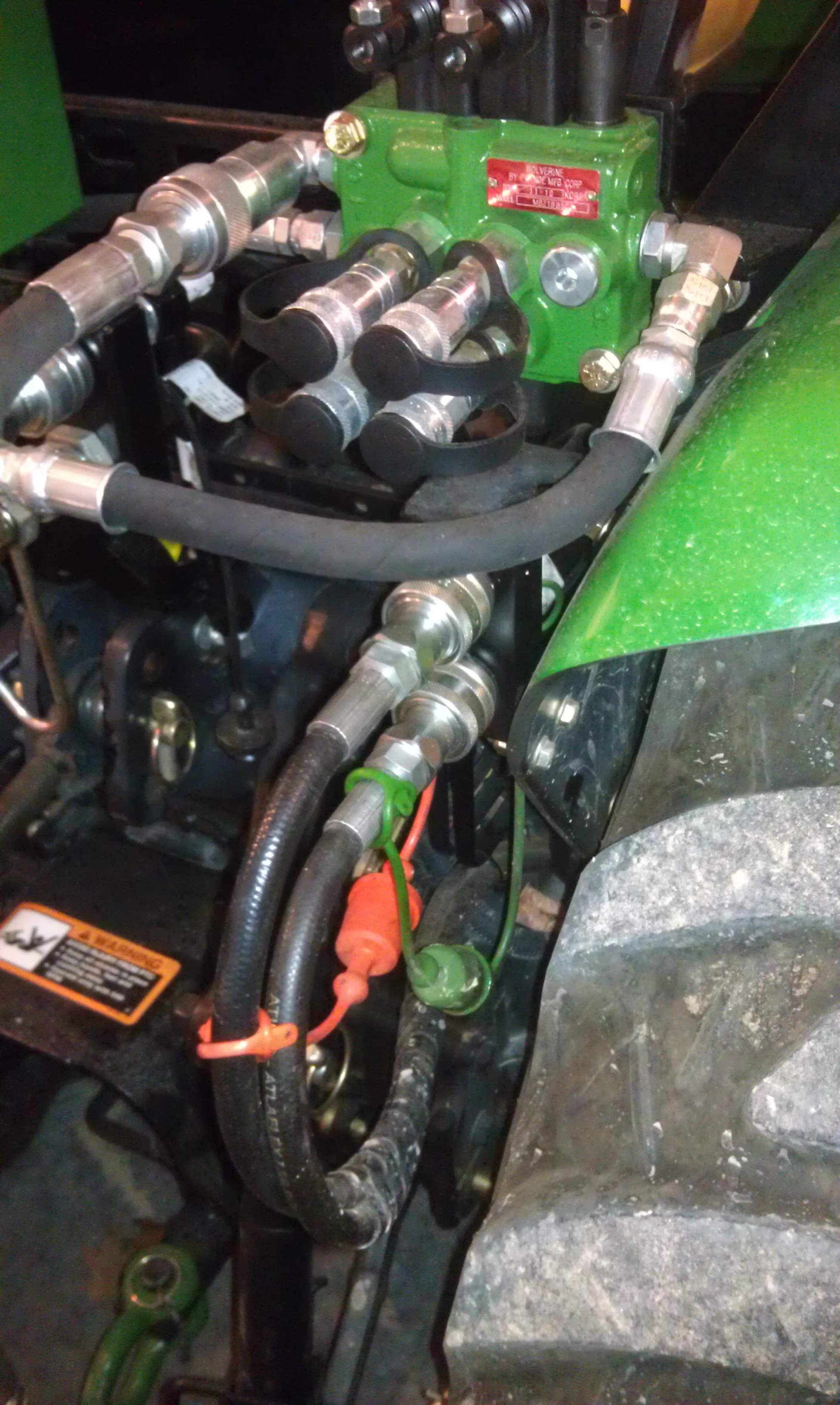

Now I am really not sure a little confused here I have the two 1/2 valves on the back and yes in the middle. Do you mean there is a hardline that might be on the loader already that I just have to buy the quick connector for or does it have to be plugged into the rear valves and rerouted to the FEL?
Now I have to really long lines plugged into the rear and I had to route them under the fender and tie them to existing factory harness/lines to run them to the front.

It is a kit made up and sold by JD. A combination of rubber and steel lines starting at your rear hyd. couplings that are controlled by the switch on the joystick. These lines run forward to the bracket that holds the four quick couplers for the loader lines. The kit comes with a new six hole bracket to replace the existing four hole bracket that is on there now. The kit also includes the steel lines that run up the right side of the loader arm right on top of the other four lines. Finally ending right by the loader cross bar with two couplings on the end of the new steel lines for running front mounted toys! I like it because half the lines stay with the loader and disconnect like the other four at the mid mount bracket.

Glen is right on the mark with his explanation on what's included with the JD kit.

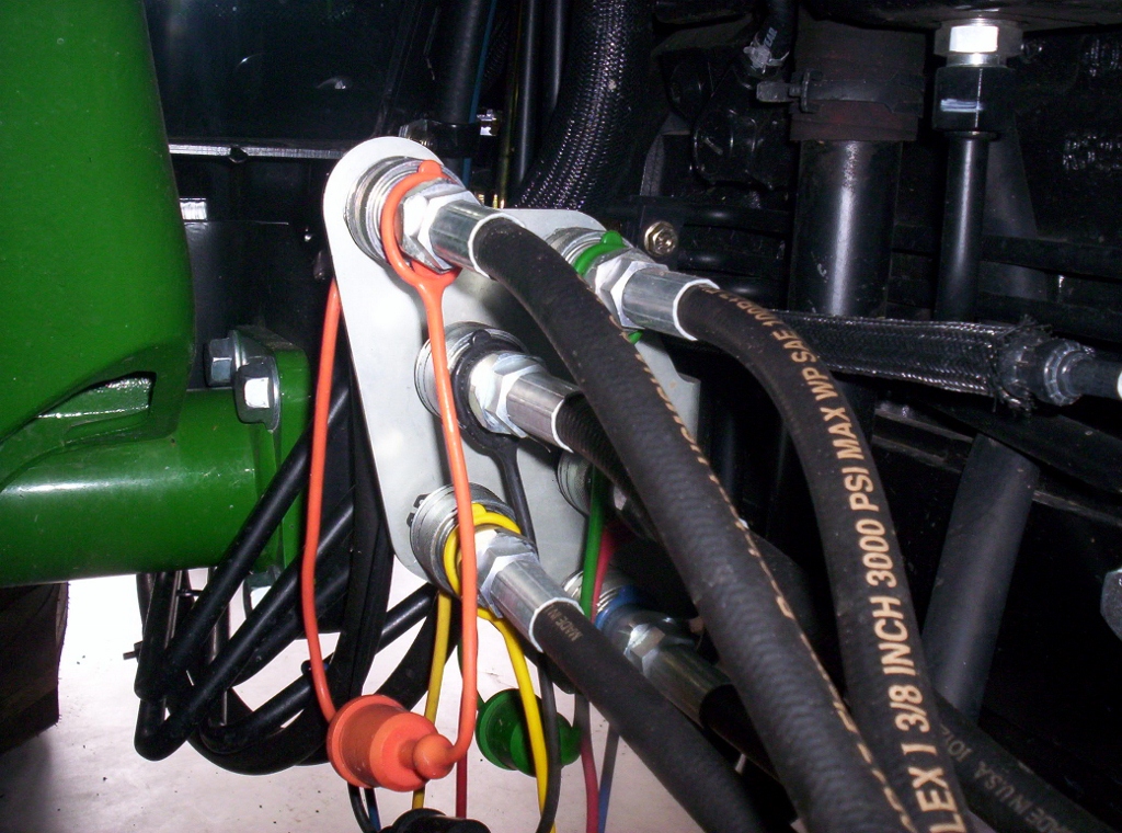

Here's a photo of the 3rd function. It's the one with the lines attached, I'm guessing this is what you have. The lines (kit) that runs from the 3rd to the loader arm is what were talking about. If it was installed you'd have the quick connects there already.

I went out and took some photos of the bracket and hardlines, I hope this helps :)
Ok I got you now so really it does the same thing I am doing with my super long lines running from the rear now but much neater and permanent. I will look into it in the future. Now have to play a little catch up on my JD account with the wheel weights and the imatch those guys nailed me good..lol
