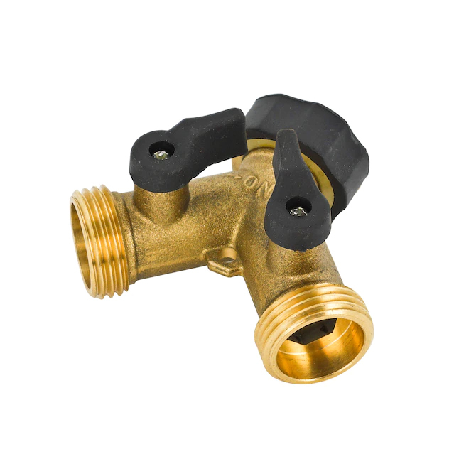

Hi all,
I just got back from Lowes where I purchased a splitter for my outdoor hose bib. The thing leaks like no tomorrow.
I hand tightened it the best I could, but it leaked. I tightened it with a wrench, and it still leaked. I replaced the gasket with a new one, and it still leaked.
I checked out the end of the bib and there seems to be no problem with that either. Seems everything I attach to it leaks.
Do you think the bib is bad, or just the stuff I am trying to connect? Any quality products for hose connections out there?
This is the leaky little gem I bought.
Thanks
Dave
   / Hose bib leaking. #2
I have several of those from both Lowes and Home Depot. I have never had any problem with them. Maybe Lowes would allow you to return it for a new one?
   / Hose bib leaking. #3
Put a nozzle on the outdoor hose bib and see if it leaks with the nozzle turned off.
   / Hose bib leaking. #4
Did it come with a washer in the faucet end? If not install one. All that stuff is 100% Chineseum today.

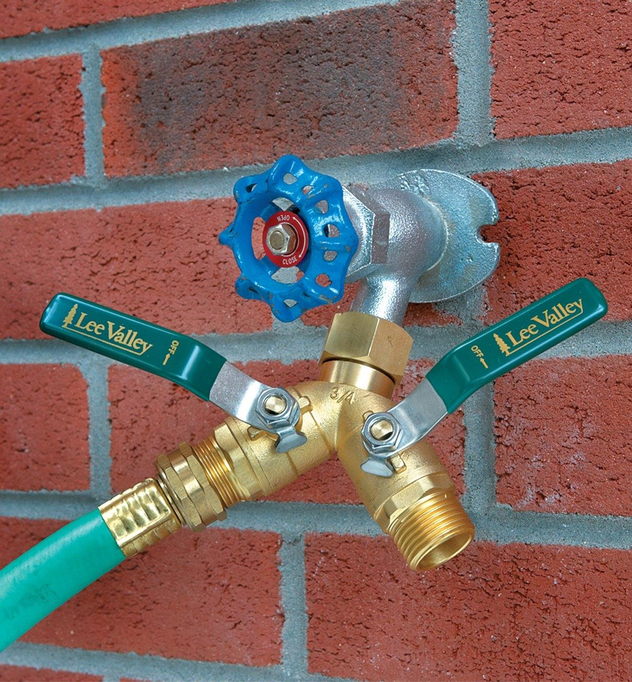

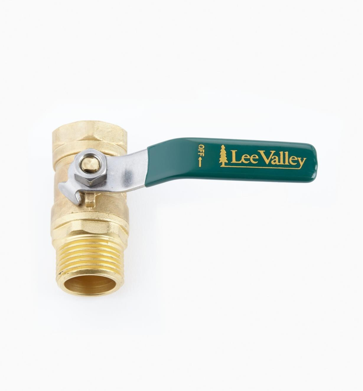

@dj1701 I have had trouble with some of the splitters that I have bought until I replaced, or added an extra, gasket. On some, the original gasket was undersized (metric?), thin, and often leaked as a result.
These days, I know what my needs are, and I have taken to plumbing in multiple 3/4" ball valves with GHT adapters on them where I need multiple flows. The splitters generally have very small diameter openings that cut into the max flow possible for me, especially as my water pressure runs around 20-25psi at the taps.
All the best,
Peter
