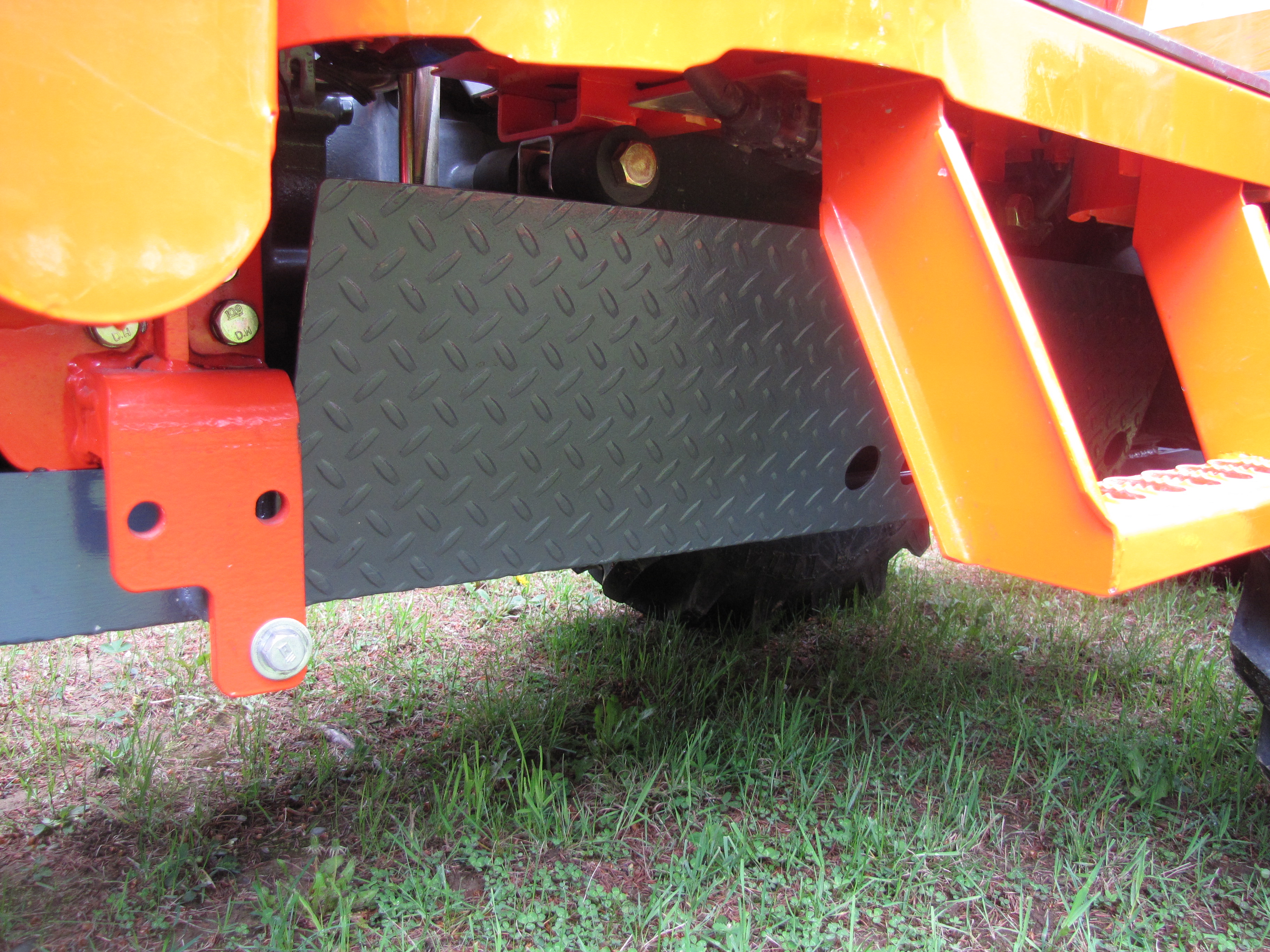

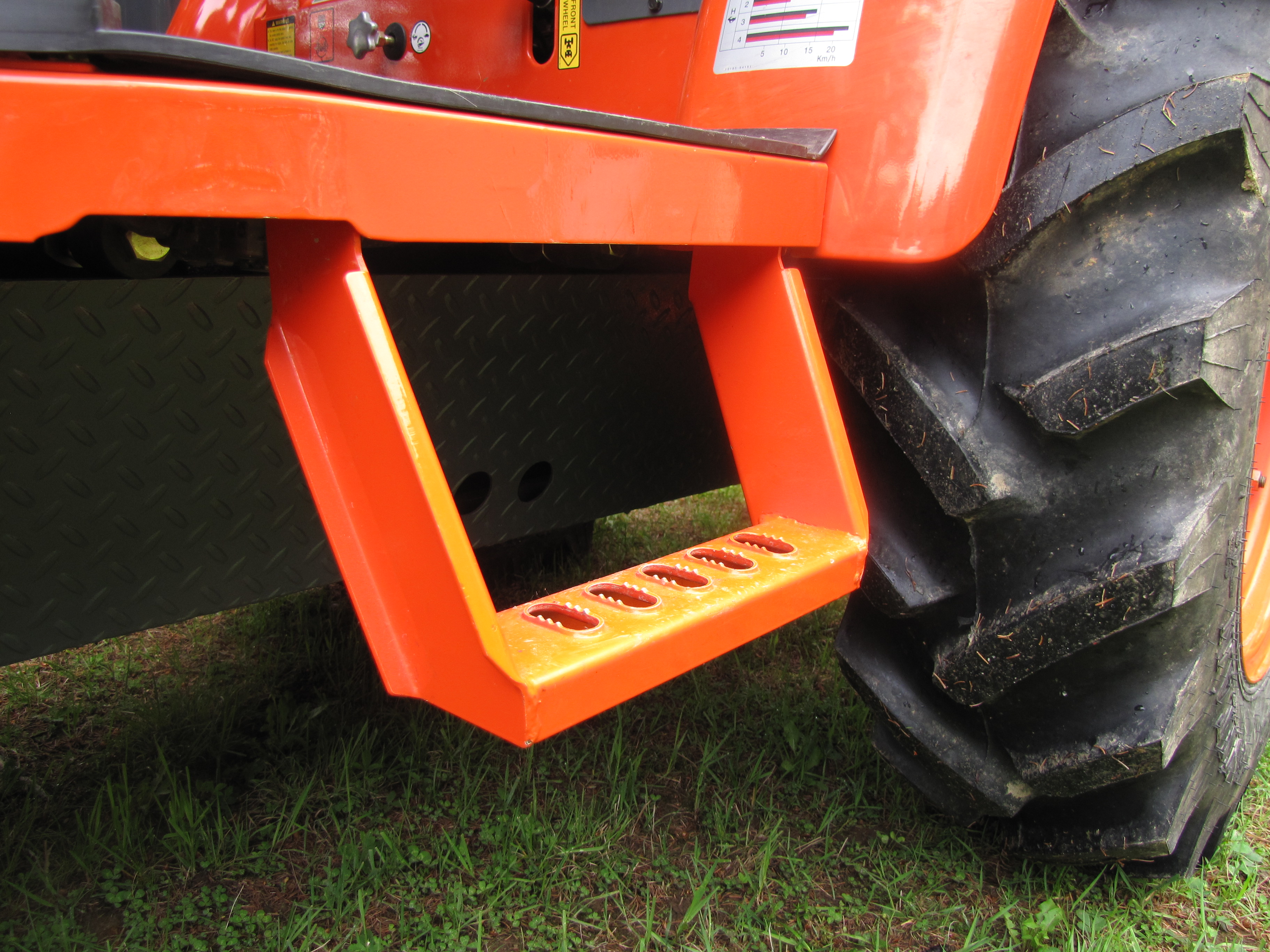

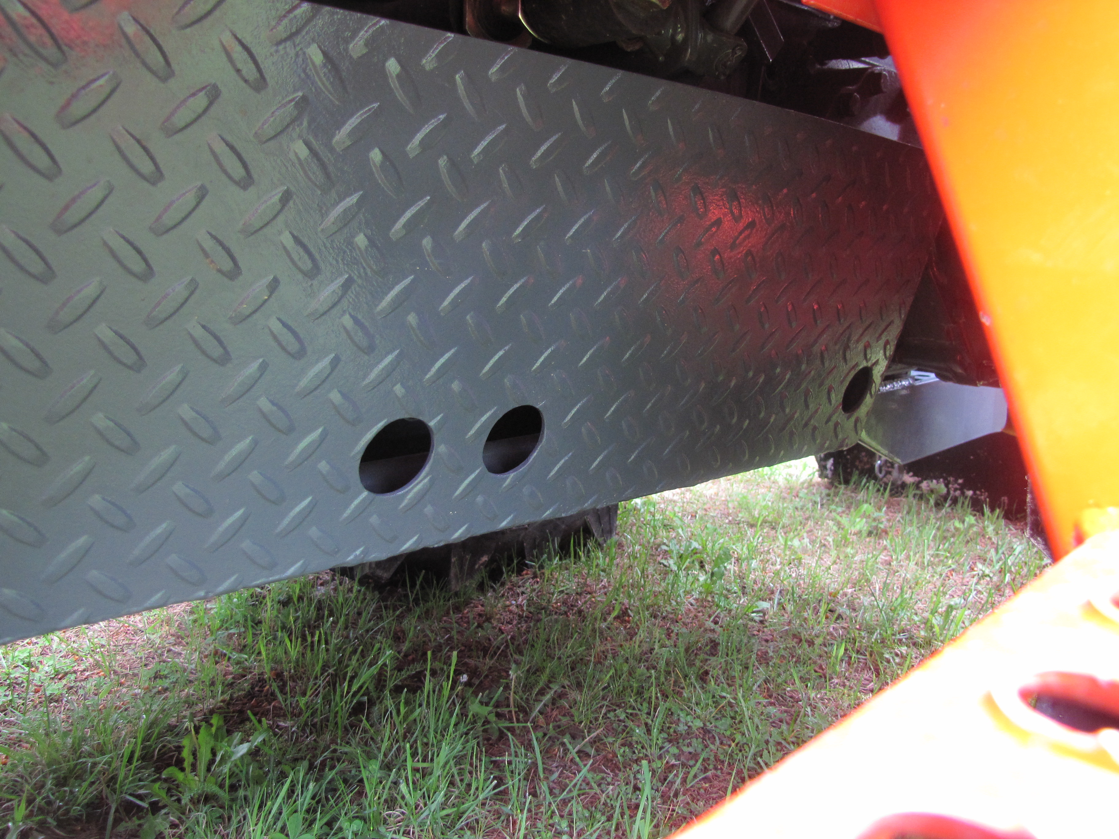

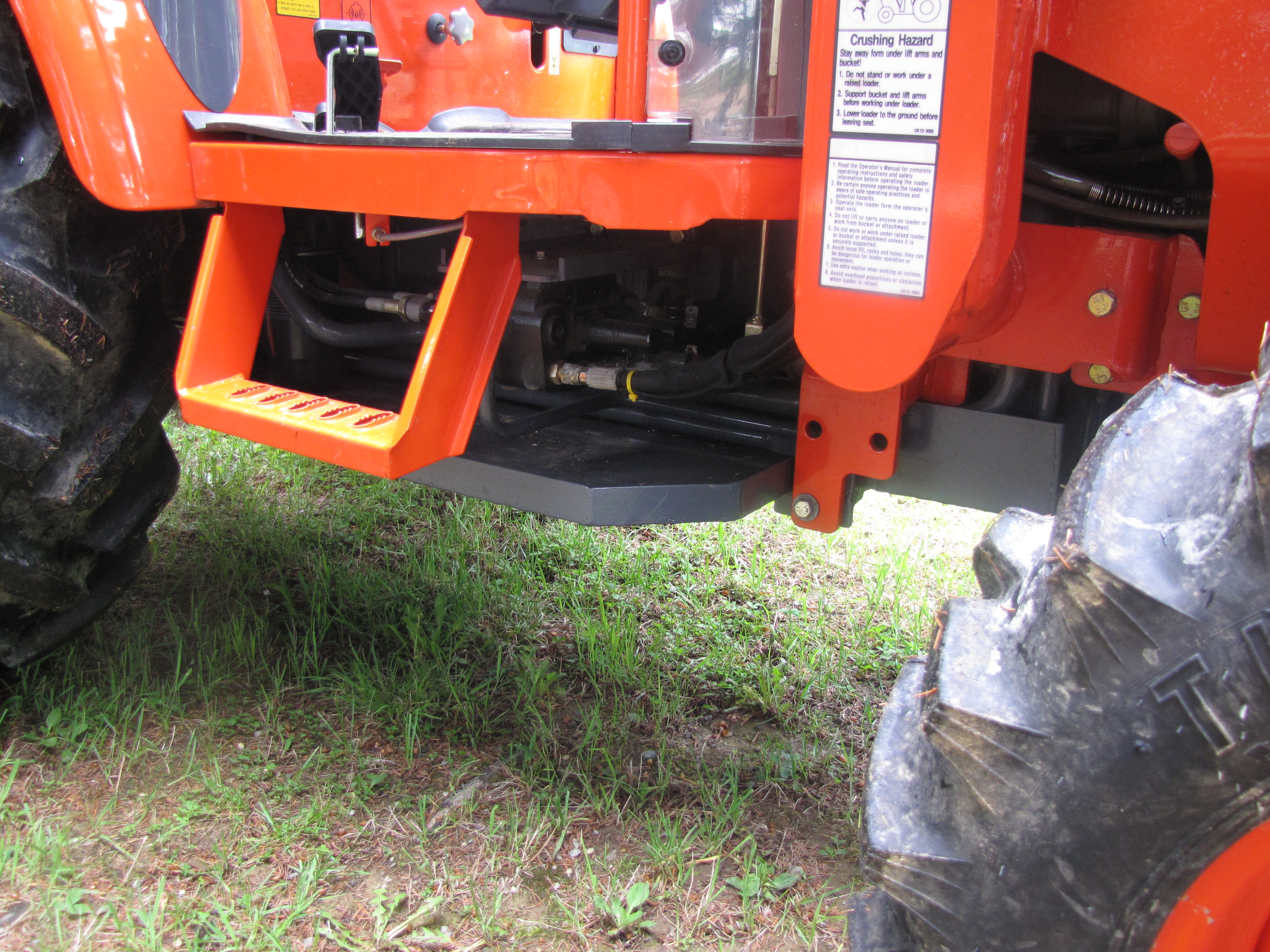

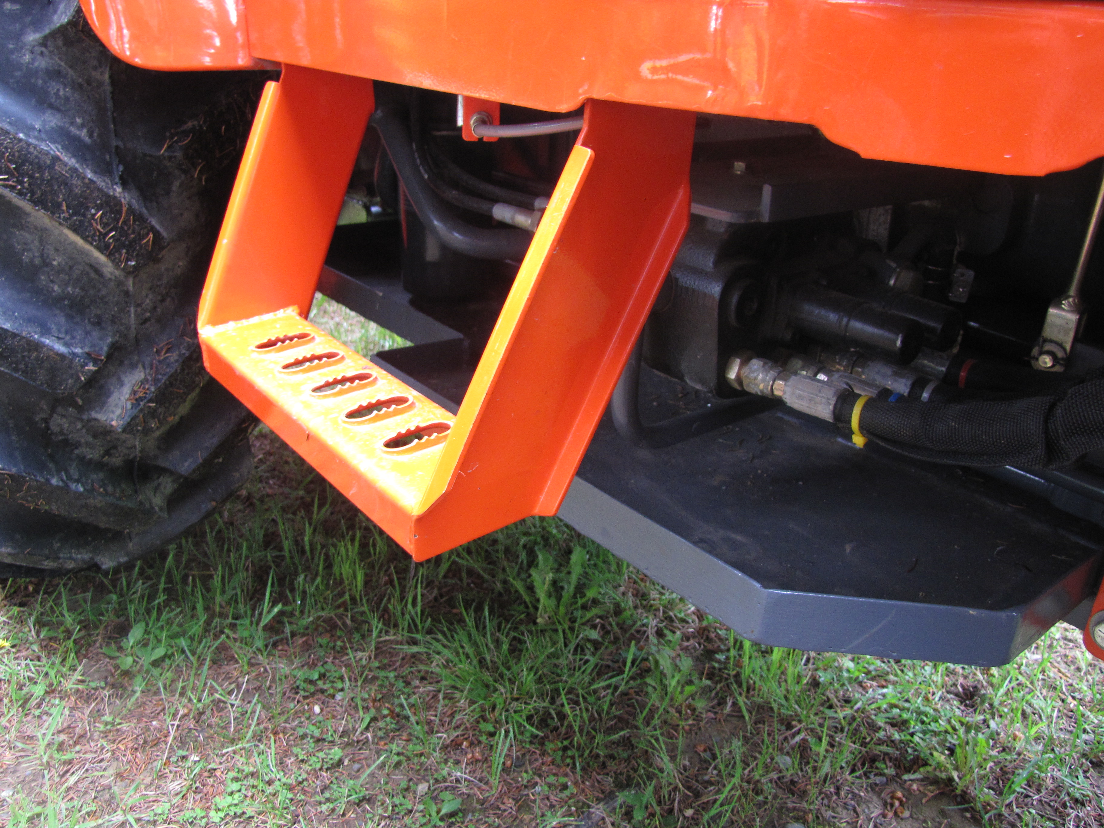

Anybody have any loader hose protector fabrication to share. I hate seeing those hoses and fittings so exposed. My father in law knocked one off one day and I've been determined to make some protector ever since. Any ideasView attachment 459165
Among the many things I fabbed up for my Kioti NX series was a loader hose loom and guard.

I like the idea of a protector over the hose, but my main concern is protecting the couplers. A stick knocked one of the couplers once and disconnected it and it has dripped a little ever since. I've disconnected and tried to clean the connections out a few times with no success, so when I finally get that leak fixed one day I'd rather keep it from happening again.
   / Hose protector
#18
I'll replace a busted hose any day, but a bent manifold and coupler would be a pain I the butt, not to mention very expensive
