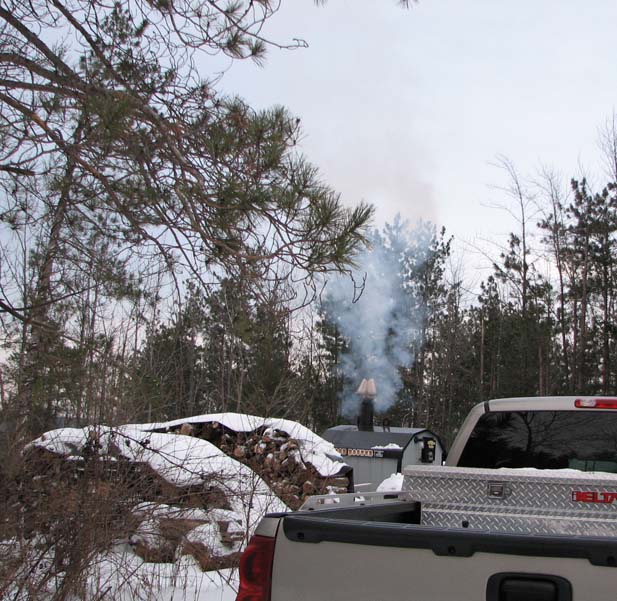

I tried to get my boiler to smoke really bad so i loaded it with pine and turned the power off to it for 5 hours (no fan - left smoldering). Then i turned the electric back on and this is what i got.
It is an amazingly small amount of smoke for what i did to it but i definitely consider that VERY smokey for my boiler. But I have boilers i see on the way to work that have never burned that clean and their smoke is dark gray to black. If the towns just said that the boiler has to conform to EPA regulations just like indoor wood stoves, then they would be reasonable regulations. In my town, i could not install one now. Normally, no smoke comes out of the boiler when the fan is running, a slight very light gray wisp of steam/smoke when it is not. My neighbors indoor wood stoves smoke more than my boiler.
Just like everything else, there are good ones and bad ones. How you run it makes a difference too but this one is pretty hard to abuse too much. I suppose if i started burning tires in it, etc. there might be some problems. Cardboard causes smoke - i think it burns so easily that not enough oxygen can get it for a complete burn.

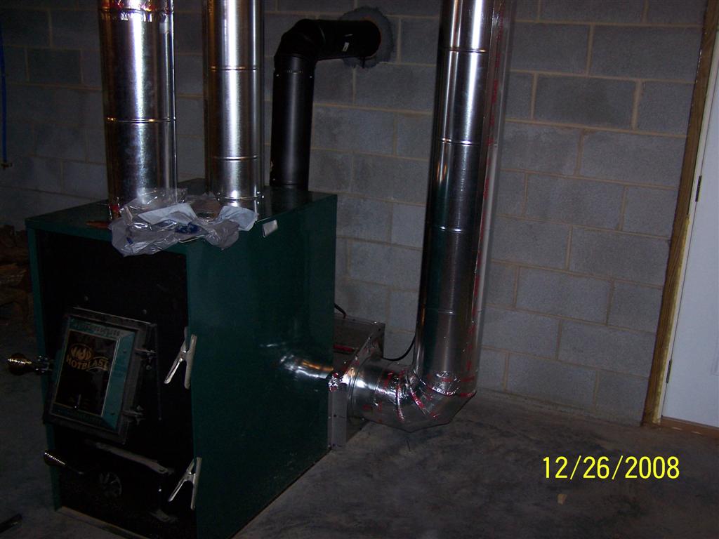

I have the 1537G from US Stove. I bought it last year but we moved into our new house in mid March so I did not have the time to hook into the duct system. We were able to get everything hooked up the week before Thanksgiving this year and it works great. I have 2, 8" pipe out of the top of the wood furnace tied into my duct system with a damper. I also put a "T" section on the pipe comming out of the top of the furnace incase it gets to hot upstairs I can open the "T" and let most of the heat flow into the basement. We also have the fans in the back of the wood furnace enclosed and duct work ran to one of the returns upstairs. My house is 2000 sq ft upstairs and 2000 sq ft of unfinished basement. I am still learning how to regulate the furnace as to how much wood to put in and where to set the stove damper. But I can easily maintain 73* upstairs. But if I'm not carefull it can get 76-77 degrees upstairs very easily. I end up opening the door to the garage and heating it to cool the house down.
I can put 3 good size logs in around 10:00-10:30pm and have coals the next morning at 5:30 with the temp being 70 degrees in the house. I have not loaded it to the max or any where close, since I don't want the house that hot at night. So far this wood furnace works great. Because of the way it is enclosed it does not put off a lot of heat around it. I can put my hand anywhere on the top and sides and it is warm. The only place on the stove that gets hot is the door and near the flue in the back.
My in-laws have a wood stove, my parents had a fireplace insert, both heated well but was hard to regulate and heat the house evenly. The wood furnace does great. It does not blow with the force of the heat pump but you can feel the flow of air.
I can take some pics and post my set-up if anyone is interested.
David
Heres the pics.
