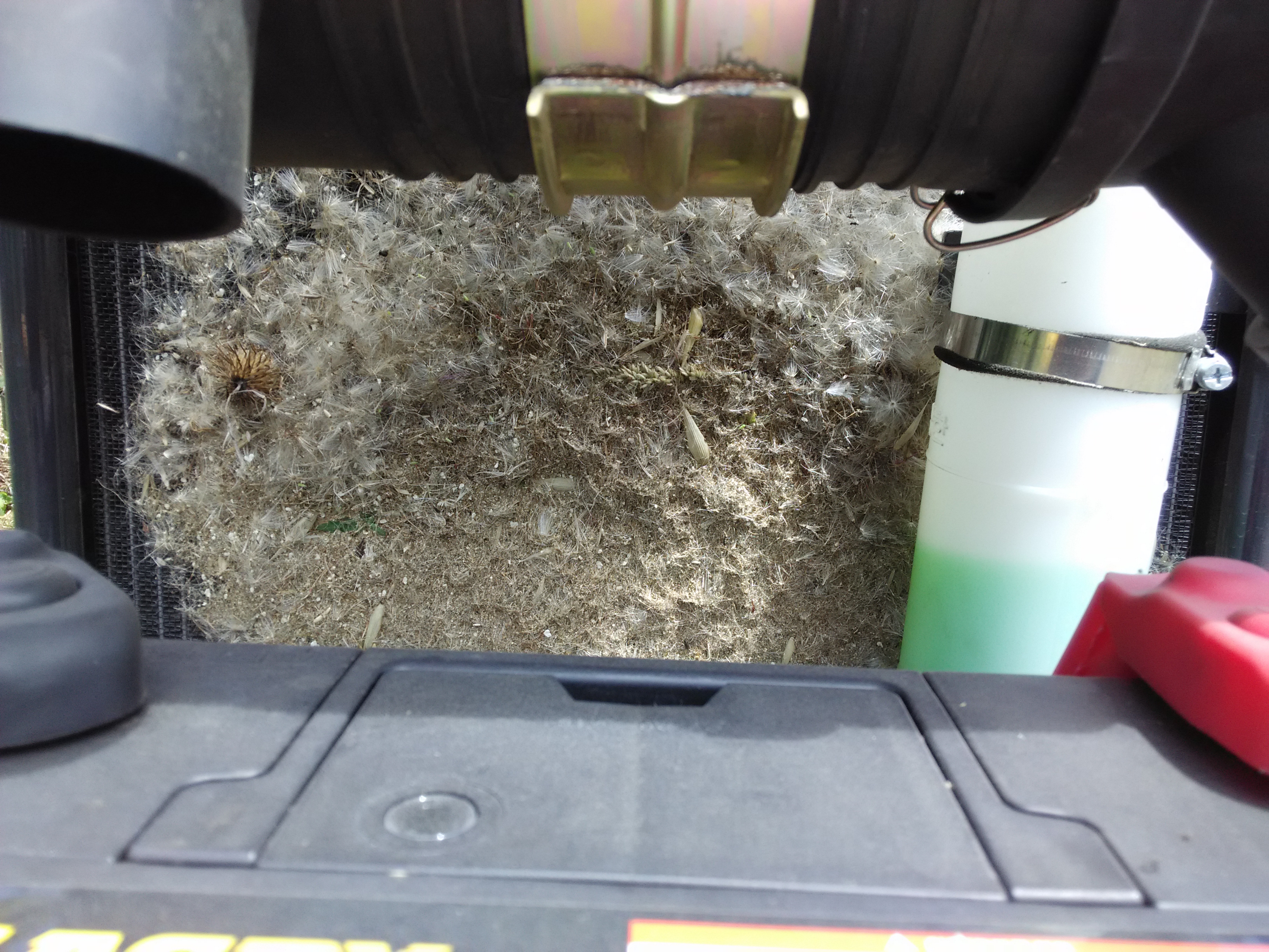

Mowing the right stuff and it doesn't take long to get the radiator plugged with chaff and dirt.
This is my tractor after a 100 ft pass when mowing some tall brush, grass and all kinds of stuff. I felt my legs getting hotter and hotter, so definitely something was heating too much.
Wow. That's a lot of stuff.

I wonder if it's just because many of these tractors sit so low or if that low exhaust is agitating all the crap and blowing it up where the fan is going to pull it in.
   / Hot Hoggin', or "i think i killed the tractor!" #20
I think the exhaust tip pointing down and forward does make it worse. I wish I had a vertical stack like you do on your 8050 Lou. I also think that the tighter fins per inch and row spacing on these newer aluminum coolers and radiators also makes it worse. I just wish it was easier to blow all the chaff clear. With the AC heat exchanger and the hydro cooler both sitting in front of the radiator, it makes it harder to get the radiator blown clear. The air cleaner assembly sitting over the top of the radiator doesn't help either.
And yeah, wow ptsg, that's a lot of chaff for only 1 pass of 100' length.
