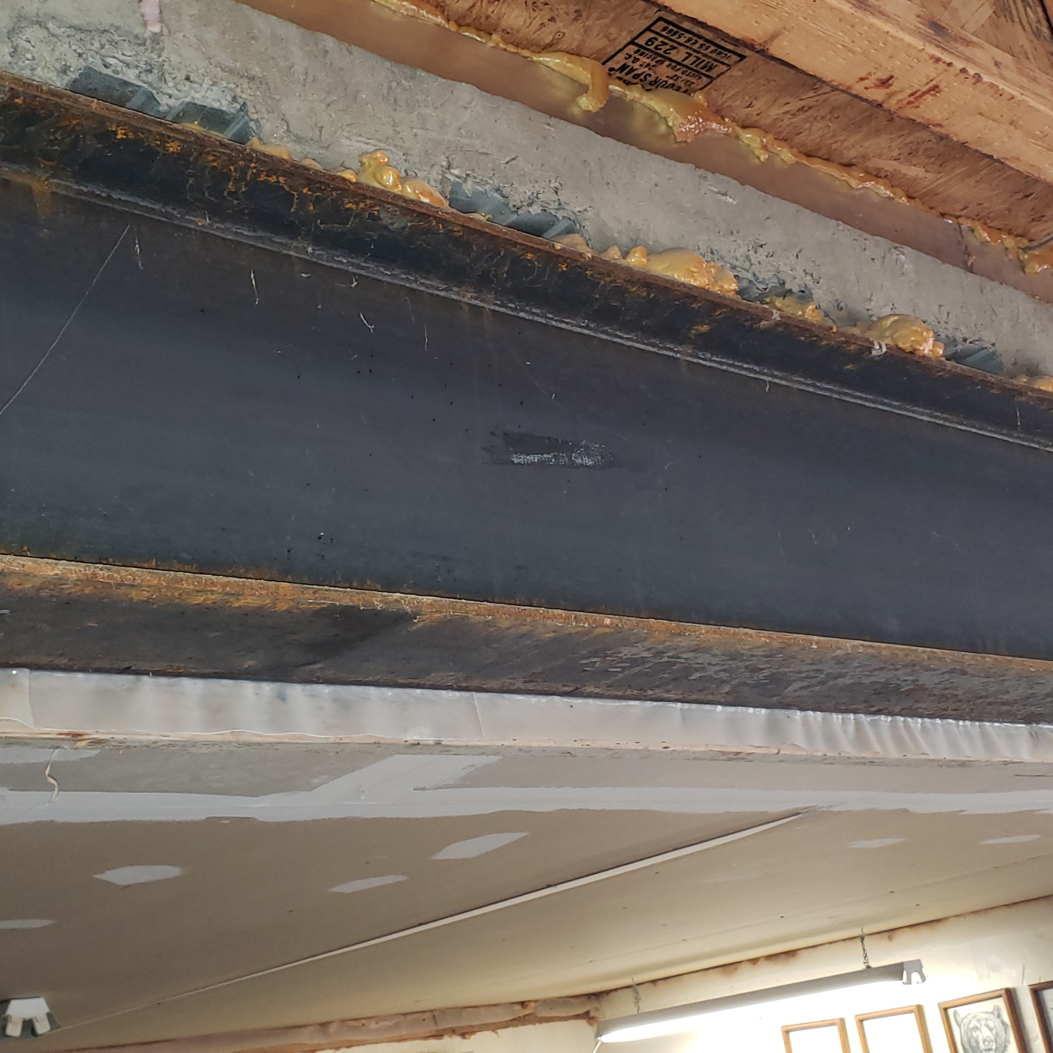

Looking at a 6-8 person hot tub and a potential placement on our front porch. The total weight with water and people is in the roughly 5K lb range. The porch is an elevated concrete over corrugated steel and spans about 12' out from the house. The side of the slab where it adjoins to the house is sitting on a 12" (1/2") I beam. The slab is roughly 6" thick and the steel webbing height is in the 2 1/2" range. Everyone has said this place is built like a brick shiznit house, but I don't want the hot tub in my basement either and don't have the construction or engineering background to know for sure. I feel like it would be ok..... but there are smarter people on here. Good idea or bad idea?

Obviously the correct answer is consult an engineer but given the size of that beam, the slab thickness and the fairly large footprint of the hot tube it will be fine IMO. Do you know how much rebar is in the slab?
   / Hot Tub vs. Concrete over Corrugated
I do not know, but when the original owner/builder met with me after purchasing he said the house itself is rated to be hit by a Cessna-sized plane given the amount of rebar in the exterior walls (poured/insulated/rebar). Even if that is tongue in cheek, I would assume he didn't skimp on the porch. It is hard to get answers because most of the people that look at the house just shake their head and wonder what the guy was thinking. I know that isn't an accurate answer. Prior owner was an engineer by the way.
What is the span of the steel beam
is steel beam also supporting your walls and house floor
