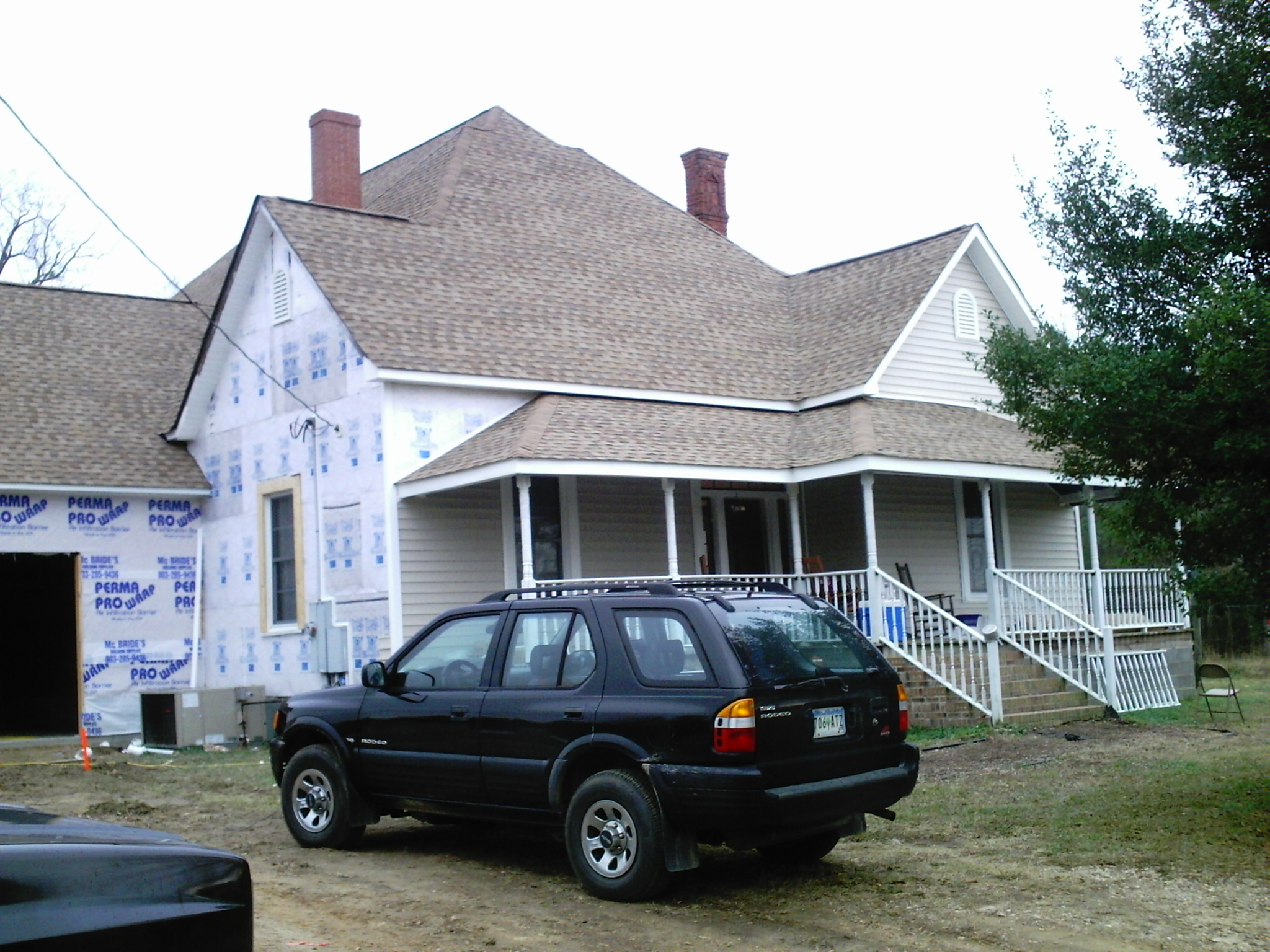

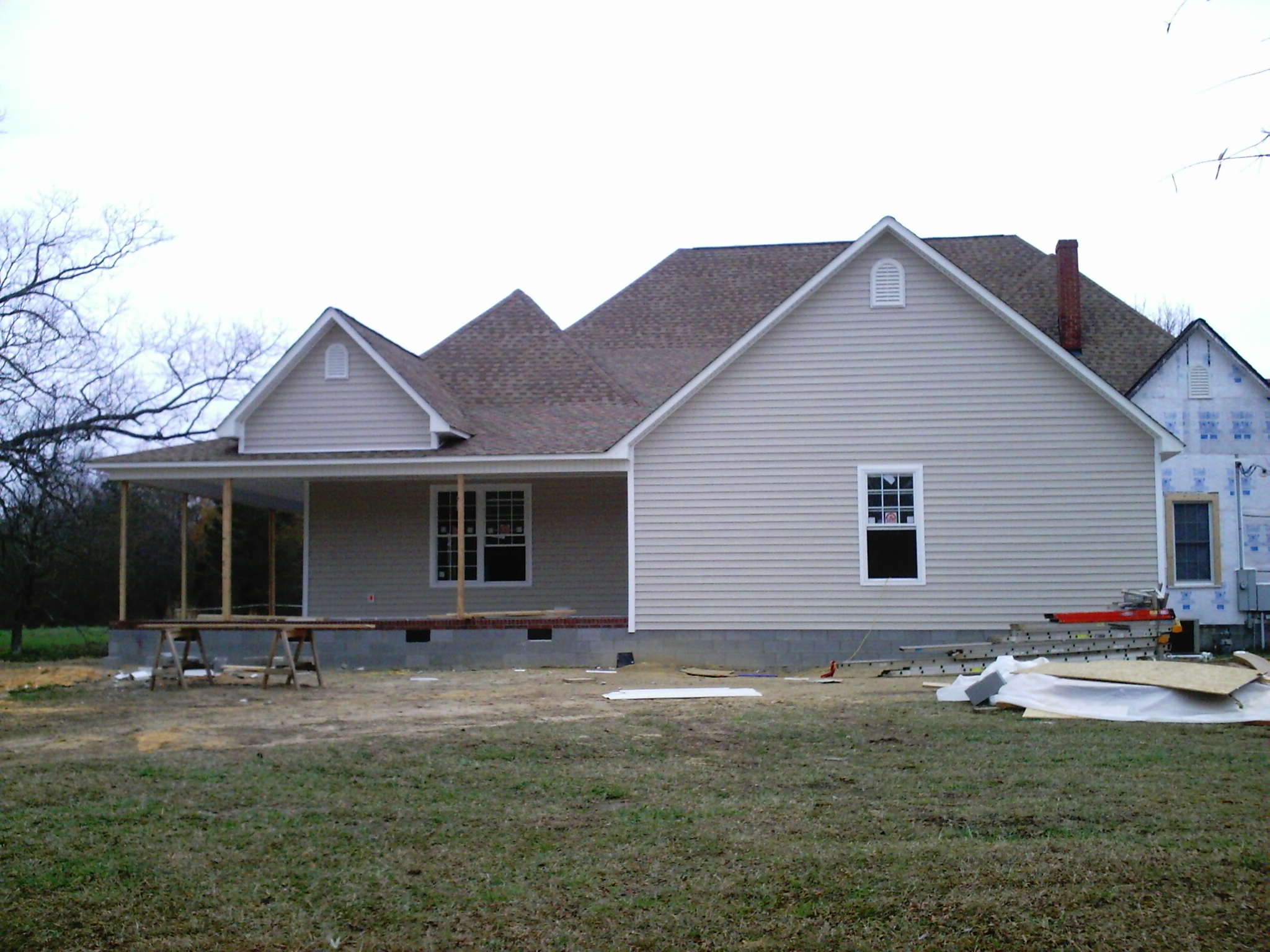

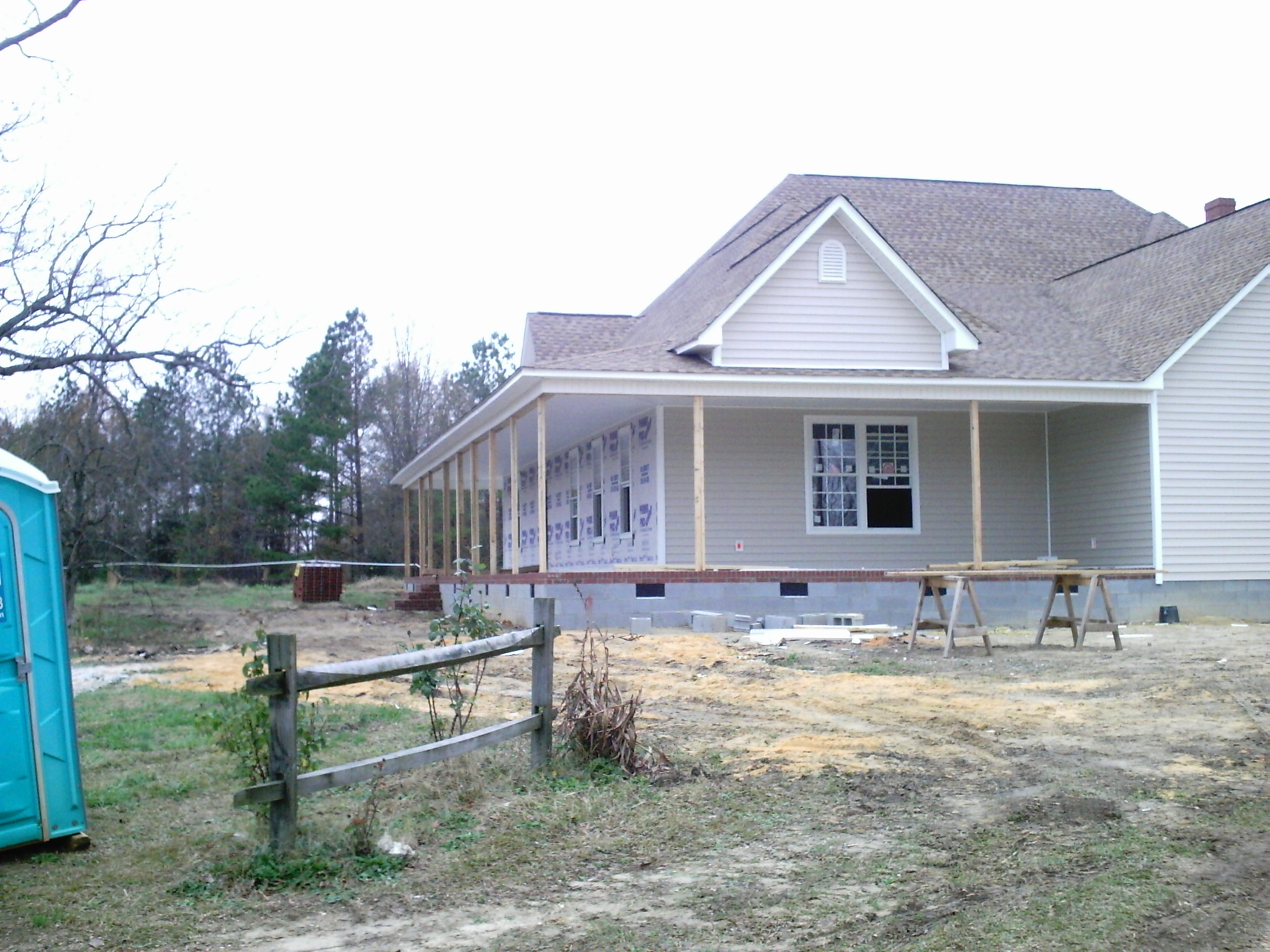

thanks guys for the advice and interest in my project i will be roughing in the
water heater this weekend here are some more pics they are few months old i will try to take some this weekend
