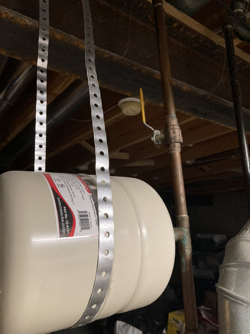

The original expansion tank on our house water heater started to deform and hang down from its own weight. Another plumber installed a smaller expansion tank and added a support.
The smallest tanks I'm seeing are 2 gallons, and I'm guessing that's the appropriate size.
   / Hot water heater leaking at relief valve #15
The simplest thing would be to go to a store like Lowes or Home Depot and buy a book on home plumbing. An expansion tank should be full of air. I can see why the one in the picture got heavy, because laying it on its side let half of it fill up with water. Maybe there's a diaphragm inside that prevents that? I don't know.
Location is not critical as long as there's no valve between the expansion tank and the water heater. If you close the valve and isolate the heater from the expansion tank, the water expands and pop goes the PRV.

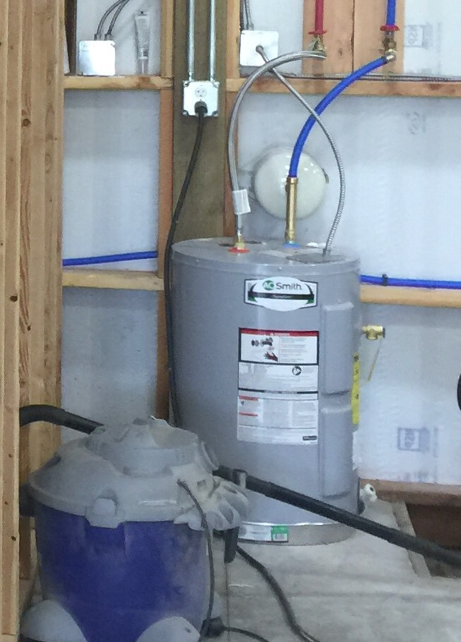

Here’s a very simple, per code, expansion tank install in my shop.
