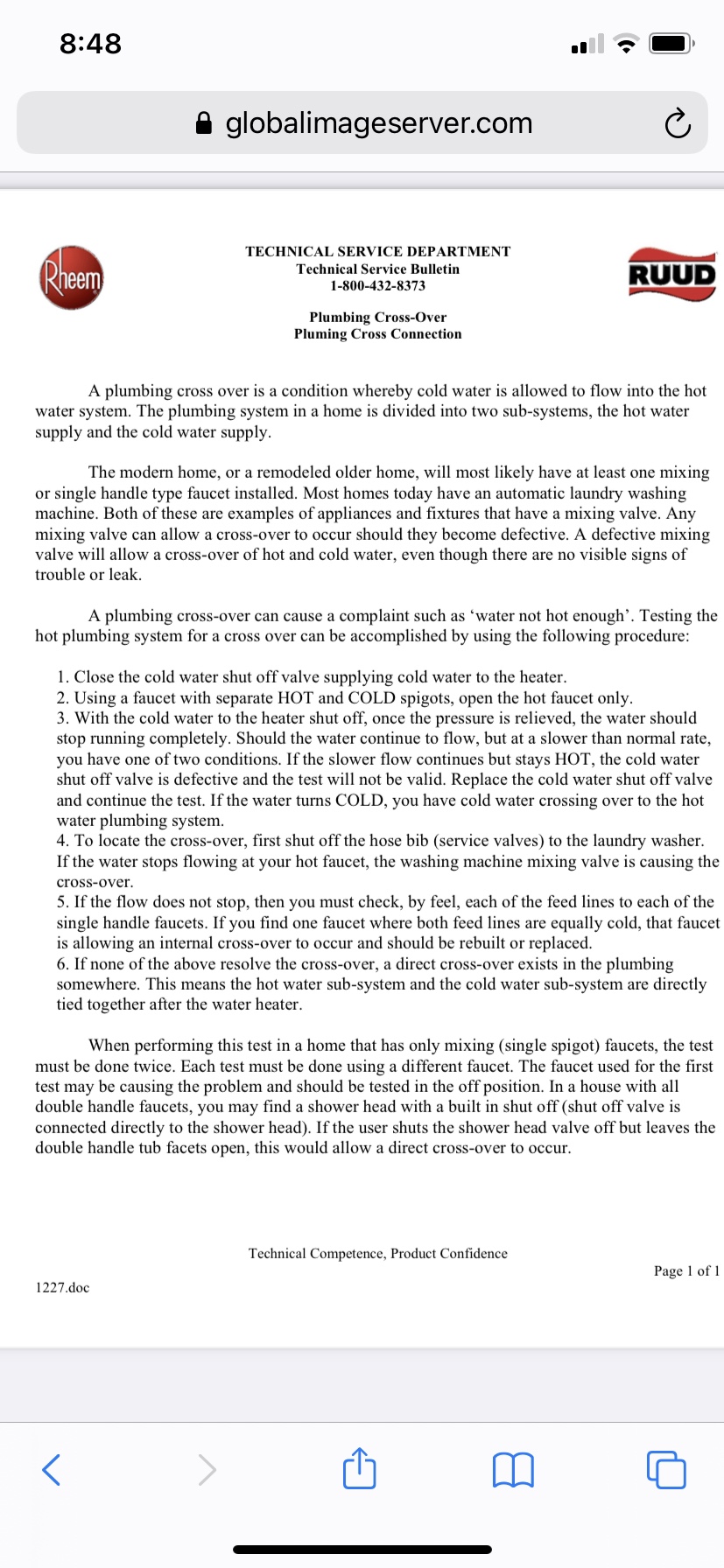

Is it possible that a 3 point cartridge could fail internally to allow this to happen?
Which cartridge.....I have 3 of them.
If one cartridge failed internally, would it affect the supply to the hot side of the other two?
Could a failed toilet mix valve be the problem?
This is all not good!

I believe that is possible. Perhaps the information below will be helpful.
MoKelly
