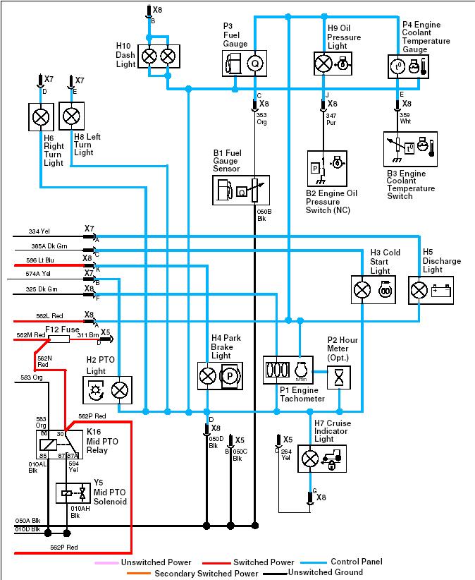

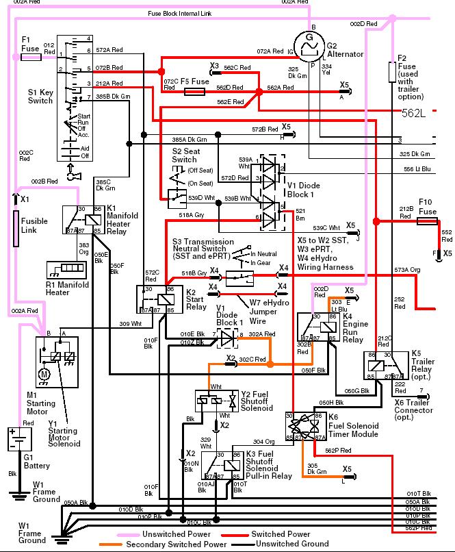

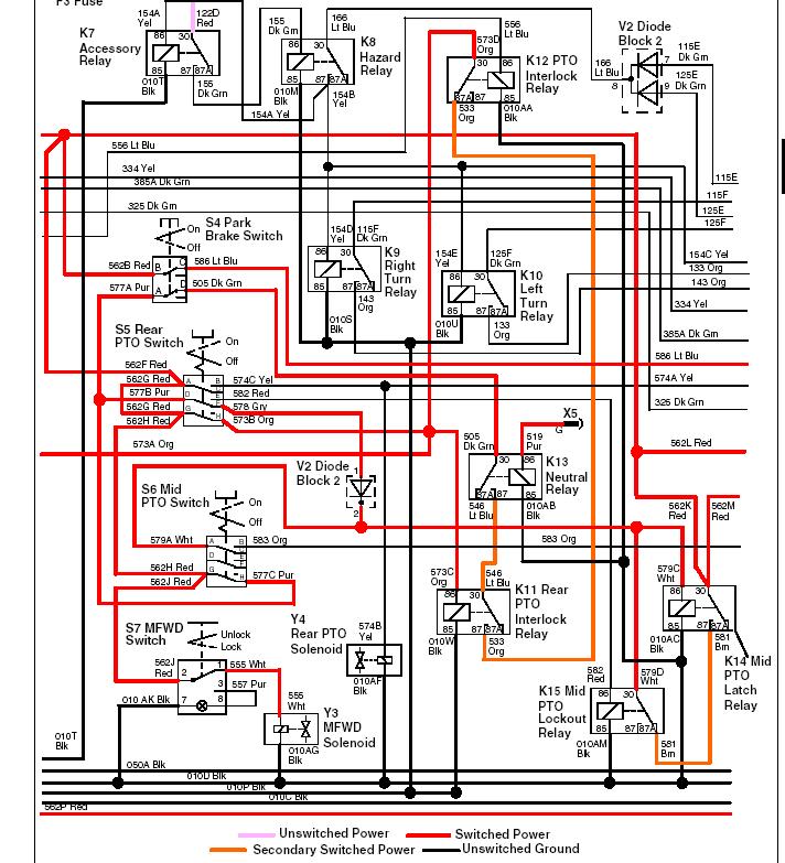

I need to find the wiring diagram for the ignition switch on a John Deere 4310.
The hour meter died and I am installing an industrial meter.

Here is the wiring schematic for the 4310. First panel shows the key switch on the upper left, then the red line on the right marked 562L lines up with the red line in the center panel that follows across to the right side where it is marked 562L.
The third panel picks up that red line 562L and takes it into the control panel (light blue lines) at X8 connector. Holler if this doesn't work for you. Not sure I can help more, but willing to try.
