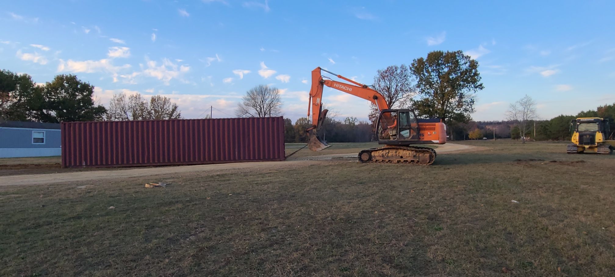

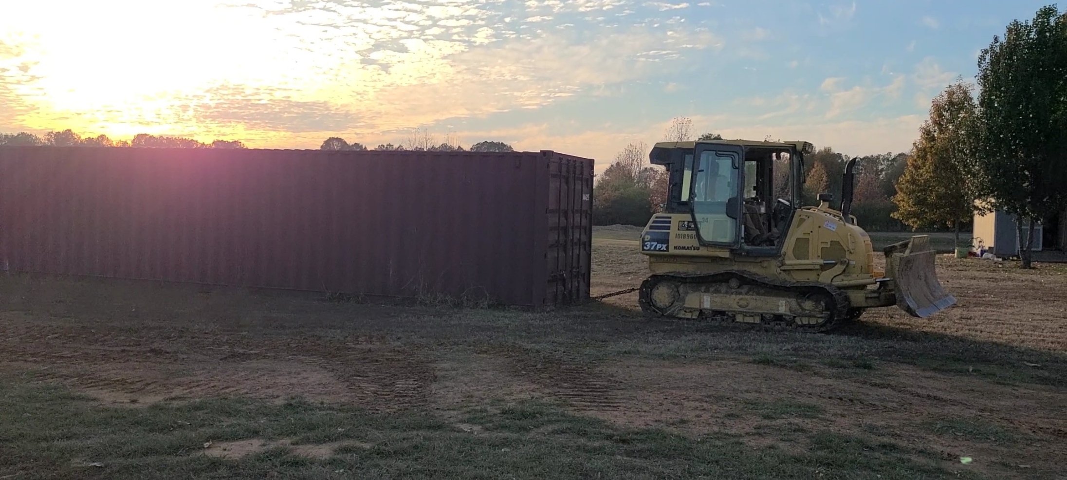

I moved the conex out from what will be the front yard. I expect the equipment to leave any day so I moved it loaded.... Was a non issue with either piece of equipment. I started with the dozer but the nose of the box was digging and I didn't want to mess up the driveway any more than necessary. So I switched to the track hoe and kept the front lifted just enough to clear the driveway. It was not as smooth as the dozer but it did lots less damage to the yard that way. Ended up pulling it a couple hundred yards off to the side of the property behind my pole barn.

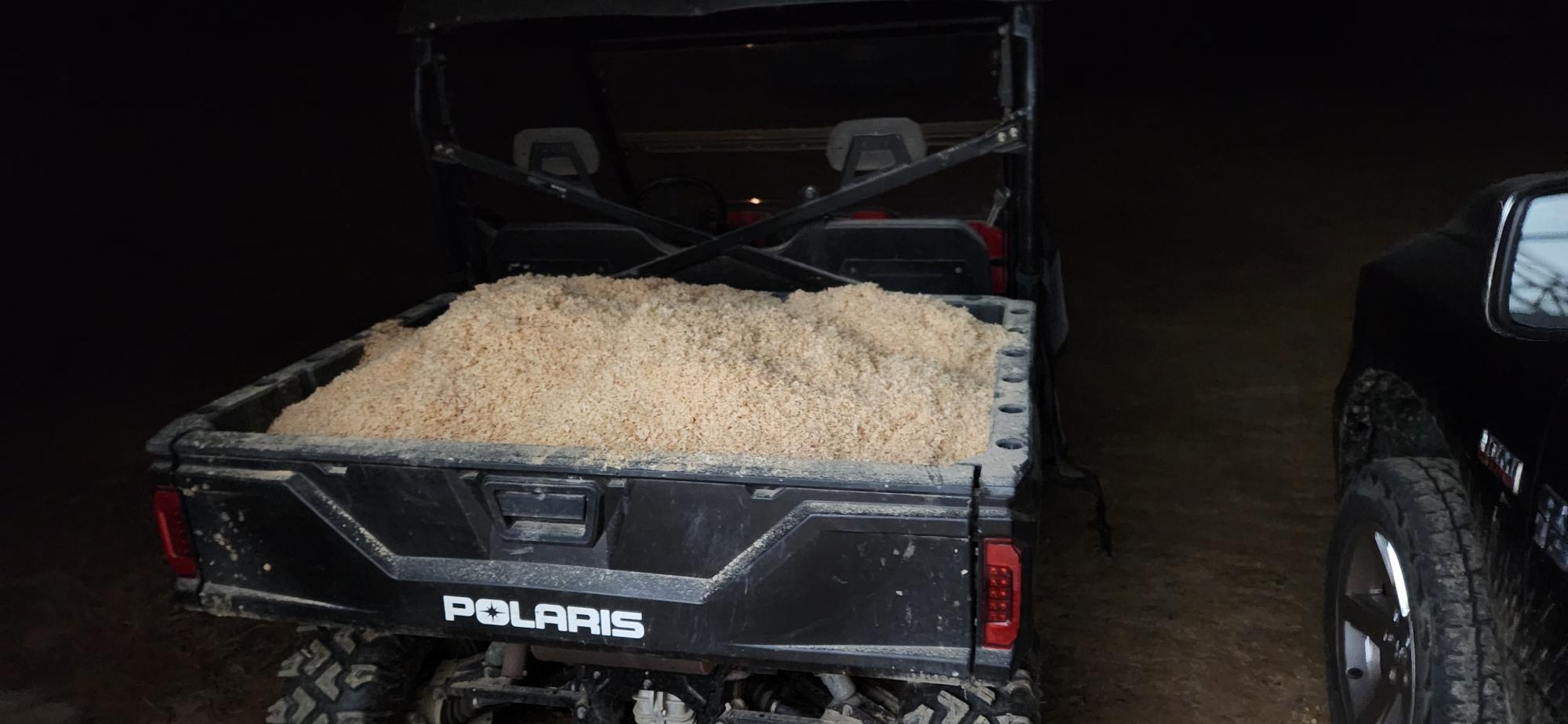

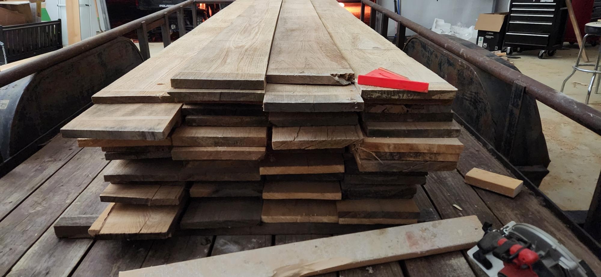

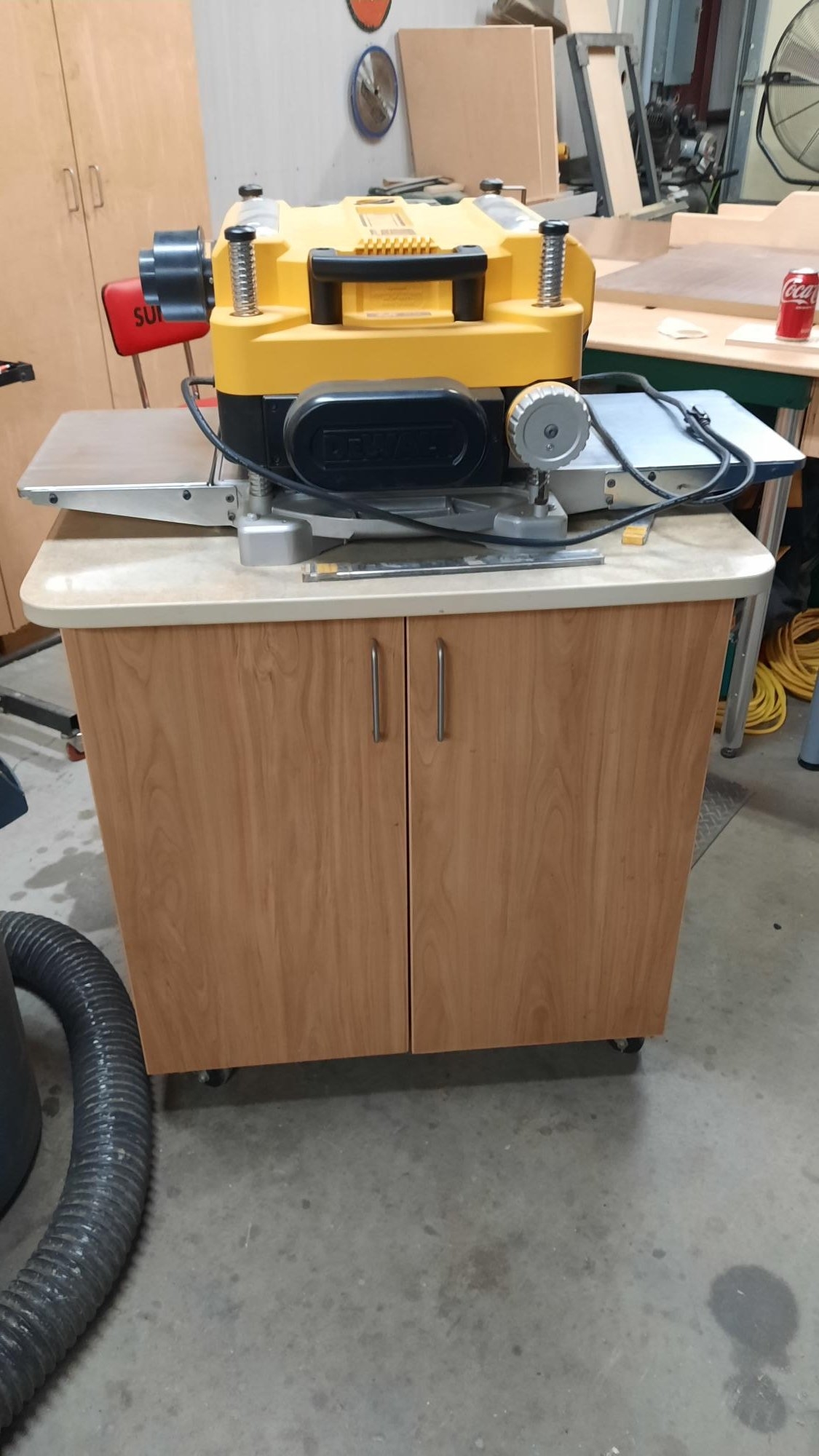

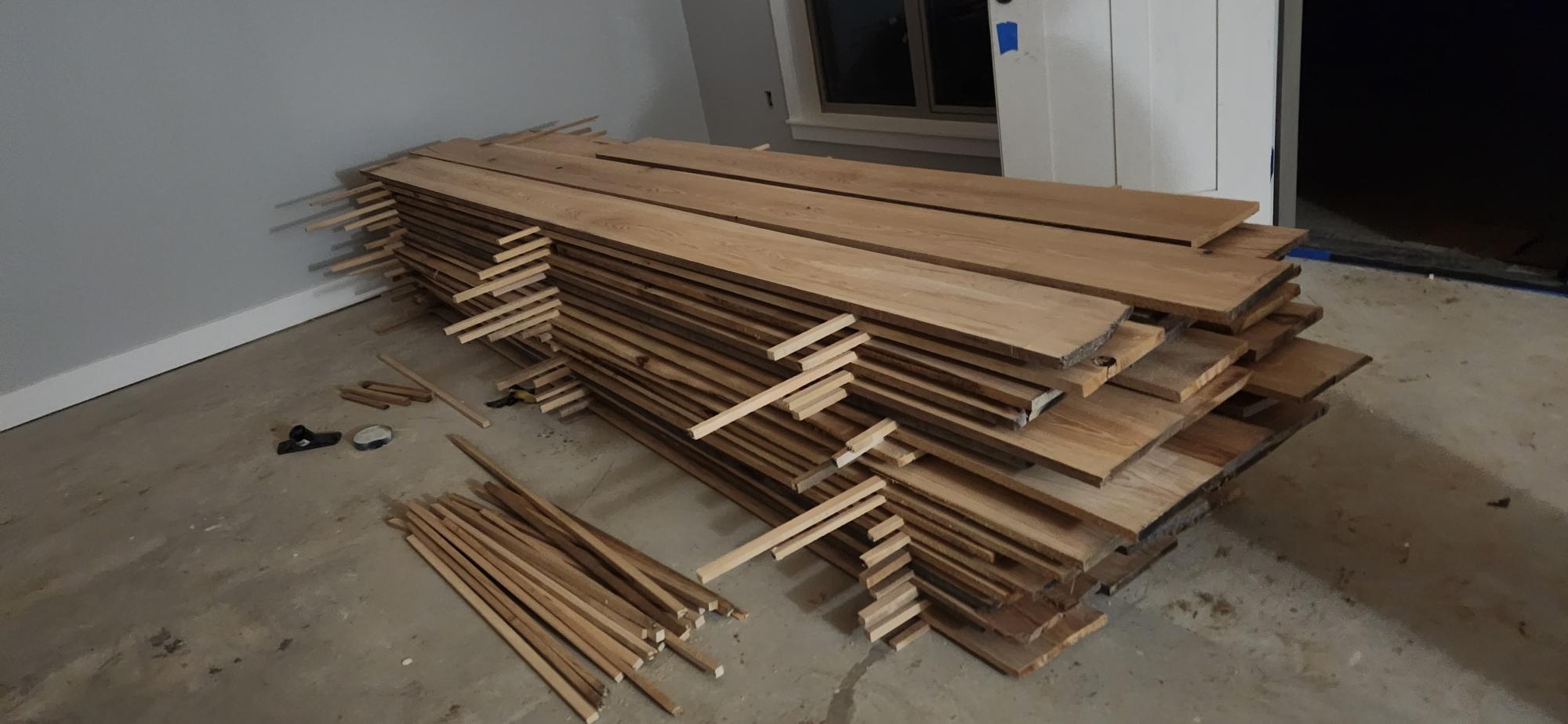

One of the many ways I've tried to save money on this project is with the stain grade wood we are using for accents. We have some exterior features, posts and decorative trusses. We also have some decorative trusses inside and a couple faux beams. I found a sawmill that cuts a lot of cypress. I got 10x10 posts for the columns in the front of the house and 1x10 for everything else, the rest will basically be wrapped or just hollow boxes. The exterior stuff I left rough cut, but we wanted a little fancier look on the inside, so I got me a planer and started plaining down the 1x10's. That is a lot more work than I was expecting.

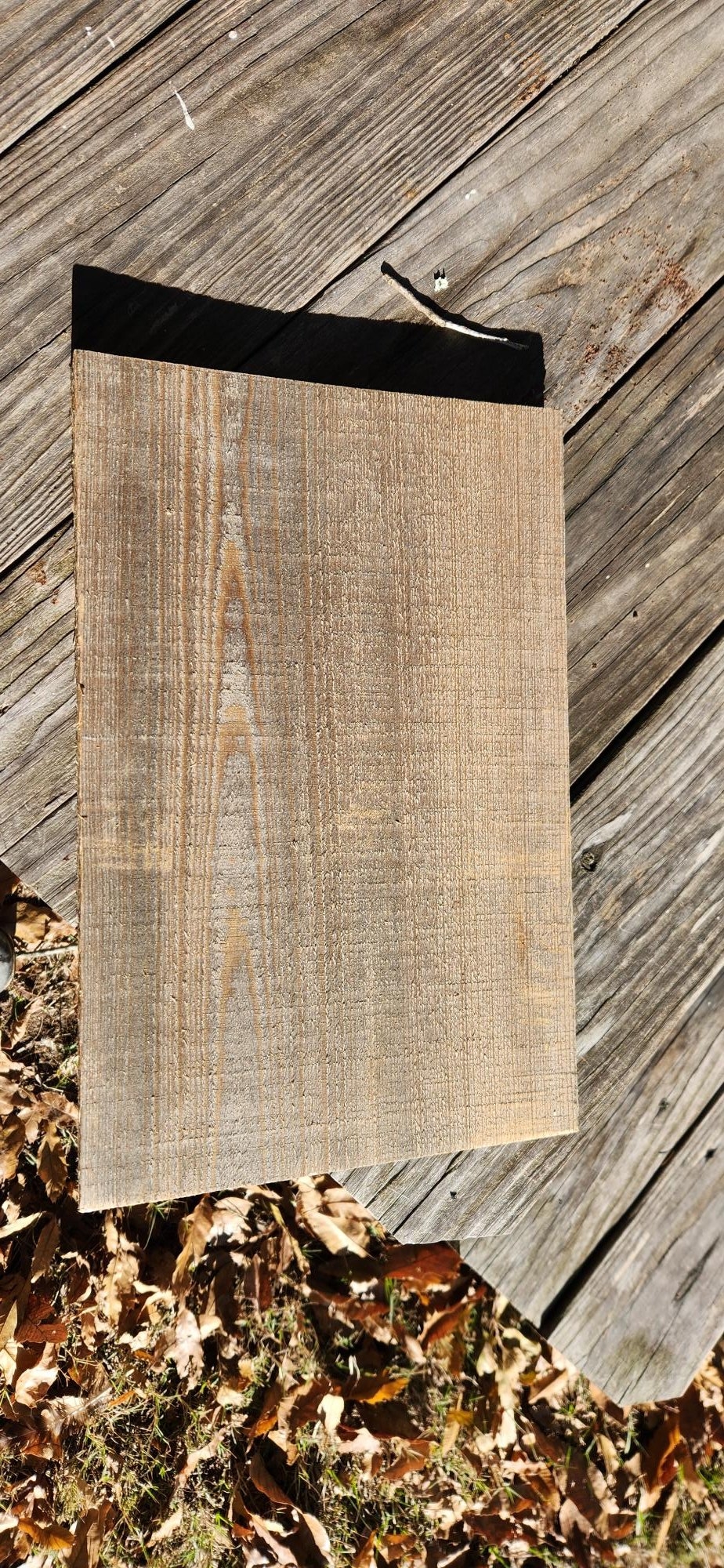

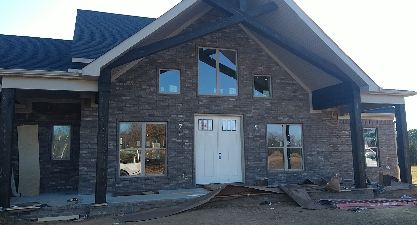

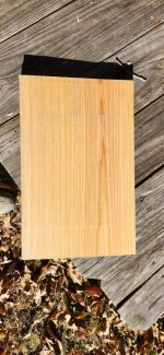

I'm not sure we picked the right stain.... We had initially planned for black siding and soffits. But, it was about $5,000 more so we changed to clay. I'm not sure how I feel about the really dark stain next to the clay... I'm hoping it grows on us. I can't exactly stain it lighter.

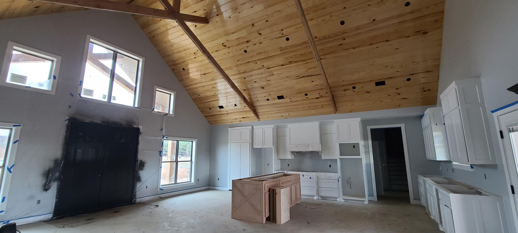

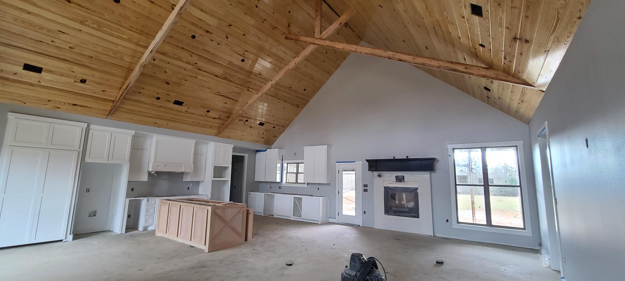

The interior is looking better and better. The decorative trusses will be wrapped with the plained cypress from one of the posts above. Those, the island, and a decorative wrap around the vent hood area will all be stained the same color as the outside wood. The island is turned 90 degrees from how it will be. The painters spun it to get it out of the way.

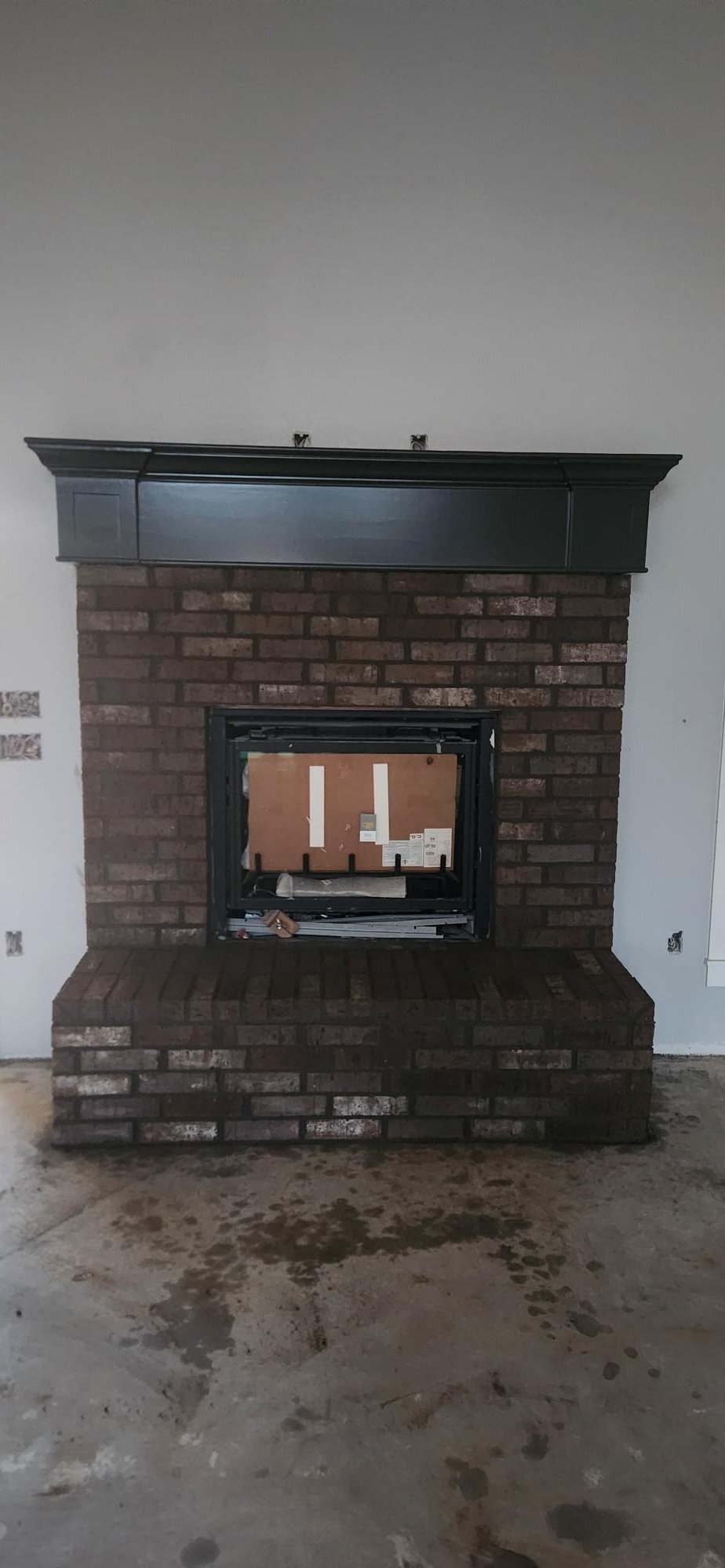

The fireplace got bricked yesterday and we got enough material plained that the trim guys should be able to finish their part up.
