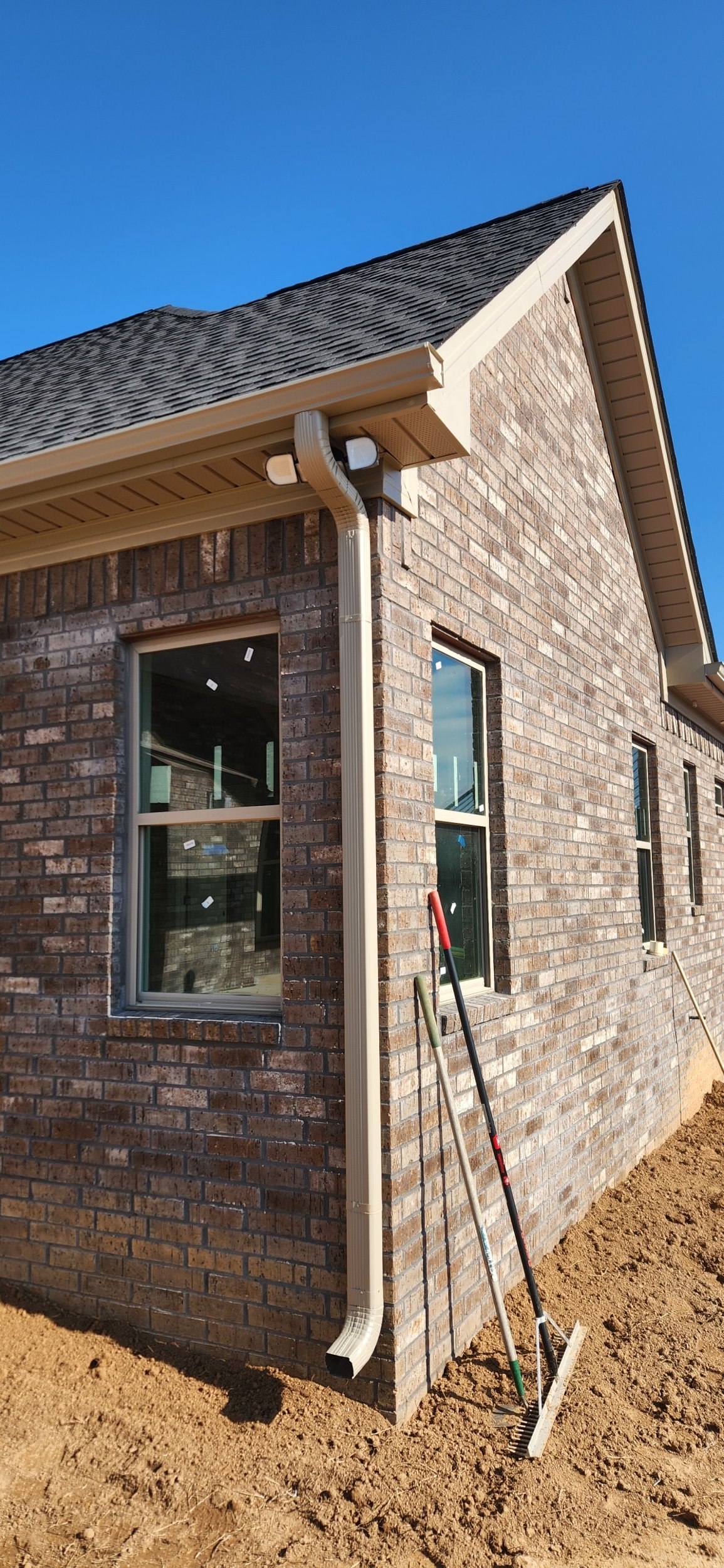

Neat place for a light... The middle is also a light...

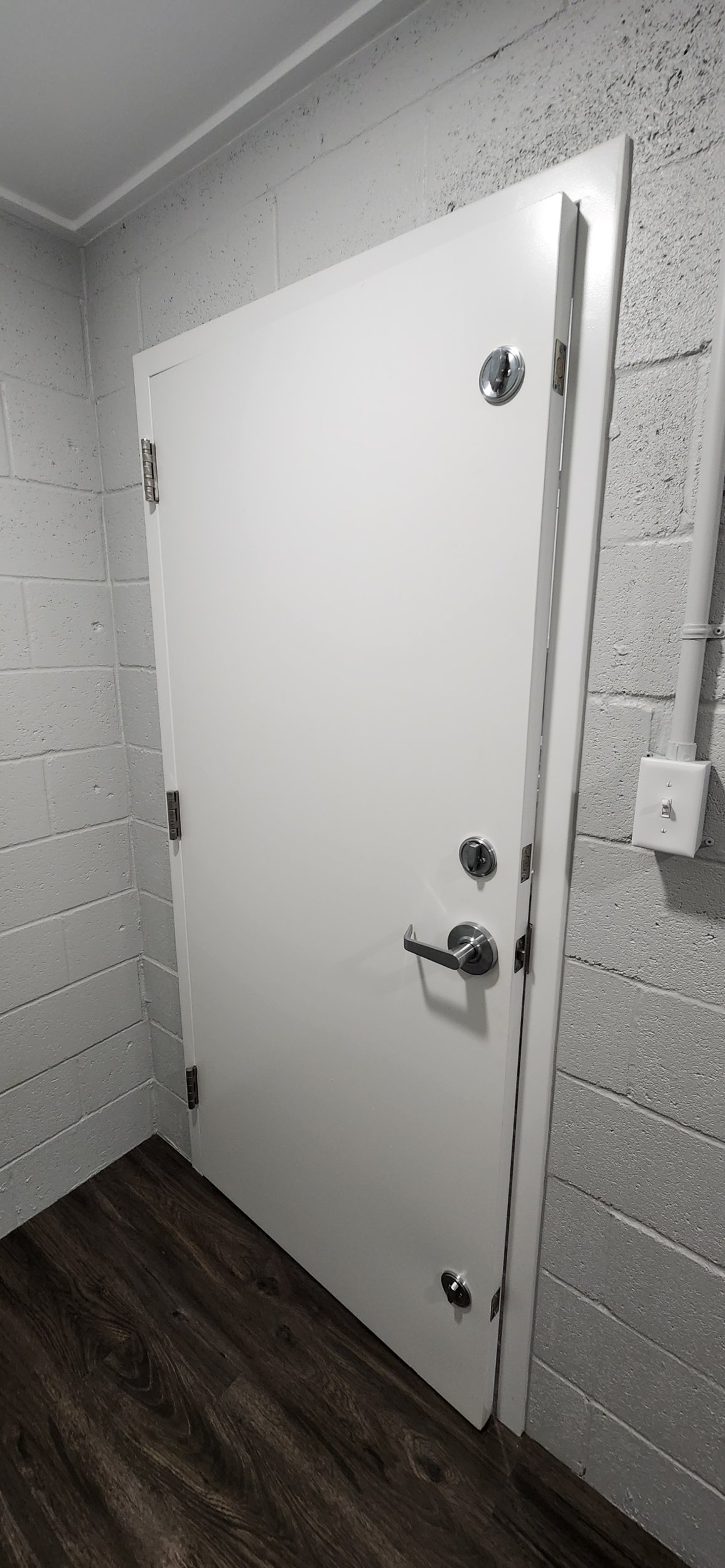

What did you use for a door on your "Safe" room? I saw the cinder block walls on your video, but didn't see what the door looked like. Eventually, I want to build one in my house because we've had tornado's ten miles away.

That's a good looking door!!!! I'm looking forward to the day that I can build my room. Every time there's a tornado in the area, we have to decide what we're going to do, and how we're going to try and save the dogs. Our best option is to climb into the bathroom and hope for the best with one or two of our six dogs. When I build the safe room, we're going to put dog kennels in it so we can lock them up if things might get bad and not worry about them.
