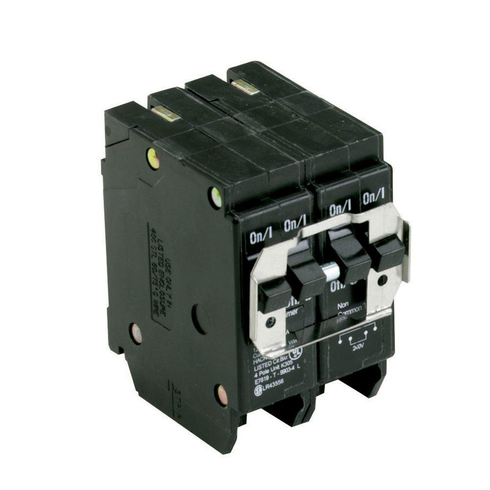

the one I removed powered the hvac, I removed it and replaced it with the ?quad? pole 240v breaker so I could (continue to) have the hvac, and add a 240 outlet for an air compressor.
I decided I was going to push the levers until it broke, or reset, and luckily it reset.... now if easily flips between on and off. Thank you to everyone who replied
Quad pole? Did you purchase those half @$$ed half size breakers ?
Unless the poles are linked , it's not a two pole breaker for use on single phase 208/240,480 or 600V loads.
Sorry but you should not be touching anything electrical. Hire a pro before you burn the place down or kill somebody.
   / house circuit breaker question. #46
Take the breaker out of the panel and see if it will hold in the on position.. Plugging it into the panel may have tweaked it.. If is still doesn't hold check continuity between where it plugs on to the panel to each output. Might I ask what brand ??? It sounds like a bad breaker !!!
Some of those 1/2 sized breakers will not fit in every breaker space . The buss bars are usually not punched for 1/2 sized breakers in the entire panel. Otherwise some Bubba would fill an entire panel with 1/2 breakers and overload the panel.
   / house circuit breaker question. #47
Umm, you might want to brush up on Eaton's current offerings: Eaton Type BR, BQ Quadplex Circuit Breaker, two 30 Amp 2 pole breakers-BQ230230 - The Home Depot
