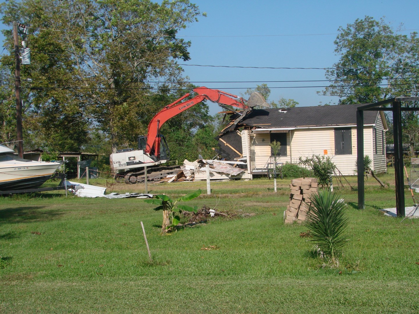

I had 2 houses torn down on property that I bought within the last few years. A cheap permit consisted of having the utility companies come out and unhook the phone, electric and gas lines at no charge and having the septic tank pumped out, filled with sand, then dug up when the house was demolished.
I was charged $4000 for the larger house and $3000 for the smaller one.
Both jobs were done in one day each. The excavator operator was skilled in smashing down the material completely so it would fit in the least amount of disposal units to cart off.
