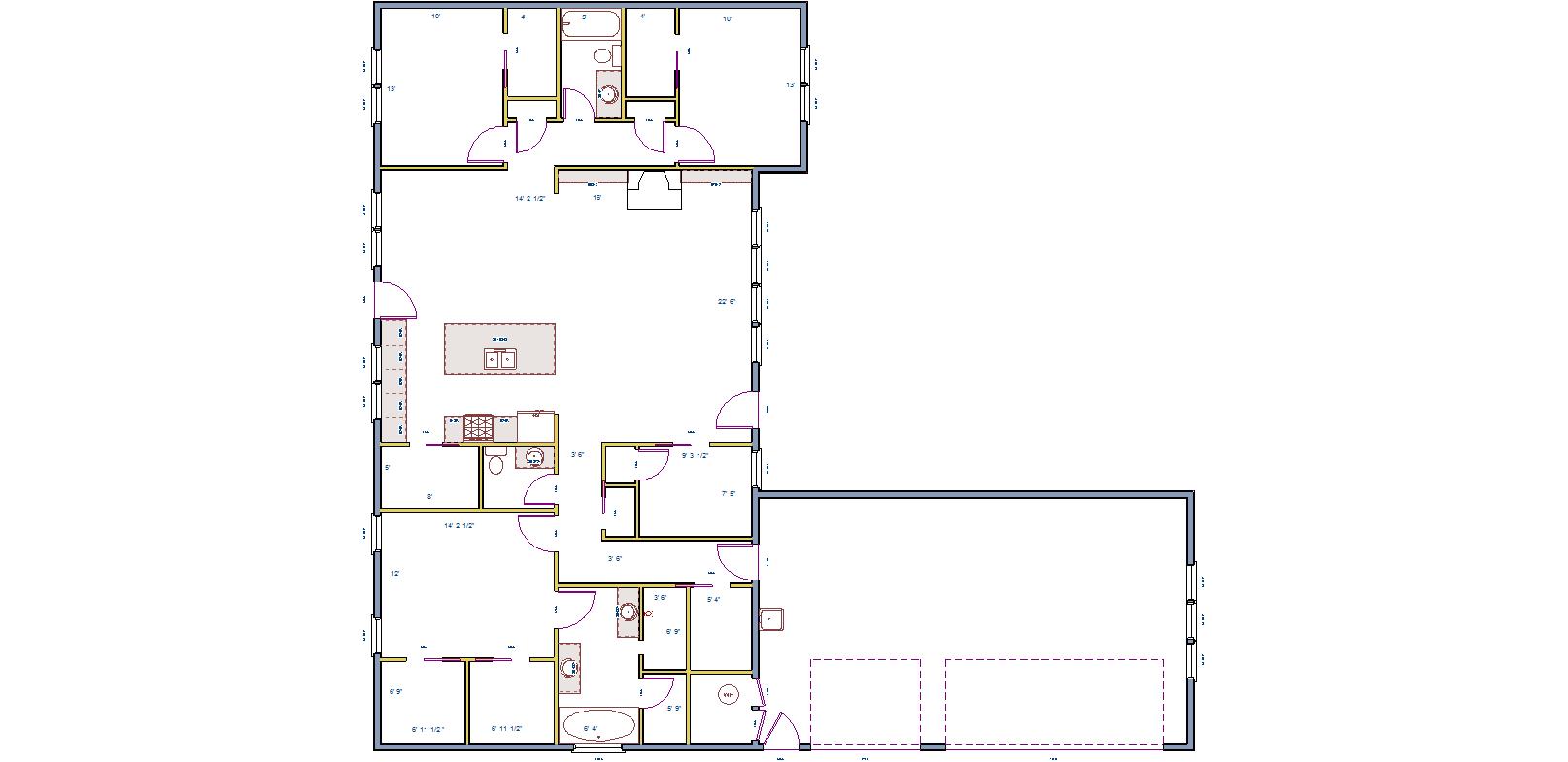

The plan I came up with is 2,000 sq ft. Three bedrooms, 2 1/2 bathrooms and a small office. One story, easy to clean and big enough to entertain, but also small enough to not be very wasteful. Most of the walls will be 8ft tall, except the open middle area, which will have 9 ft walls. The family room will have a vaulted ceiling, the kitchen, dining and master will have raised ceilings.

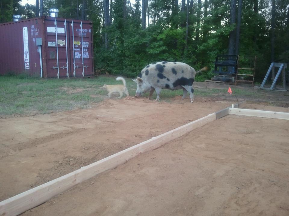

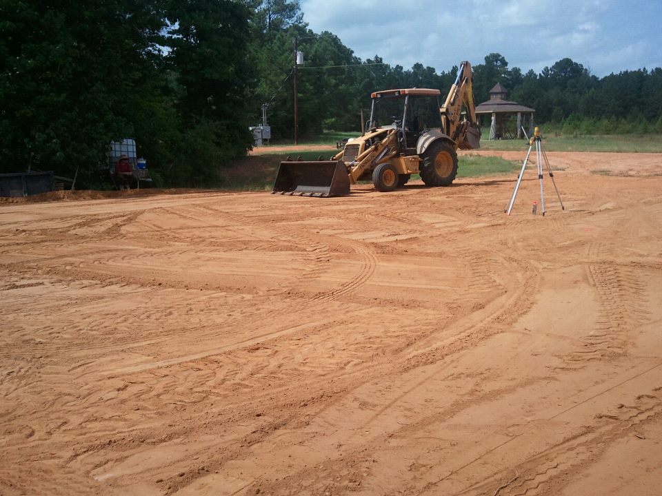

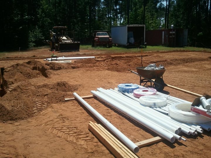

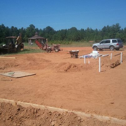

We had to add about 50 yards of dirt to build up the pad. My dad did all that with the backhoe, one yard at a time. I spread and leveled it off, then measured it out and put in the forms. Then I measured and marked the locations of all the drain lines, the water main and the water lines to the island in the kitchen. Dad and I both dug the trenches, but he did the hard part by digging around the other lines going to their RV to get to the sewer and water lines.
