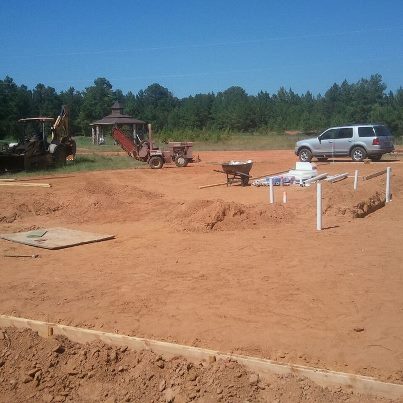

We got all the trenches dug for the drain and vent lines. Installed them and will get them covered up and compacted in a day or so. There are a few more lines to run under the slab, then I need to locate and dig footings to support the load of the beam that will span the great room and as well as the load bearing wall down the middle of the house.
I'm giving my dad the shopping list for rebar. 36 sticks of #4 and 70 sticks of #3. That should all be done this week. The pad will be treated for termites this week and we'll be ready for concrete some time next week.
