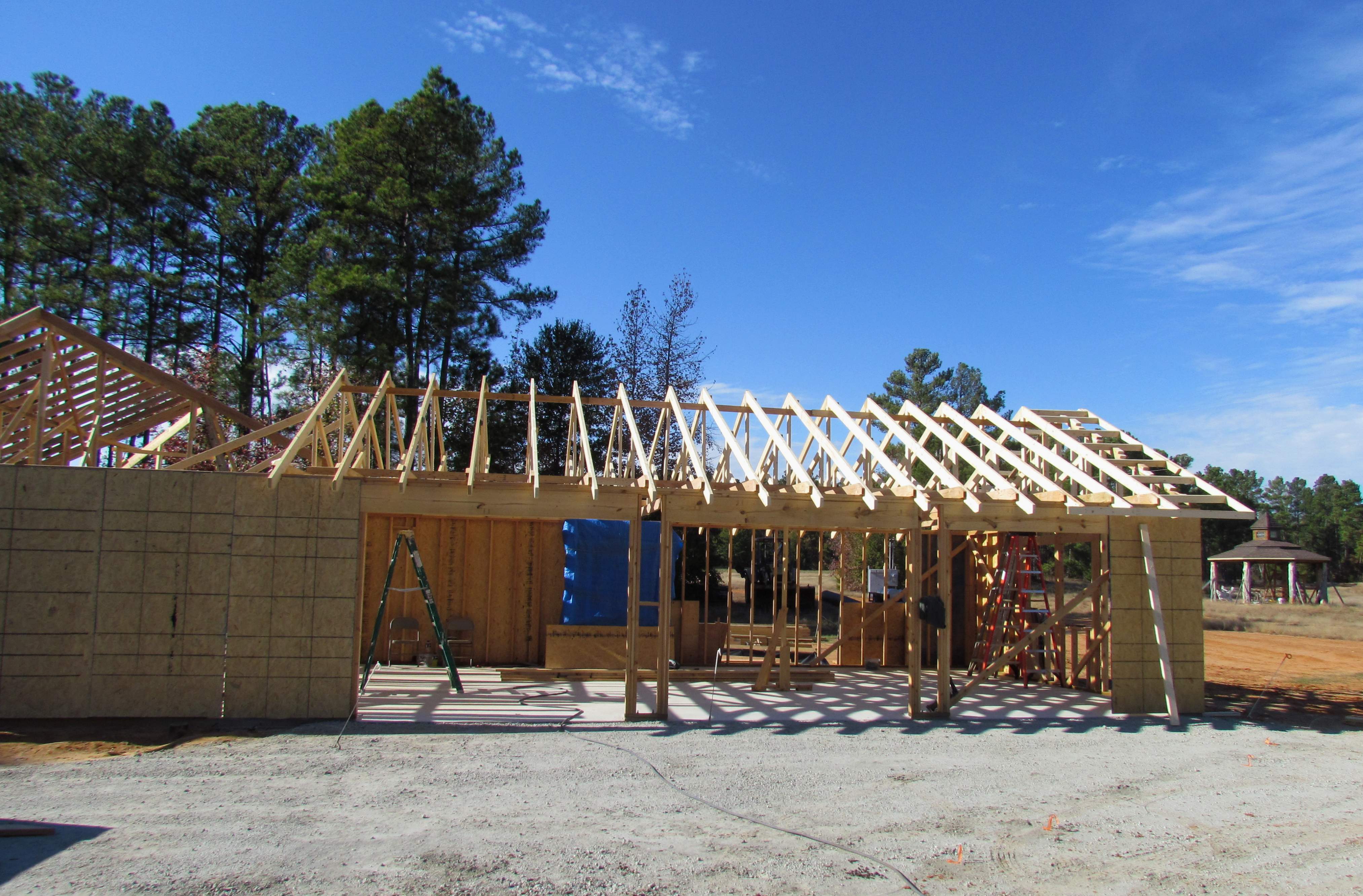

Last weekend I built the first two trusses for the garage. Then I wrote down the lengs of each piece and had my dad cut all the pieces for the remaining 15 trusses during the week. The way we're building the house is on the weekends I do all the detail, precision work, as well as anything up high and dangerous. During the week, my parents do all the slow, time consuming things that need to be done.
Yesterday we built all 15 trusses in place. We just built the next one, then the next one and then the next one until we where done with them just before dark. Today I built the gable end wall and gable eaves, then spent some time bracing it all together.
Eddie

You are sure moving along, Eddie. Soon, you'll have the decking and roof on and be in the dry. My gut feeling is that the cost of this house is gonna be astonishingly low.
   / House for my Parents #154
Eddie....You are doing a great job...but I want to really mention and commend you on what a neat and clean job site you are maintaining....that has always been a pet peeve of mine...I can't tolerate builders that work in a mess of scraps or leave the job with a pile of garbage and scrap from day to day....You exhibit all the signs of a true professional....congratulations and especially on being such a fine and caring son.

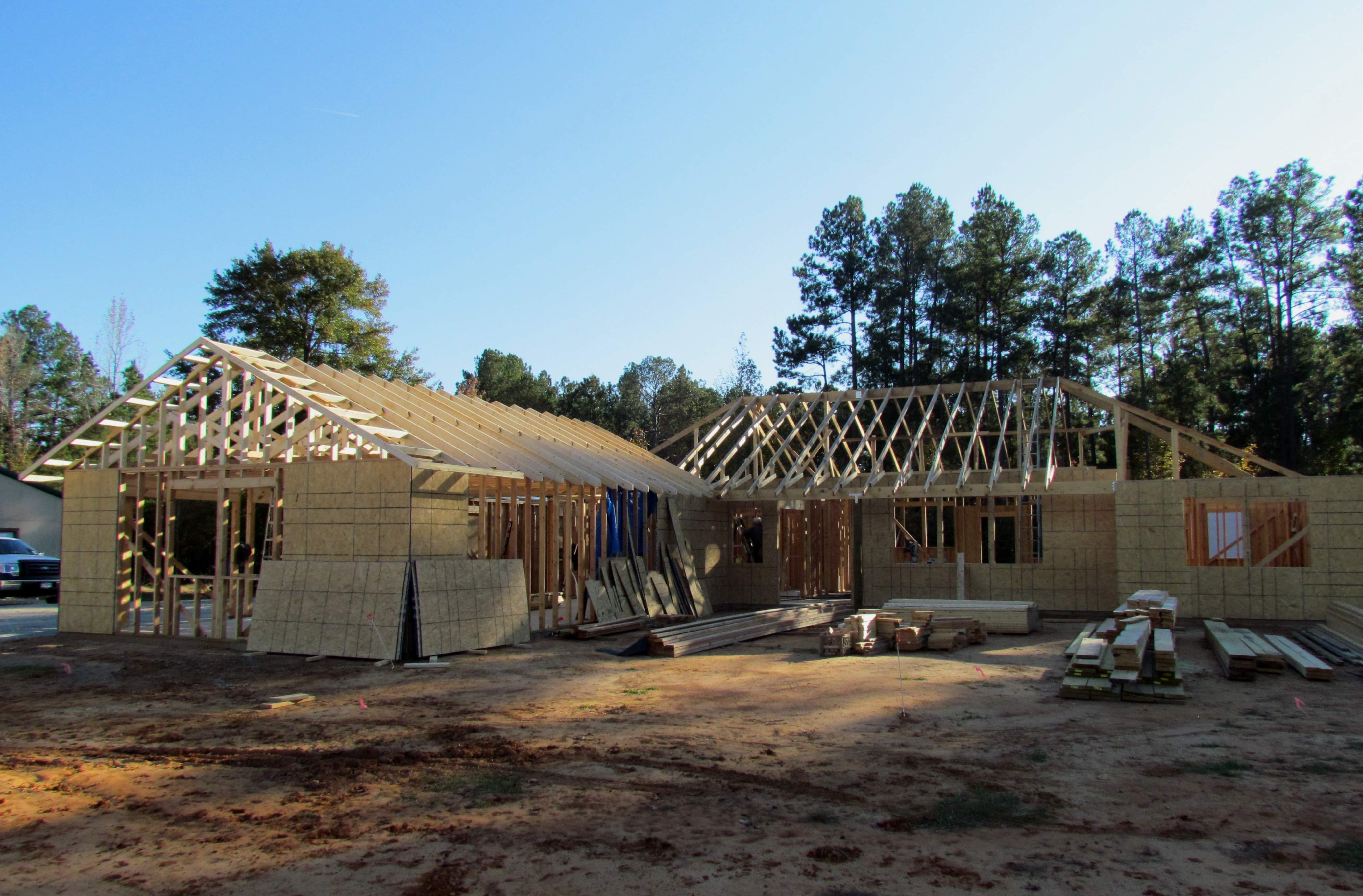

Thank you, but I have to give my Mom most of the credit for keeping everything cleaned up. I'm huge on staying organized and not having anything on the ground to trip over, buy she is truly OCD in keeping it nice. She sweeps three times a day!!!!
Island,
Thank you!!! Sometimes it's frustrating, but when I figure out what they can do, and they get it done, it's very worthwhile. And like everyone, it's mostly just not being familiar with what I need them to do and trying to explain it to them. Once they understand what has to be done, they tear it up and stick with it until it's done.
Today they finished all the OSB on the walls!!!! It's funny to see them work together. Mom tells Dad what to do, he tries, she gets mad and yells at him, and that' when he listens and it gets done. Once the OSB is in position, she gets her chair and sits on the inside while he nails it in place. Every time he misses, she tells him which way to go and how far off he is. Truly two old people that have their own way of getting things done!!!!
