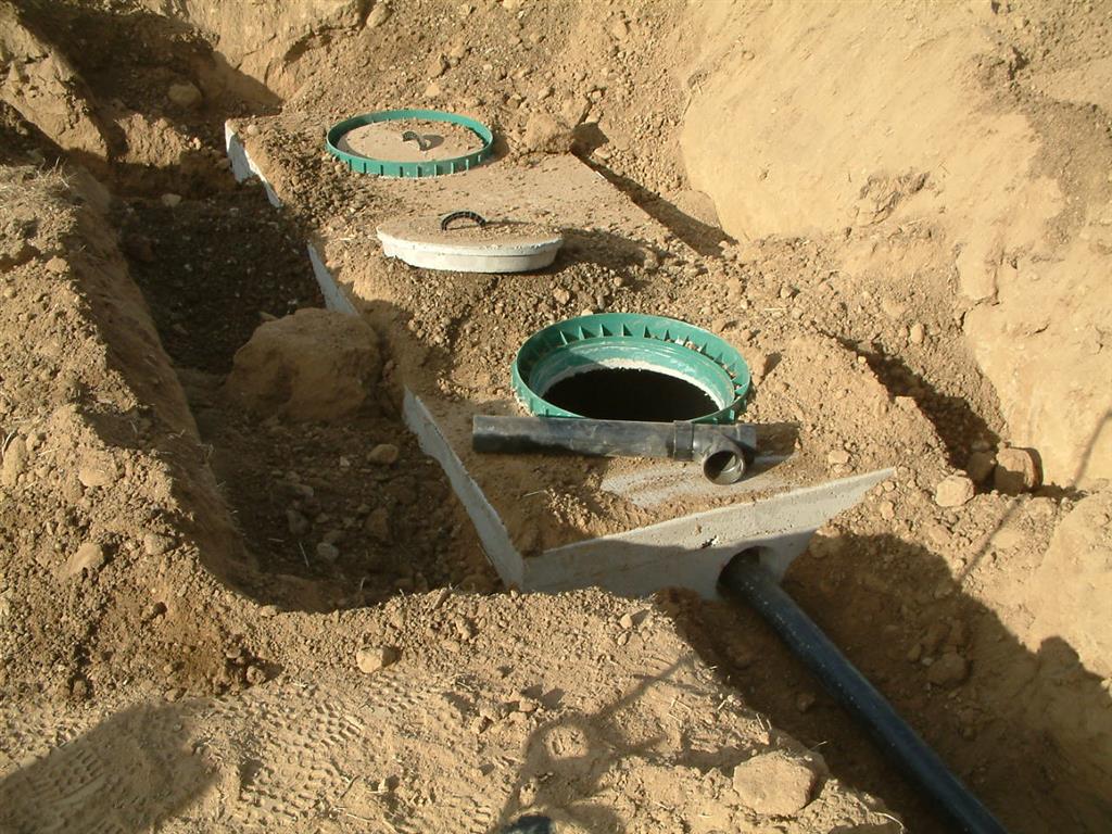

I recently sold my ranch and had to get the septic tank pumped per CA escrow regulations. Here are a few photos showing that process.
DSCF0030 (Medium).JPGDSCF0045 (Medium).JPGIMG_0559 (Medium).JPGIMG_0564 (Medium).JPGIMG_0566 (Medium).JPG
The tank was installed in 2005 when the house was built. So I had all the info needed to find the tank and the other parts of the septic system.
The guy who pumped the tank said that the installer did an excellent job. The lids were about 18" deep so I had no problem digging them out myself (saved $100). He could see that the installer used black ABS pipe on the inlet and out lines from the tank which is the proper way to do it. Some installers scrimp and use white PVC pipe on the outlet end of the tank which is more likely to collapse eventually.
Good luck
