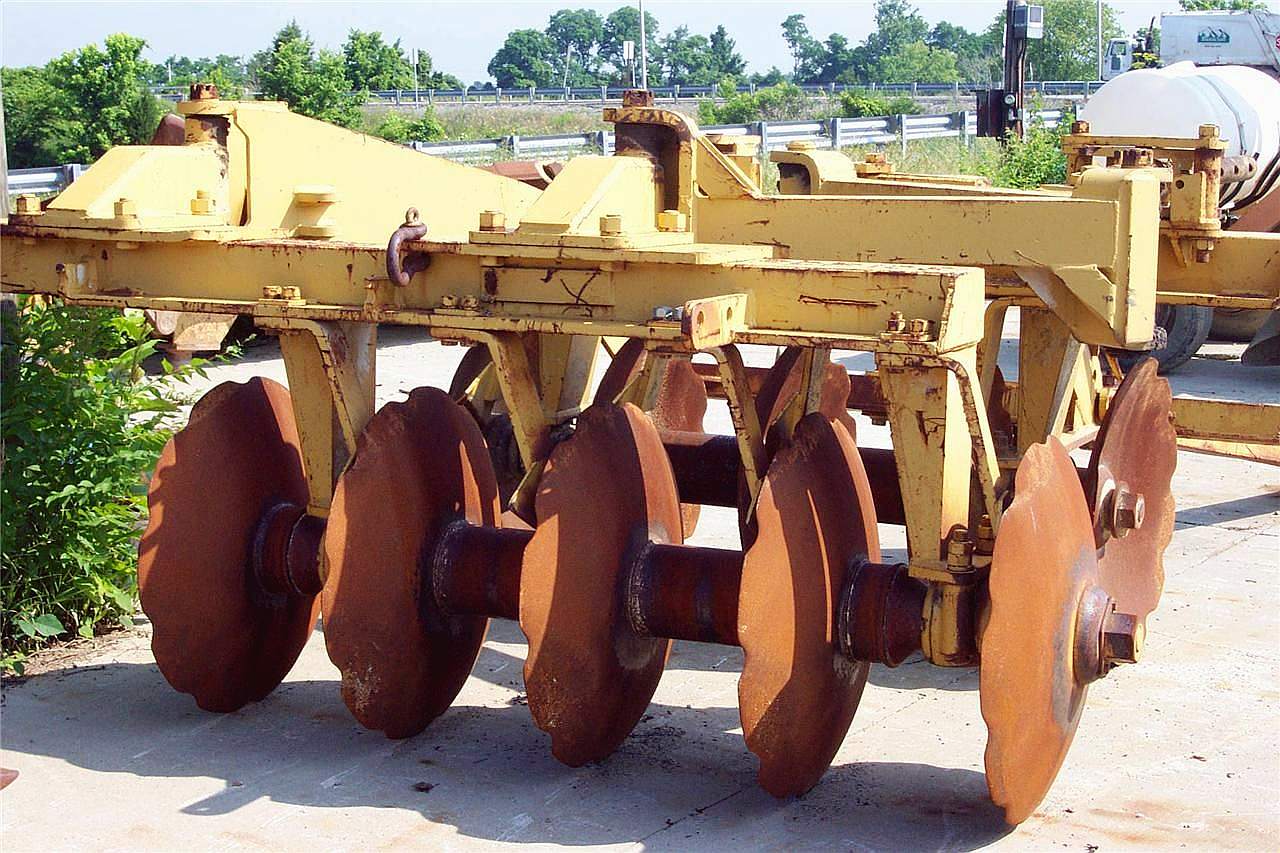

I don't think that these huge discs are intended for any kind of stump removal. :eek: I believe that they are usually used on farms and till the earth from 12"-18" deep. Yes they will cut up a 6"-8" limb, but I doubt that that is what they are intended for. :confused3:
   / How about this $25,000.00 Attachment ? Wow ! #19
Some of them are used for disking just after the trees are cleared out. :D
   / How about this $25,000.00 Attachment ? Wow ! #20
A lot of site prep disks used here in the coastal plain have disks anywhere from 4-6 feet tall!! That can be used in a chip-n-saw sized pine stand after clearcut it will help tear up some smaller stumps and bust up the hard clay for water penetration as well as tear up some hardwood roots. This of course proliferates sweetgum.
