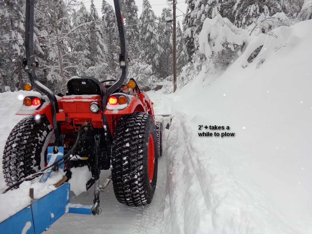

How are my turf tires going to handle this job?
   / How are my turf tires going to handle this job? #11

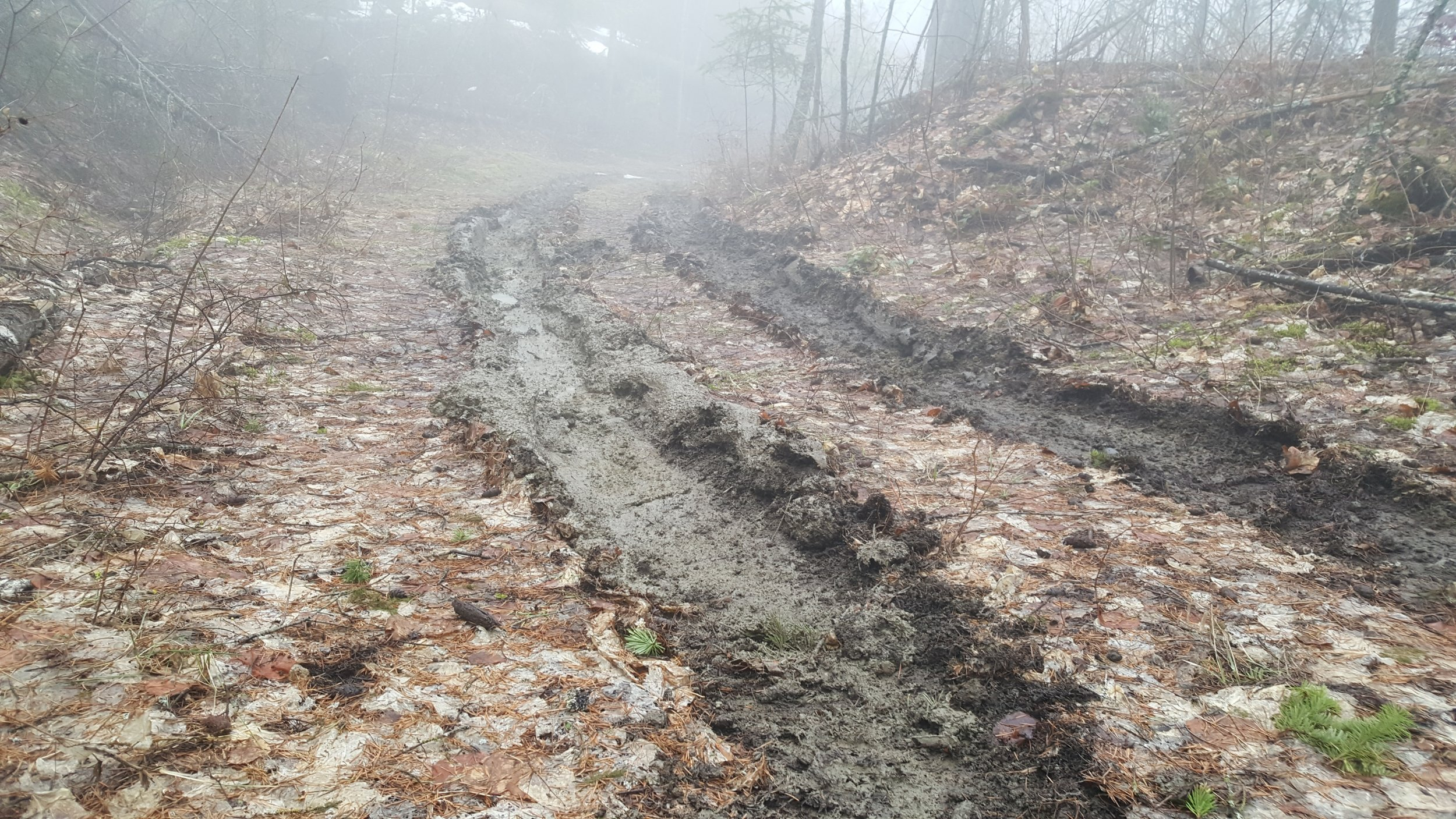

Took this pick a few wks. ago fairly steep climb with loaded turf tires but no counter weight. When it's wet gumbo clay you keep the tractor in the garage.

Give it a try. If it does not work you can add chains or go to a different type tire or add more weight to your tractor. About 99% of the time you will have more power than traction.
BTW - Welcome to TBN Jerry.
Thanks for the welcome. Actually I'm a returning member, and have enjoyed this site for years.
I agree with your comment, and chains are an option I'm considering anyway for year round use. Thanks again.

I cleared residential snow over 5 winters just outside of Winnipeg Manitoba with Kubota tractors.
Started with a BX24 and graduated to a B3030HSDC.
I had great success with the loaded turf tires on the BX24, and when I got the B3030, the weight of the FEL and rear snow blower were more than sufficient to get the job done...even on glazed and wind packed snow.

R3 Turf tires are actually preferable unless you're in deep mud like in the photo above.
More biting edges, more surface contact, more pliable sidewalls, it all adds up to more traction.
R4s are terrible, and R1s are only good if you're in that mud that was pictured in the post above me.

Stay outta the mud with turf tires and if you feel sporty, be sure you have a snatch strap for your pickup truck.
   / How are my turf tires going to handle this job? #17
As soon as that started, I’d go back to the house and wait for dry weather. It’s taken me too long to get grass and gravel holding everywhere to tear it up like that.

I can't imagine plowing snow with turf tires, or indeed going into my woods, which tend to be on the wet side.

Bill that was only a short stretch of a mile or so of trail that was dry.
I have a long steep driveway as long as it's cold I can plow going up as well a down with no chains. Unfortunately there's always wet snow falls and times when it's glare ice so I use rear chains with cross links every second link. This was before I had the chains made and the conditions were good.
