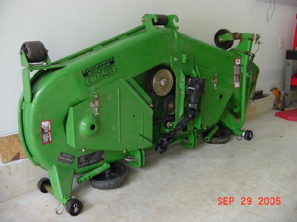

I've been using Larry Mower Axles for 10+ years now:

Ryan, look closer - those are actually small wheels - makes me wish my Cub RZT 50 deck gauge wheels were designed that way... Steve
   / How are you guys lifting a mid mount mower upright for winter storage #8
now that is just plain cool! first time ever seeing something like that... taking off the gauge wheels and tossing in a bar with a couple rubber ends on it.
Those are wheels, make it easy to scoot it around

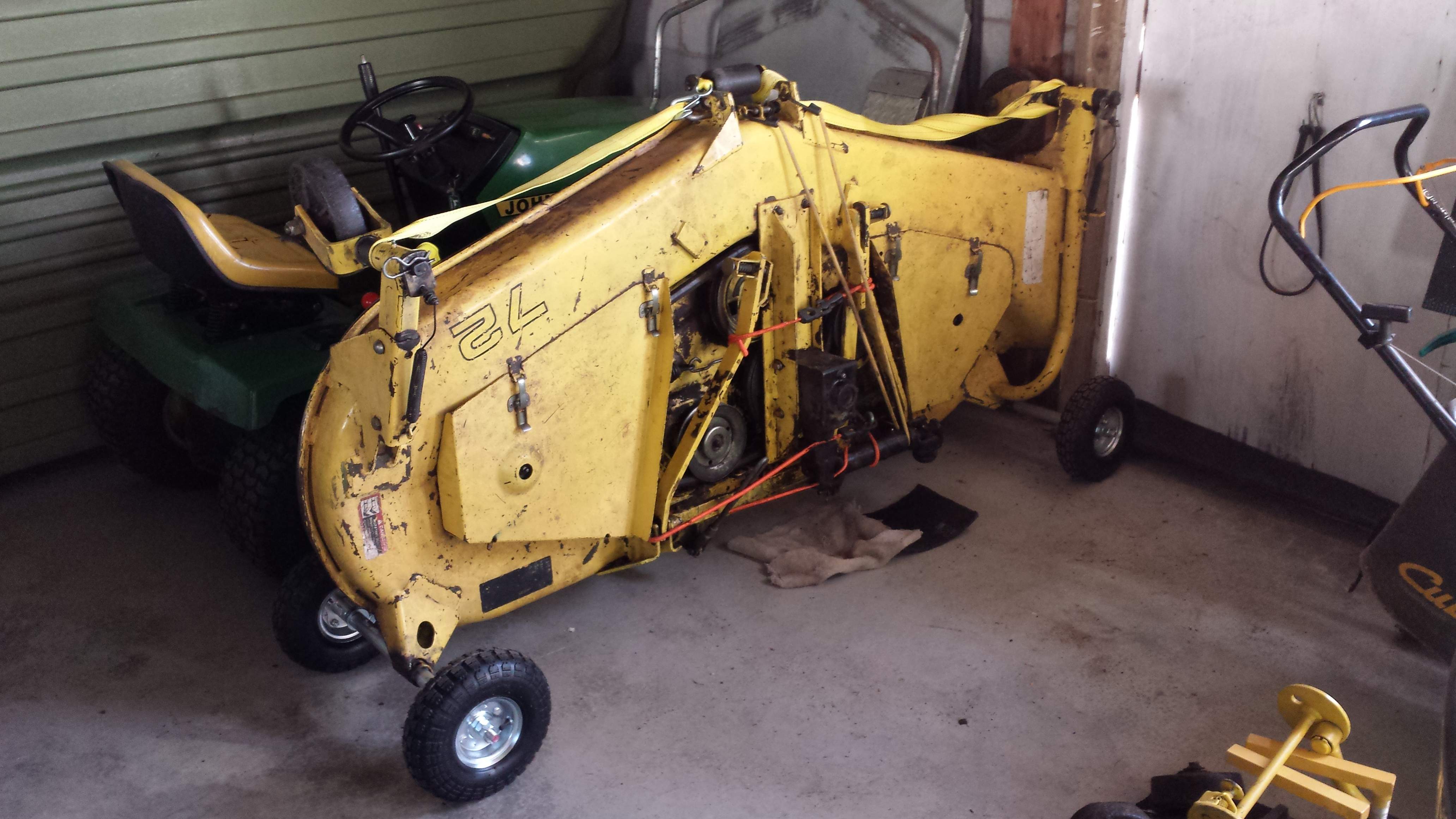

I did the same as kenny only made my own used 1" shaft drilled and tapped holes in the end and used a set of retired lawnboy wheels . Put them on every time the deck comes off to clean up deck and sharpen blades . Get lots of comments from fellow farmers who visit my shop.

I move mine around with a hand truck. Tuck it against a wall in the shed and secure it with a strap. I thought of buying something to help move it about and then discovered how easy it was to move with a hand truck.
