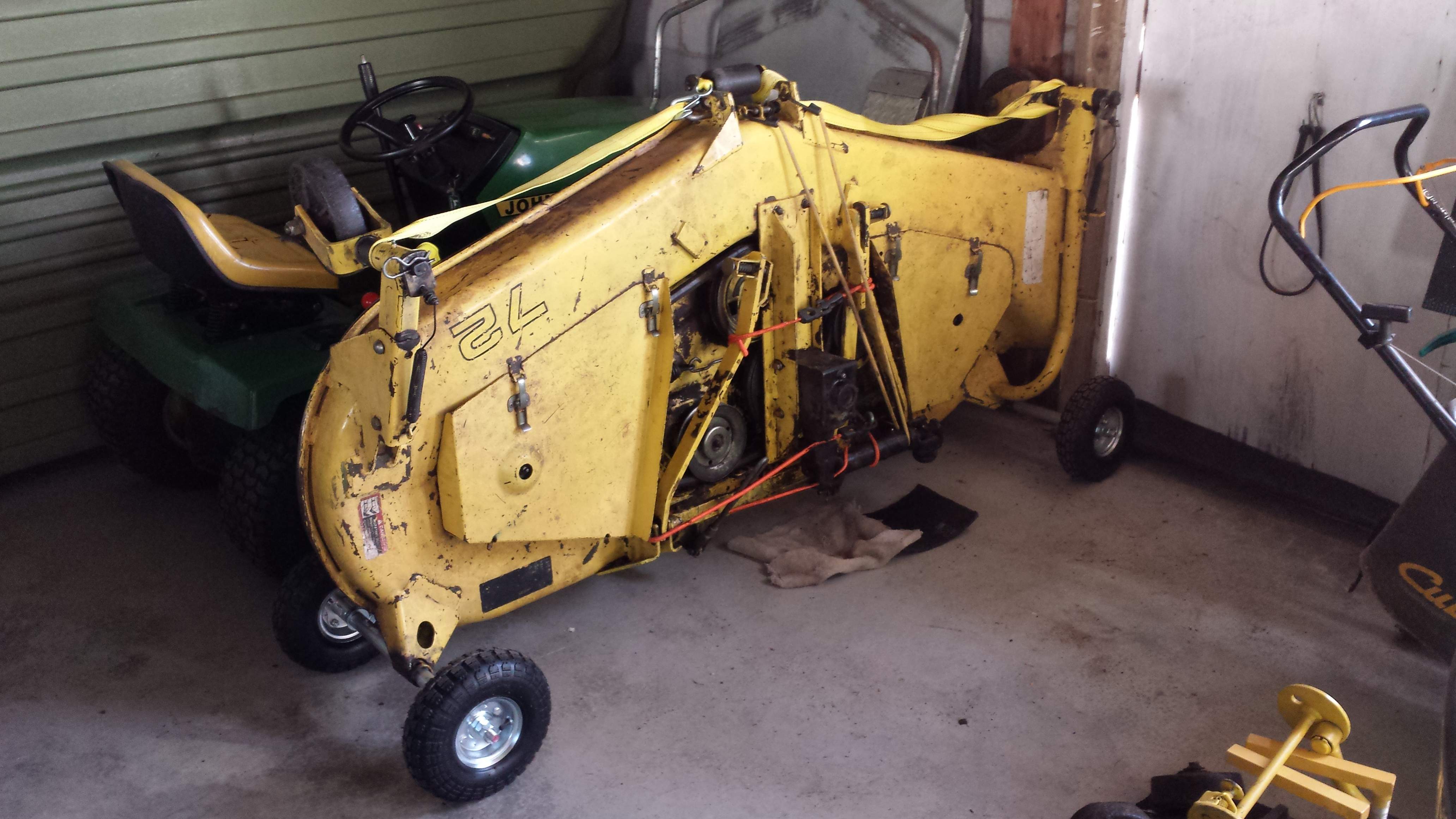

I use a set of home made axle shafts and set of old lawn mower wheels to store my deck upright...
They aren't very pretty, fit kinda loose, but work just fine... And were cheap to put together....
Besides... It makes it a lot easier to clean out the under side after you set it up with the loader....

Problem solved. Bought a pair of pallet forks that attach to loader bucket. Secured lift arms and pto shaft on mower then attached tow strap. Lifted mower upright with forks and attached axles like Wyobuckaroo mentioned. I used 10" pneumatic tires purchased at Harbor Freight for $6 and seems to work pretty well. Thanks for the help guys.
View attachment 399077View attachment 399077
Nice job. Did you paint those wheels? I don't recall HF selling chrome ones....

Those are actually zinc plated hubs. They have wheels with black, white, and zinc hubs. Got the zinc because I thought they looked sexier. Kind of like the old saying that wheels make the car <g>.

The mower axles were built starting with a 2' section of 5/8 all thread rod. Then covered that with 1/2" conduit. Put 3/4" conduit over the 1/2" and then put 1" conduit over the 3/4". Drilled hole through all 3 conduits down to the all thread rod and used tap and die set to insert set screw to hold everything together. Secured tires with washers and bolts. This is going to be useful for saving space, cleaning deck, and sharpening blades. This forum is great. Always get the answers I'm looking for. Thanks to all for being so helpful.
