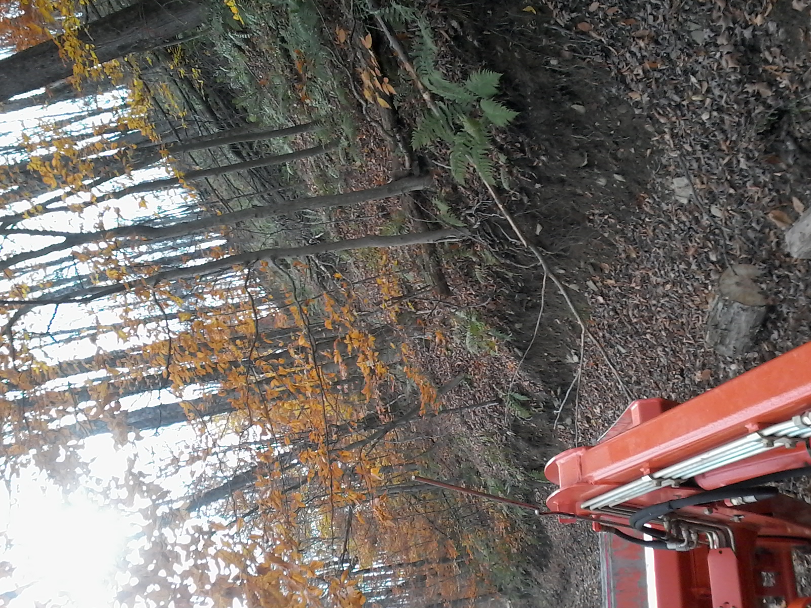

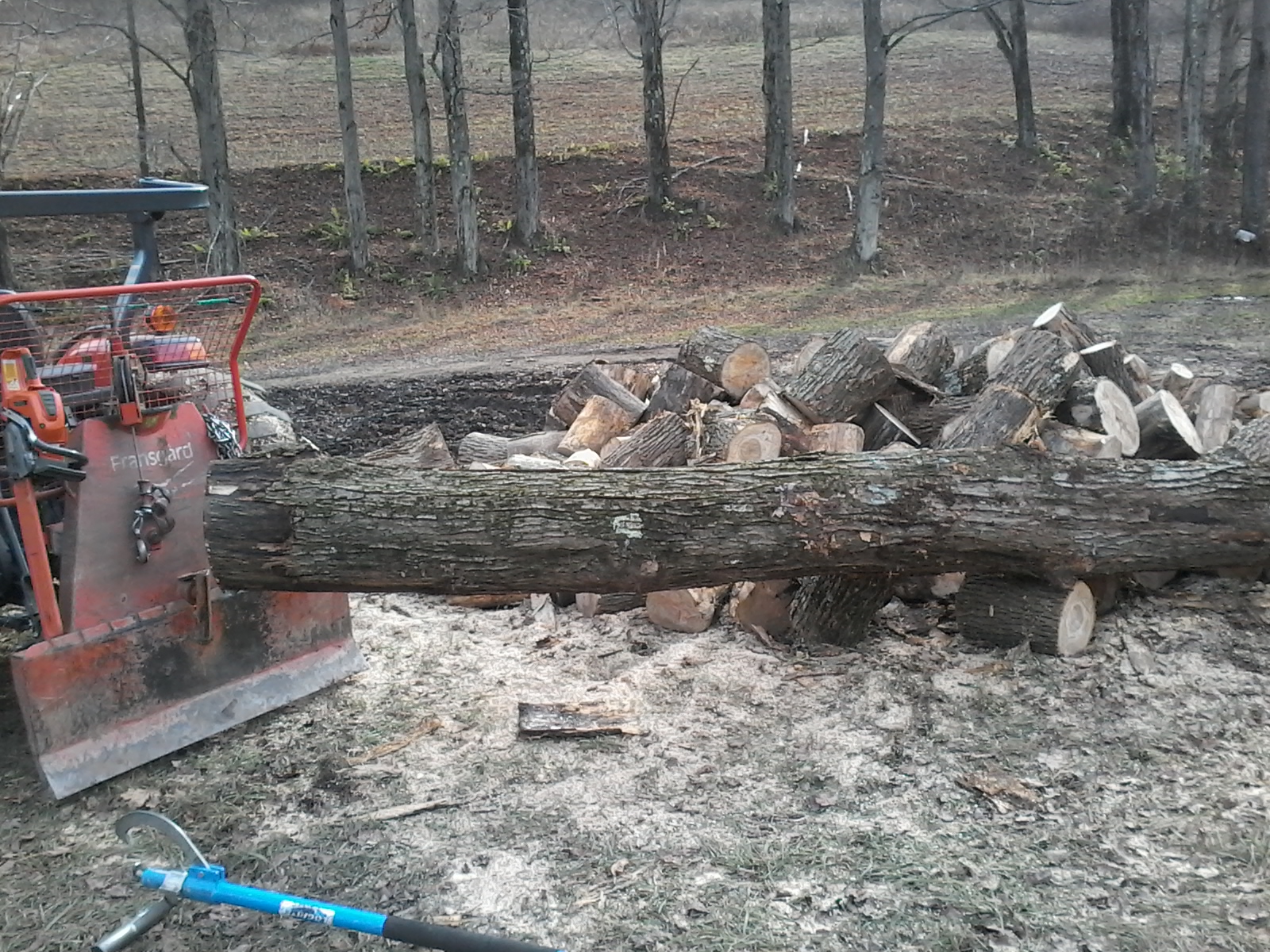

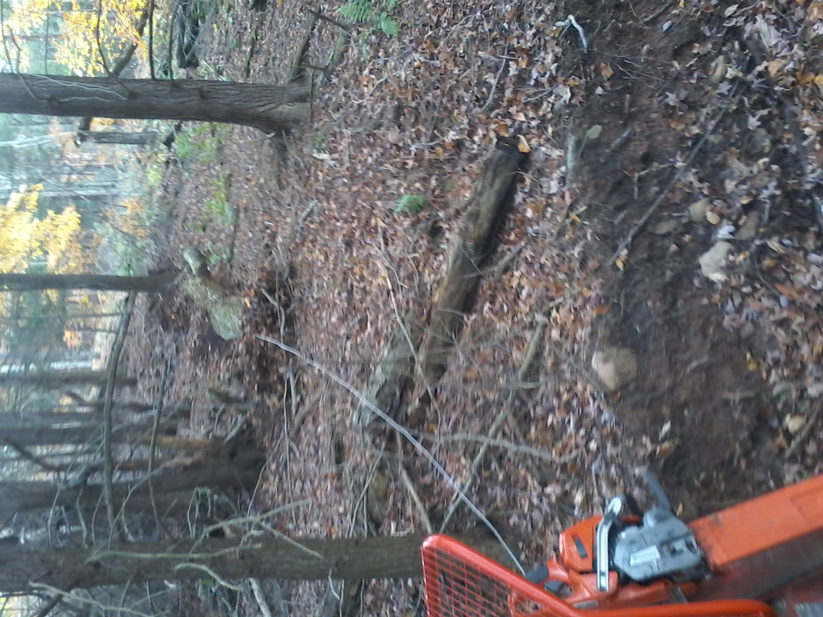

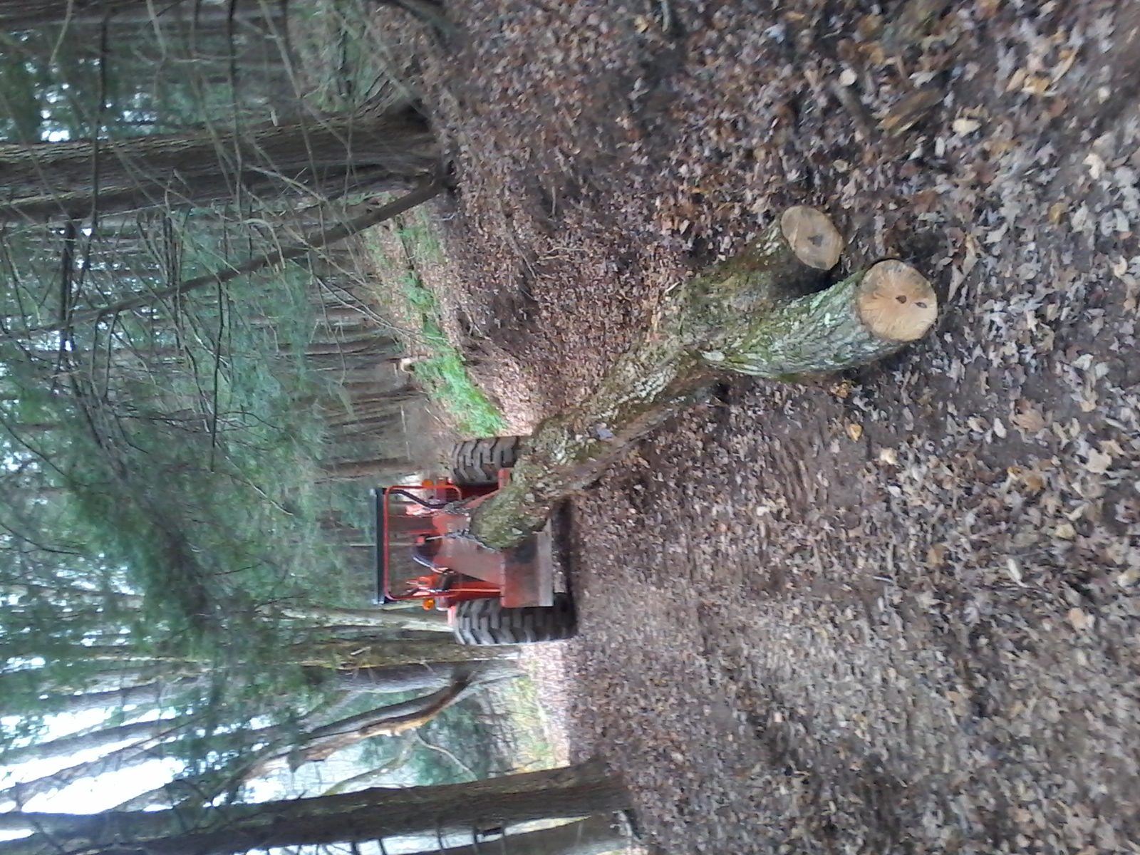

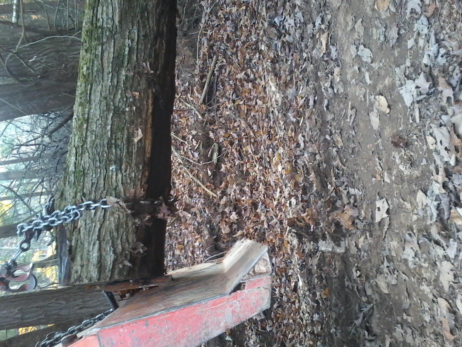

Here is some skids I did off cable today and type of terrein.
I cut the lower pulley off and welded some angle iron on to protect the pto shaft bearing. Seemed to work ok. Log in picture was about 20+ft and about 20"dia at but end. You can see the difference in height I can get the log out of mud by skidding off cable. Also the picture doesnt due justice to how steep some areas are.
