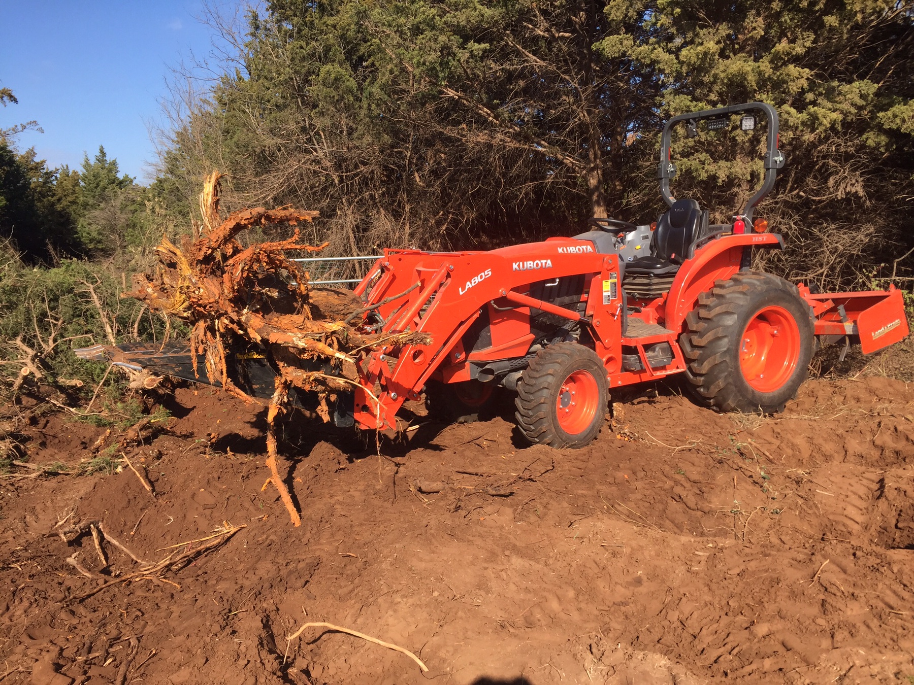

L3560 with a every things attachment stump bucket. 11 inch bodark stumps cut off about 3 feet tall. Works a lot better just leaving the trees up if you can. Need to work on several sides if at all possible. Takes about 10 minutes if your careful. Try to keep the front tires on the ground if you can and do not pry to much with the front in the air. Cedar trees easy work.
Also works fine for transplanting shrubs and small trees. Especially if you presoak the ground around them if its really hard ground.
Have used it on larger skidsteers and it makes short work of most stumps
Excavator is better no doubt but thats just another expense unless you already have it. The stump bucket is a handy item to have a viable when needed.
