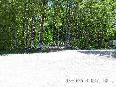

I just put in two 10' gates using 3" rigid conduit [ galvanized pipe ]. I am old enough to have replaced some of those last forever wood posts... plus, being a has been electrician... only seemed right. :)
