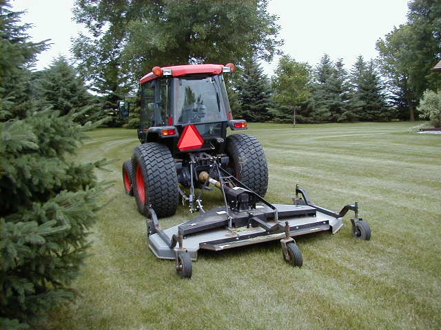

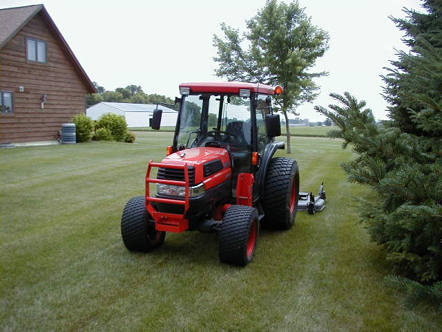

See attached. I have a 90" RFM mower on my 35 HP tractor. On level, smooth terrain cutting at finish mower heights (3 1/2"), I can easily cut at 5 MPH. However, I usually cut at 3 1/2 to 4 MPH in order to keep the guage wheels from falling apart. Make sure any unit over 84" has at least 5 guage wheels and several "anti-scalping" rollers.
The other thing you have to concerned about with the wider units is scalping. If you are truly cutting at finish mower heights, the wider the mower, the more exaggerated bumps and ridges become.
Get rear discharge so you do not windrow the grass clippings.
Good luck on your purchase!
OrangeGuy

Sorry, wrong picture
