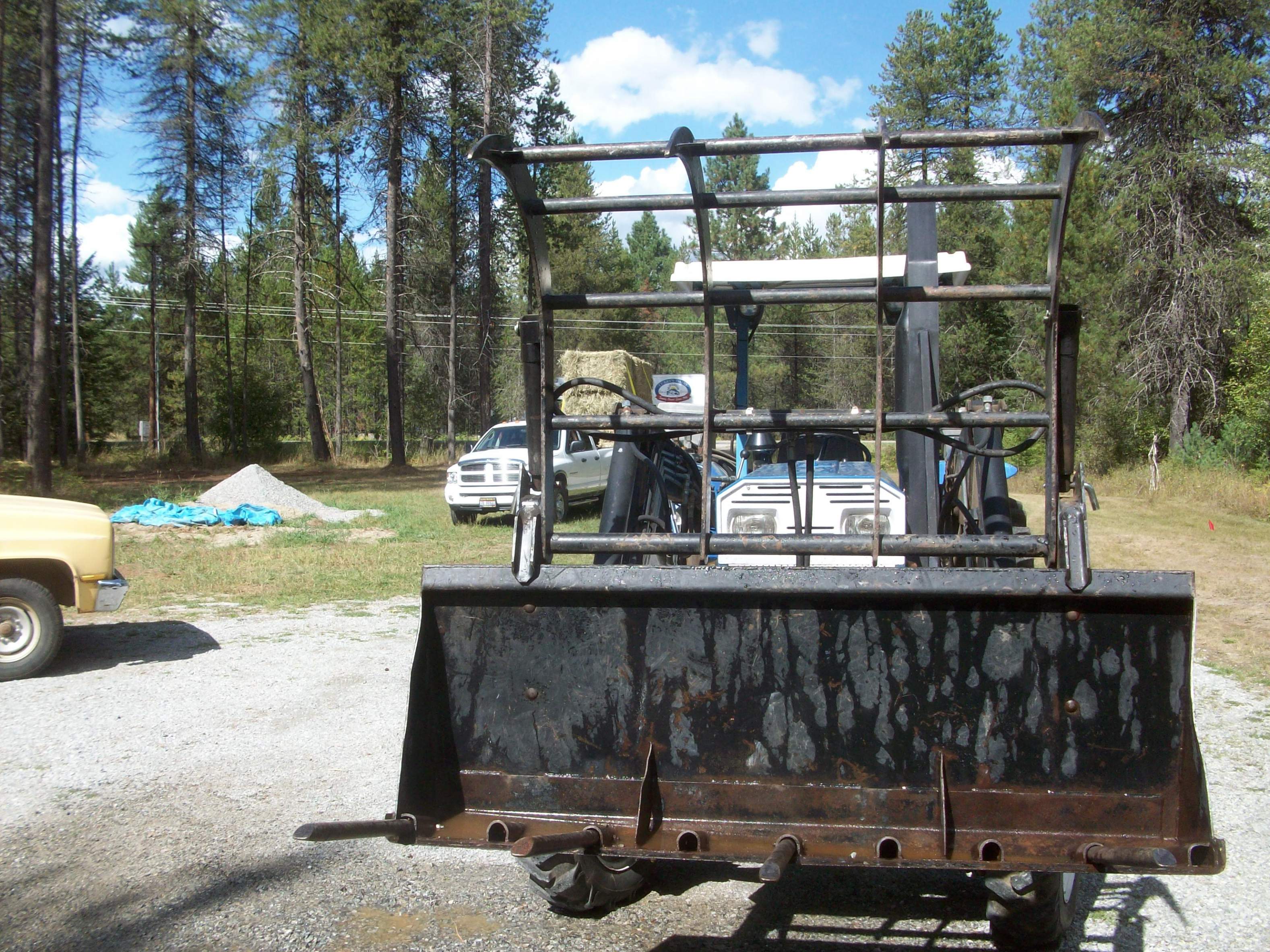

I went with a 66" on my L3940.
Just picked it up this weekend!!

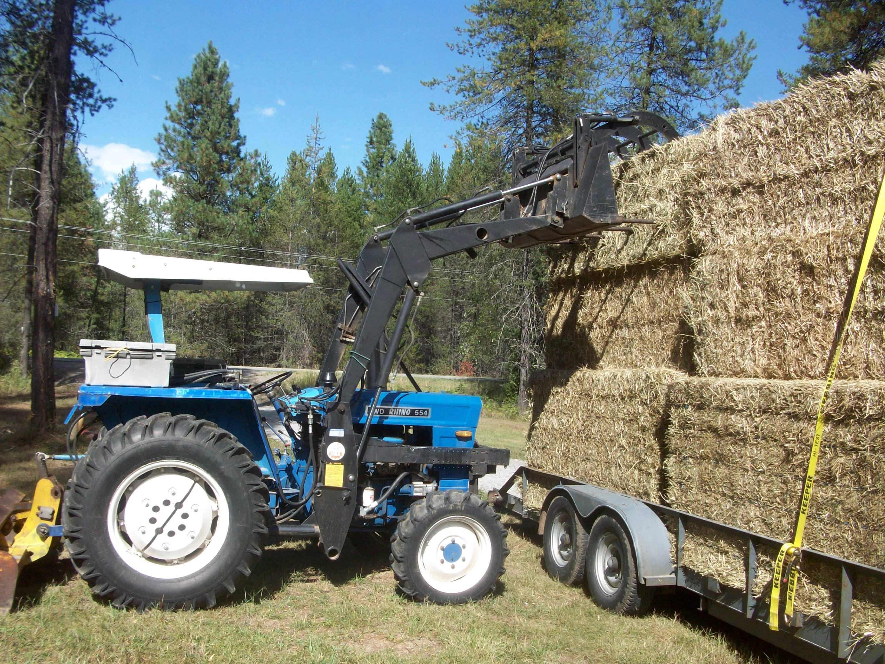

66 inch unkown brand round tined construction/manure version, opens 48+inches,550lbs?? guess.
tractor 55 HP Rhino- 5350 lbs. before loader or any added equipment, 8000lbs. as it sits with empty grapple and gannon box blade on back...
Very happy with its performance
Found a new use for the grapple today.
Had a hard time finding hay this year( due to local production being 45-55% of normal)
anyway our farmer friend had some extra he imports from canada.
they are about 3 x 4 x 8 and are weighed and guaranteed to be at least 1080lbs. guessing it is a Canadian thing? so 2 make a metric ton??

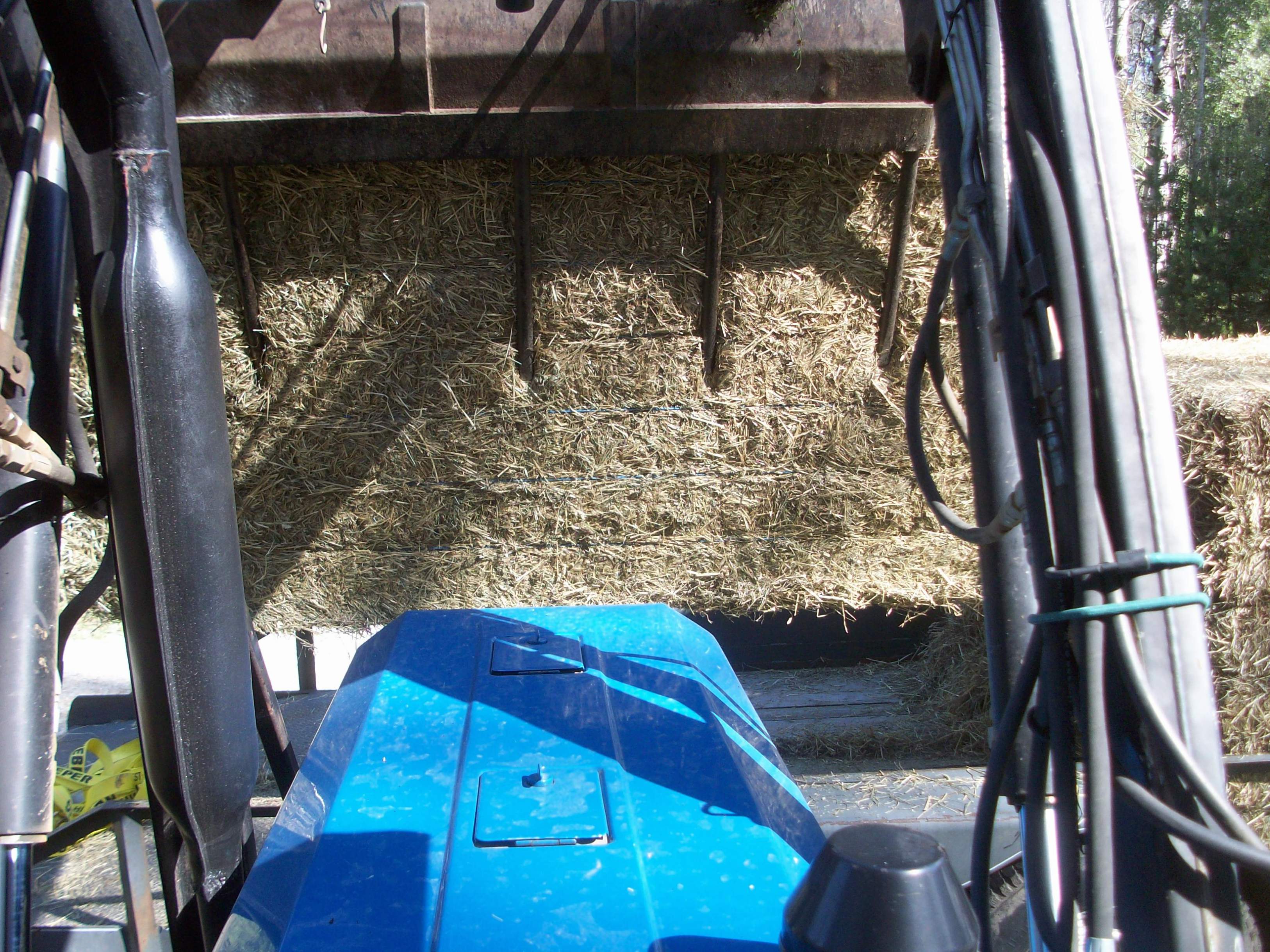

He loaded 8 on our 5th wheel trailer and i needed to unload them at home so it occurred to me that my grapple is somewhat similar to a bale spear,
so i removed 5 of the 9 round tines and went at it.
Hay bales-1100# squares 006.jpgHay bales-1100# squares 012.jpg On the bottom bales actually was able to just grapple them normally, but unfortunately some did need to be speared.
The grapple worked fine to stack up to 3 high and talk about saving the old back:thumbsup:
-last year had to hand stack regular small squares :grumpy:
Like this way of handling hay- i think it even beats the round bales
the old grapple suprized me again with its versatility

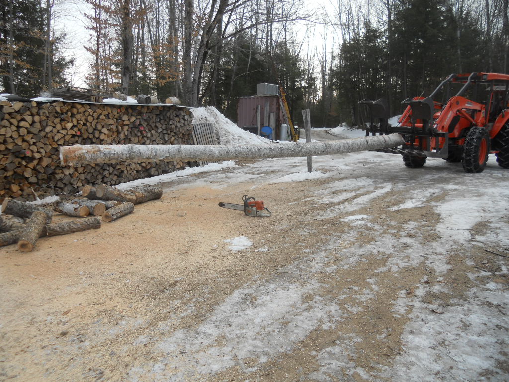

I welded a #10 rebar across the top back to catch the top of a log so that I can pick it up the "long" way. I buck my firewood at the splitter this way at a standing position keeping the bar off the ground.
   / How big is your root grapple/tractor and what do you use it for? #20
That looks handy, I may have to borrow that idea, looks like an easy way to buck the wood up without re-positioning the log :thumbsup:
