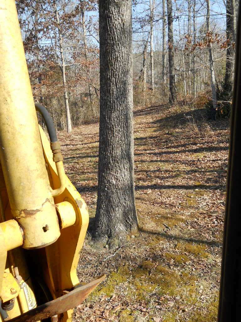

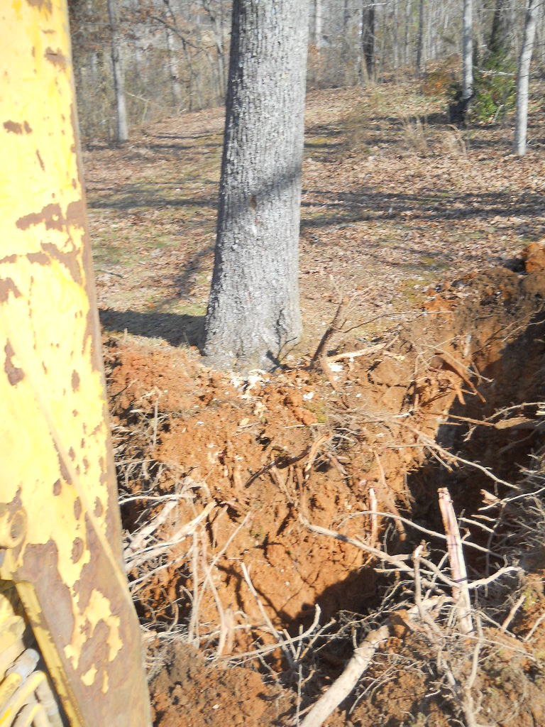

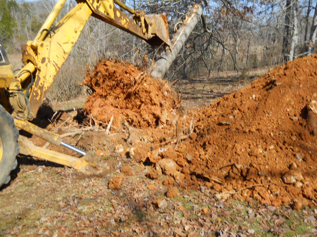

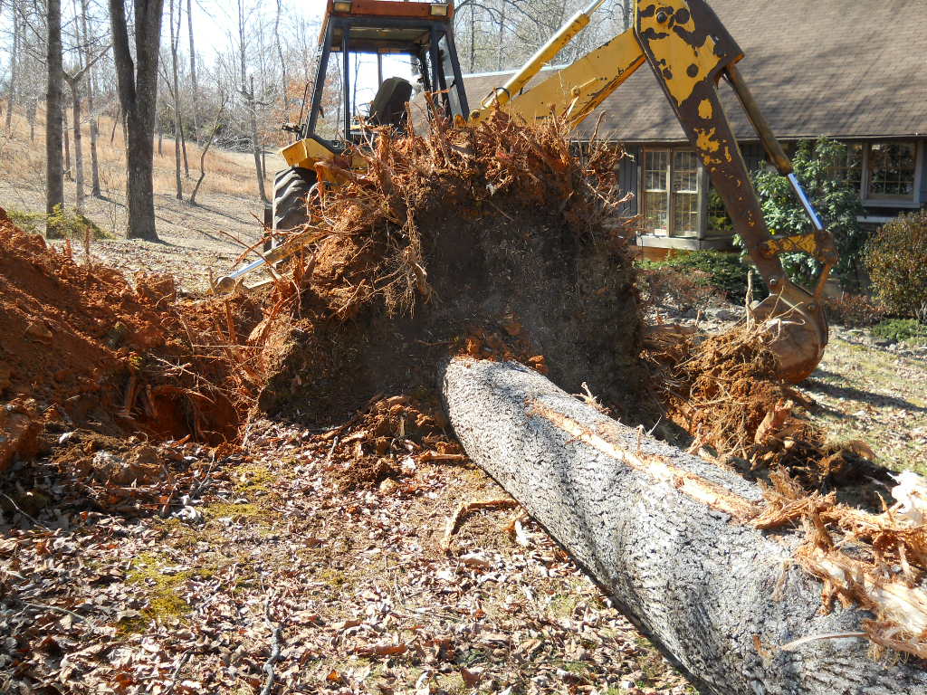

Welp, here's the rest of the story.
Tree was probably bigger than 12" diameter and probably equal to or less than 18" diameter. My bucket is 24" for reference.
Turns out the root ball of this was bigger than I expected. Not a huge deal. I tried to push it over once/twice early on and it was going NOWHERE. I kept digging and pushed again. I could tell this time that if I just kept some slow pressure on it that I could work it down.
Fell exactly where I wanted it to fall :thumbsup: You will notice in the last picture my wifes uncle's house... This was one thing keeping me a little on my toes and more nervous than the last one I dropped like this.
There was a dose of apprehension with it as anything. I'll admit that I still feel more comfortable doing something like this with some horsepower behind me than standing under same tree with nothing but my wits and (hopefully) quick reflexes should something happen.
The last picture shows the "hinge" on the ground that (hopefully) keeps an idea like this from becoming one of Darwin's awards.
In the LAST picture (looking back at house/hoe) you can see two trees on the other side of the backhoe. The tree on the right with the fork in it...is another one he wants to drop like this.
I'm not so sure about that one though. It is leaning away from this camera position. He PREFERS the tree to be dropped towards the camera (coming at you as you see picture). I can understand why he wants to do that but I'm not quite so sure about that one given the lay of the land. I'd be below it by 3' or so and that takes away some of my height to reach for leverage.
We're still studying that situation. We wanted to use this one as a gauge on difficulty and how easy it might be to 'control' (I use that word loosely)
I figure he's got a big enough mess on his hands for a while... so I'll let him clean this mess up and then we'll discuss the next tree.
If we drop the next (last) tree towards the camera then I might suggest we get some strong rope and tie it off at the top so the 100hp tractor can pull (from 200/300 feet away) while at the same time I can push on my side. If well executed, little doubt that we could put the tree down next to this existing tree. Or, it could turn into a Darwin moment as anything like this can.

   / How big might a Hickory tree root ball be? #14
Well done. And nice to have the "tools" to handle it. :)
Sounds like a good plan for the other trees. If you get a long rope in that tree, you won't need anywhere near a 100hp tractor to pull it down. With leverage, and digging the roots as you are doing, a car, pickup, or CUT will handle the pulling. It won't take much especially with you pushing. Even a come-along on the rope will put some pressure on the tree to get it moving in the direction you want it. Just be careful that there are not roots still attached that will let the tree twist off line during the fall.
Good work!
Take that TN red clay off the root ball, and it won't seem so big :D
