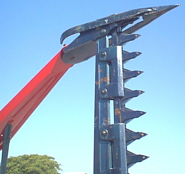

The double action setup is where the guard bar and the section bar both move. The tolerances are close enough (15 thousandth) that you can't clog them. Ken Sweet

Here are some closeup pictures of the double action cutterbar setup. Ken Sweet
