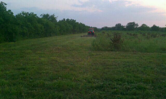

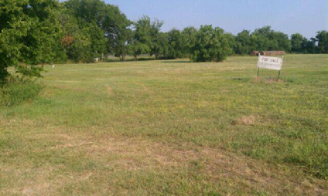

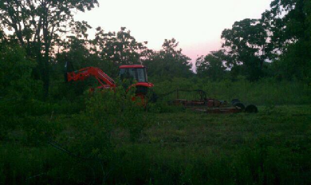

I've been pulling a 15 batwing with my M7040. If I am mowing brush as tall as the cab, I run in low 2, otherwise I mow in low 3 or low 4 depending on how tall and thick the grass is.
This was mowed in L3
This was mowed in L4
