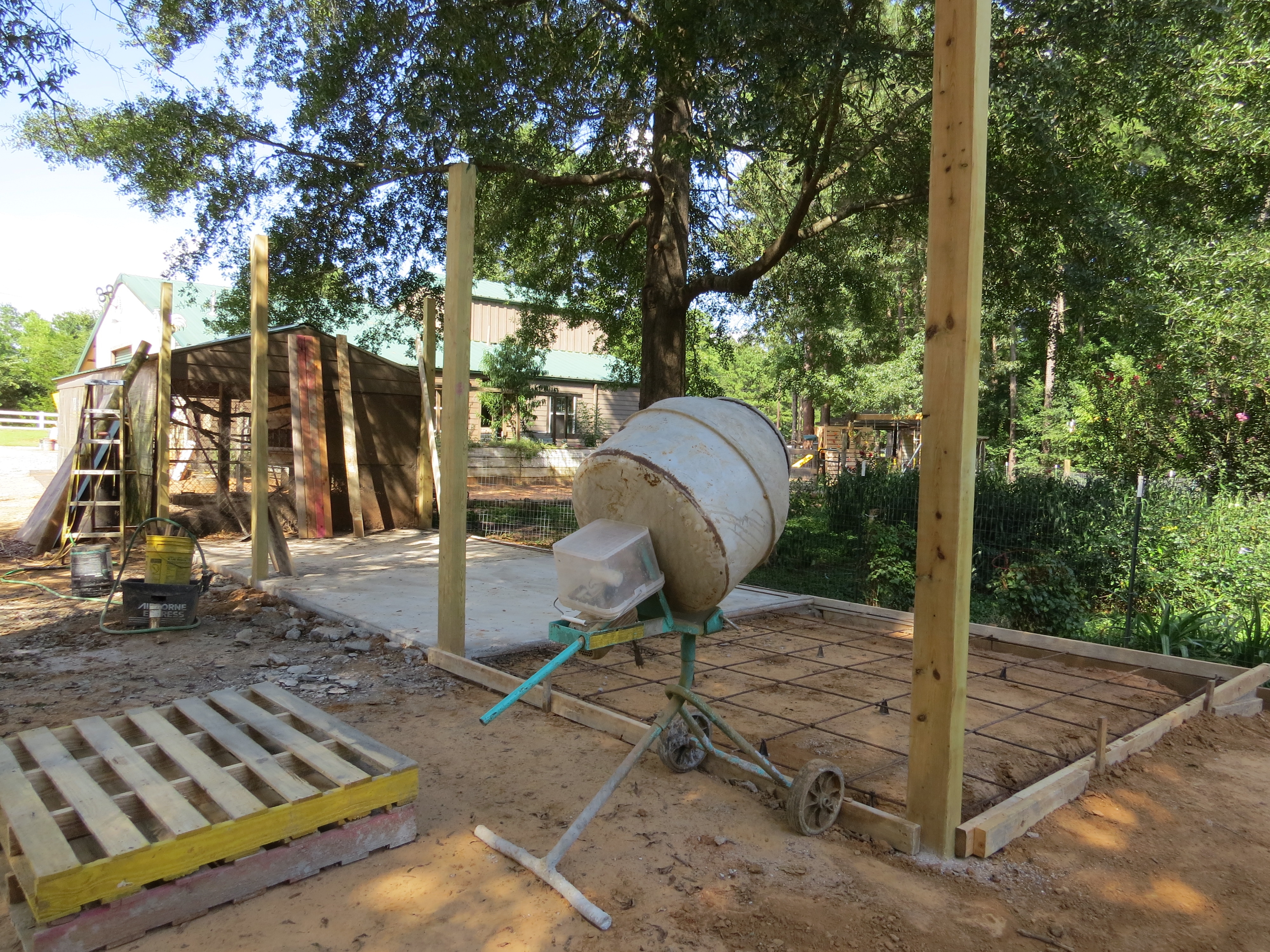

How big of a slab could I do by myself?
   / How big of a slab could I do by myself? #21
You can make as big a slab as you like. Just pour it in manageable sections of 10x10 or whatever fits modularly with your design. The cold joints will serve as expansion joints thus limiting cracking. Use rebar throughout tying all the sections together. GL

So, general concrete advice.
Don't pour when you have sub 40 degree nights in the next 24 hours.
Don't dump the water too it too much.
Double and triple check everything first, But have some more stakes, nails, and a maul ready for if you have a form bow.
Expansion joint against any rigid point, such as extieor wall, posts, ect; you can caulk over the expansion later to keep ants out.
Rubber gloves aren't a necessity, but they do make it nicer.
I like wire, but this is all interior, and you may obmit if you prefer.
Clean you edger, floats, ect as you go.
Keep a 5 gal bucket of water around to sprinkle as needed while finishing
Visqeen helps keep the soil from wicking the water out of the mix,
   / How big of a slab could I do by myself? #23
More general advice. Don't put the steel on it too soon. Steel seals the surface reducing evaporation. I did this once in cold weather and had to finish the sidewalk in the morning. A tamp can push the gravel down making it easier to get a pretty creamy finish but this leaves a weaker top. An early bull float can knock the rock down just a little making finishing easy without compromising the top as much. Finishing is an art, a lot of the success depends upon timing. It's important to get all the mud down in a timely manner ideally at the same time, so your not trying to float old mud and new mud at opposite ends of the pour. So size your sections accordingly.

   / How big of a slab could I do by myself? #26

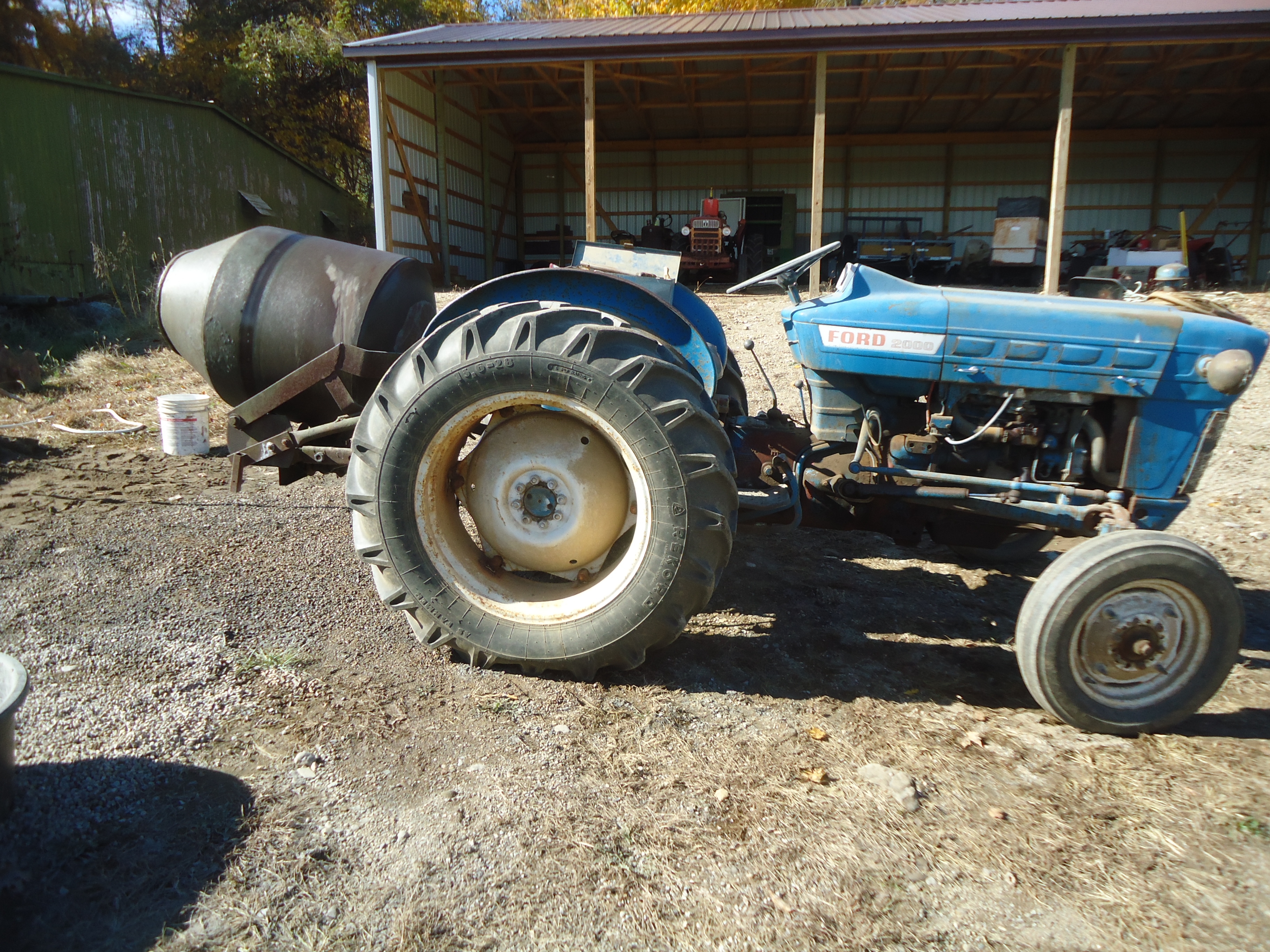

I bought this little 3 pt. PTO hyd. dump mixer that was well used around 30 years ago. I can't tell you how many little jobs I've done with it, but it has paid for itself many times over.
I was taught many years ago using the 1-2-3 method for a 5 bag mix per yd. On larger slabs I make it a little wetter than normal to allow time to finish it. But I also add 1-1-1/2 extra shovels full of cement to make up for it probably pushing it up to around an 8 bag mix.

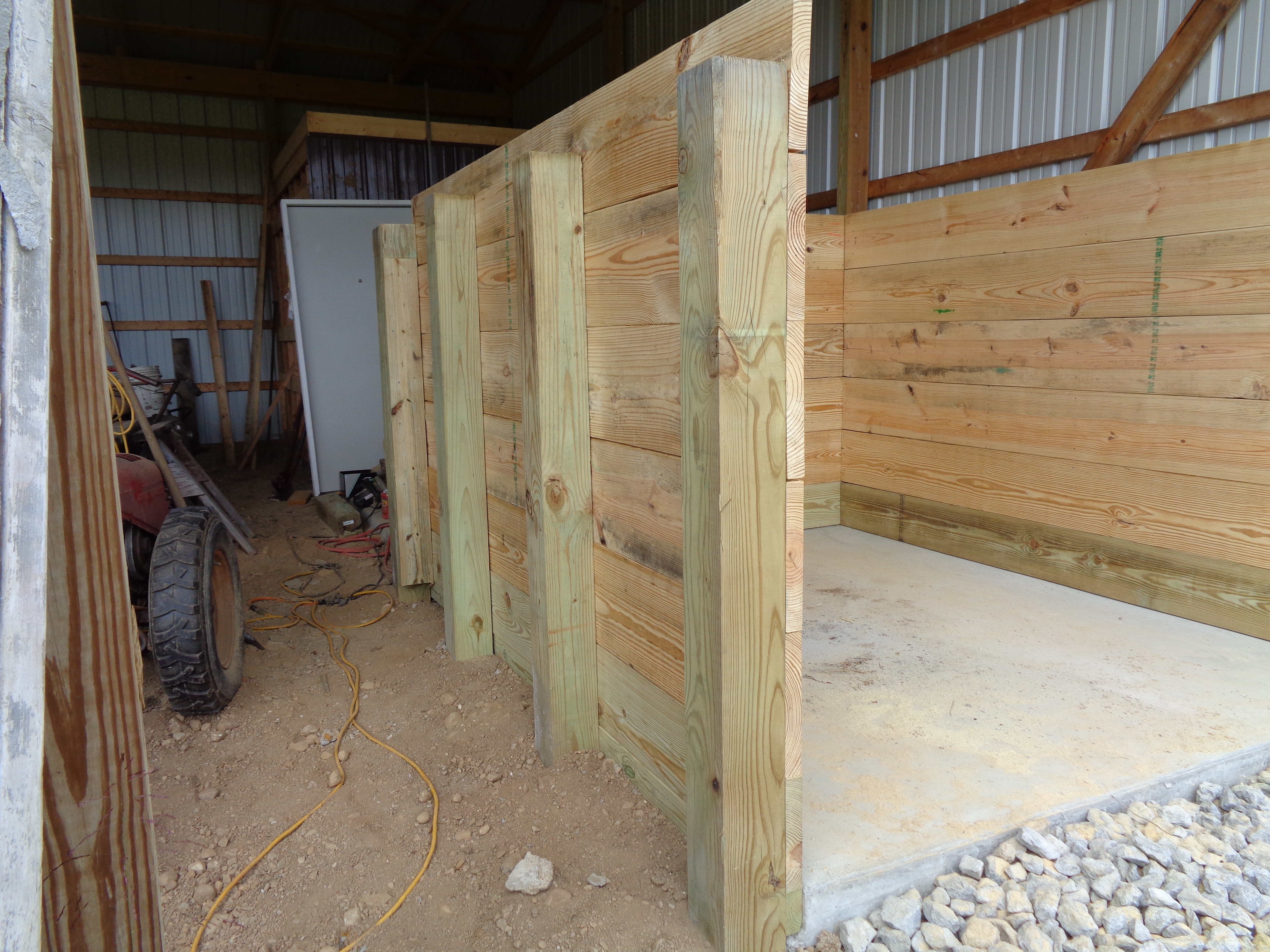

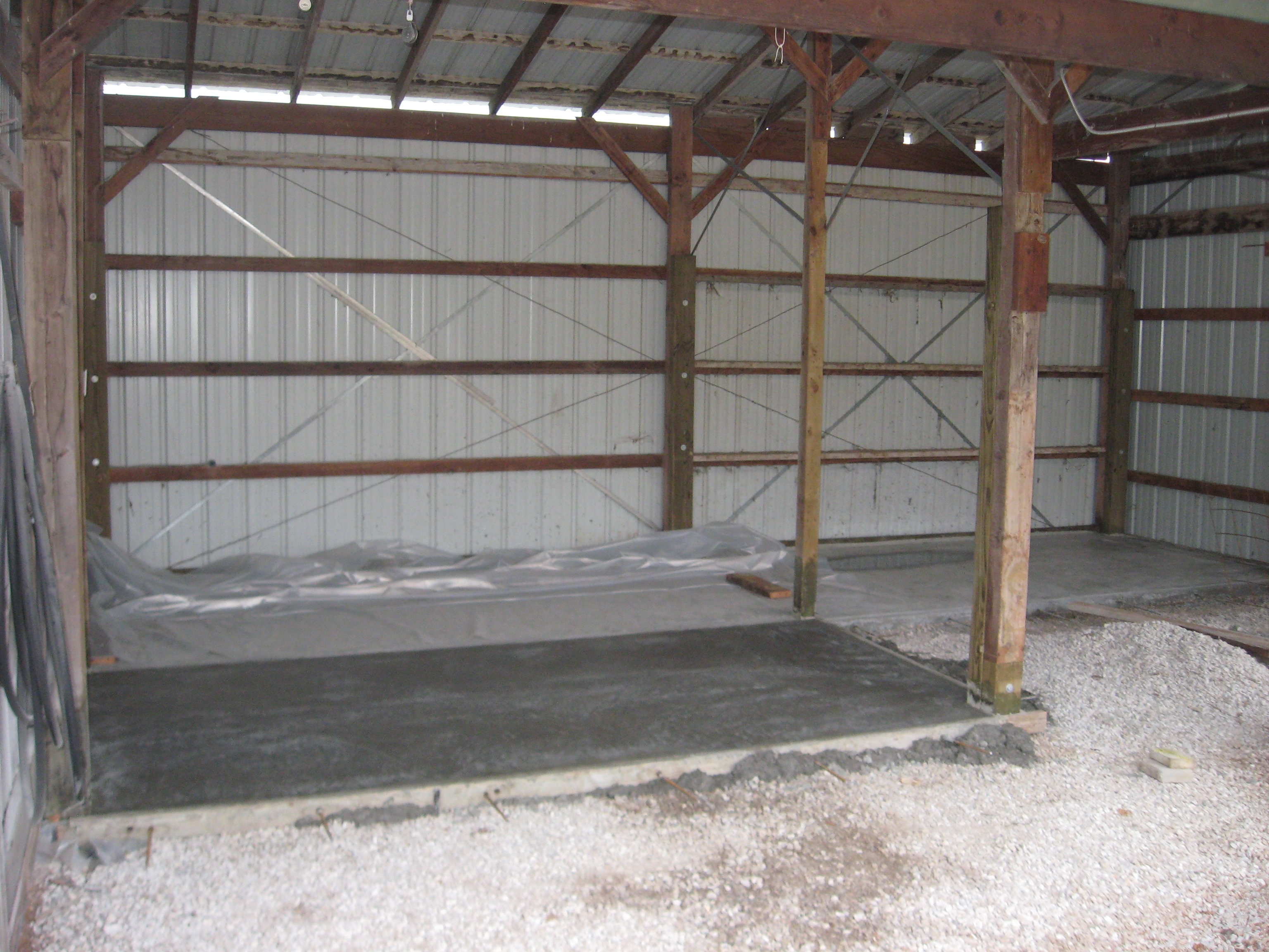

The last sizeable pour was in my machinery shed where on one end I poured an 8' X 36' slab to build a storage room for spare parts (you can see it in the background) space to set 3, 275 gal. fuel oil tanks to store used motor oil for my waste oil furnace for the shop, and lastly a coal/wood storage bin for a wood/coal stove also in the shop.
I poured these in 8' X 12' sections. I drove 16d nails in the band board at the level of the top of concrete, put a level on a straight 10' 2X4 to set the top of the outside form, staked & nailed in place.
In the end section form I drilled 3/4" holes every 2' and put 5/8" rebar in through holes leaving them stick out about 6" to tie the slabs together.
I'd bought a cheapie concrete vibrator from Harbor Freight a few years before that for another job pouring new walls and top for my well pit. For the money it does a great job and helps to get air bubbles out along the form edge. Most was pushed pulled around in place with a heavy-duty lawn rake. A little up and down tamping with the rake action to move/level concrete a bit. Rough screeded with a 2x6 w/handles cut in it like the concrete guys use, then ran my bull float on it. Let it set for a while, then ran a magnesium float on it, then a bit later finished with a steel trowel, then ran the edger. That was enough work in a day at my age and not completely wear myself out knowing I had 2 more of the same to do in a week.
Next day, pull the end form, put in the next section of side form and start to pour again. A lot of work for one person but doable.
That pour was 8 years ago this Summer, and to date no cracks. Oil tanks are right at the 275 gal. capacity, so right at 6,000 lbs. setting on a 8'X12' section. There's approx.10 tons of Industrial coal in the bin, plus some firewood since I added a removeable end using 12" planks. I did put a 2% slope on that part so water would drain out if we'd get a heavy rain from the East. Showing no cracking makes me feel pretty good about that job.

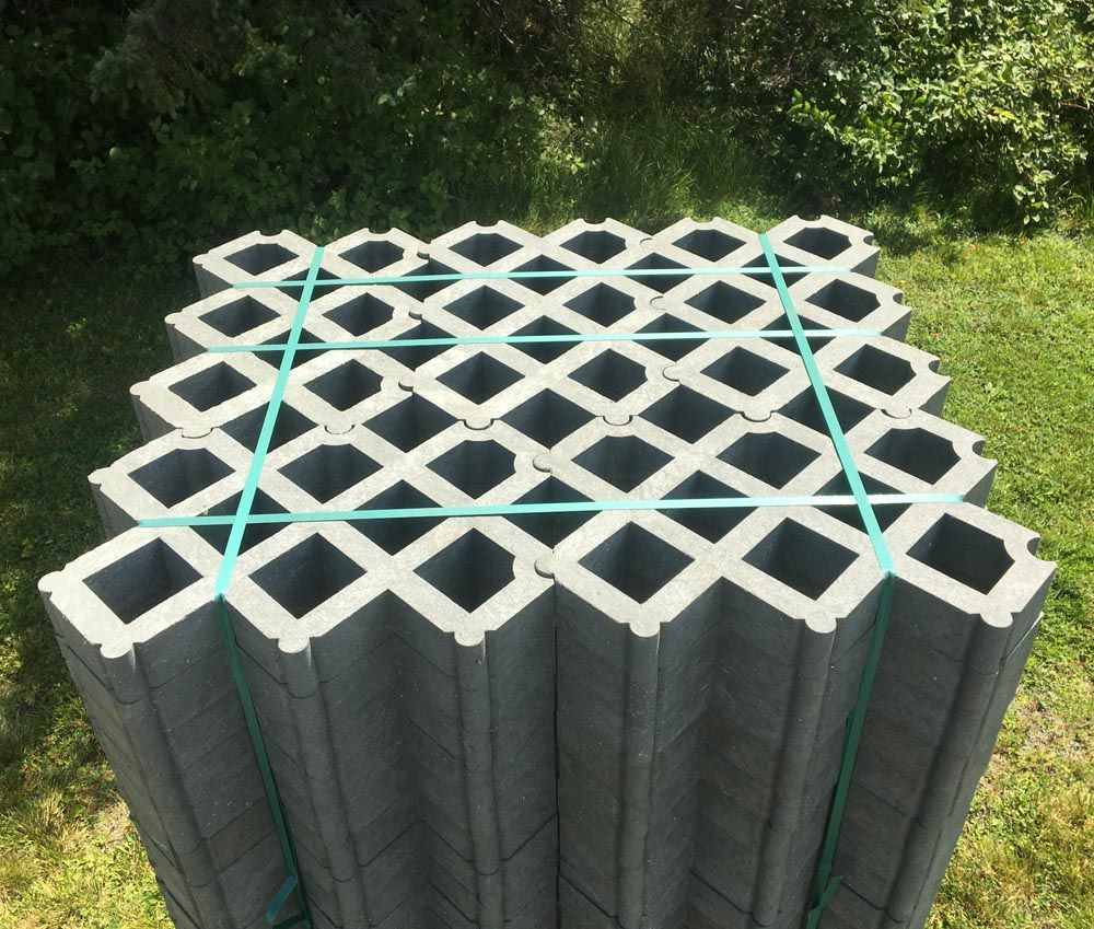

Do you have your heart set on concrete? If all you want is a fairly smooth stable floor, you could do what my FIL did.
He had a 20' x 30' steel building on a fairly remote section of the farm. It was accessible only by tractor and used to store implements. It had a level stone floor but he wanted something smoother. Costs estimates to do concrete were very high due to the location, so he used this product instead.
He brought in sand with the FEL, used it to choke off the stone and raked it level. He then brought in the pavers, laid them out and filled them with stone dust. He soaked the surface with water and it dried hard and fairly smooth.
That was 5 years ago and the surface has held up well under heavy equipment. It cost significantly less than concrete and he was able to do the job himself in 4 days.
I like the look of it but wouldn't consider it for a finished garage. For an out building though, IMO, it's an acceptable alternative to concrete.
   / How big of a slab could I do by myself? #28
I set up some forms for 2'x2' 2x4s and use any excess to make stepping stones. I have a pile of them in the woods. They come in handy for things like corners in a fenced yard where the dog would stand and bark. Keeps his feet dry and the corner doesn't get muddied up. Good for footings for yard art. Bird bath, etc...
I made mine 18"x24", 4" thick and use them for weights on a lawn roller.
#29
I like the idea of doing pavers, I could see that being easier.
But my biggest objection to the gravel floor that's in there now is that it's not good for working on the tractor. If I drop things they get lost, and crawling around under the tractor is uncomfortable. If I spill something I can't wipe it up. It doesn't seem that pavers would address any of those complaints.
