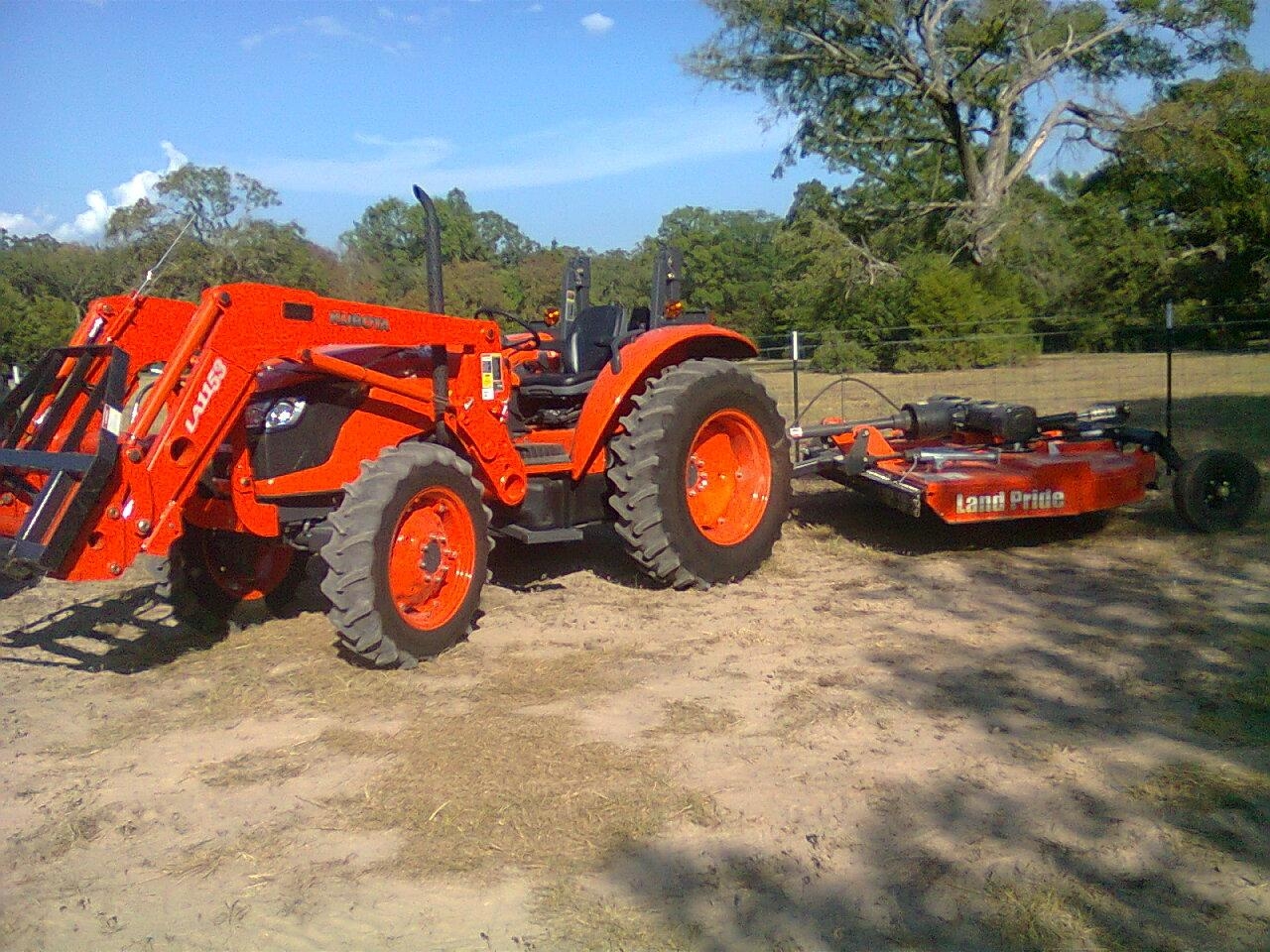

Congrats on the new tractor. I've been looking at Kioti & Kubota and had spec sheets downloaded already. Don't take my comments on the trailer too seriously, as I'm not an expert. I do think the numbers below are pretty close though - hope this helps.
3968 = DK50SE - Overall L = 134"
1100 = Loader (est) - Addt'l L (est) = 40
1046 = Land Pride 72" RCR2672 - Overall L = 126
634 = Fluid (est) 13.6-24 tires 317 lb ea
200 = Chain, hardware (est)
6948 = est weight
25' = est overall L (this seems long to me, maybe I'm missing some overlap?)

Moss,
1046 = Land Pride 72" RCR2672 - Overall L = 126 634 = Fluid (est) 13.6-24 tires 317 lb ea
6948 = est weight
Wow, that landpride tailwheel sticks way out there:confused2:
Probabally more than most 6' hogs.
My bushhog model 306 6' cutter (comparable to the LP) is only 113". Over a foot shorter.
And if the load will distribute well on the trailer, you can leave the tail-wheel stick out back off the trailer with no problems.

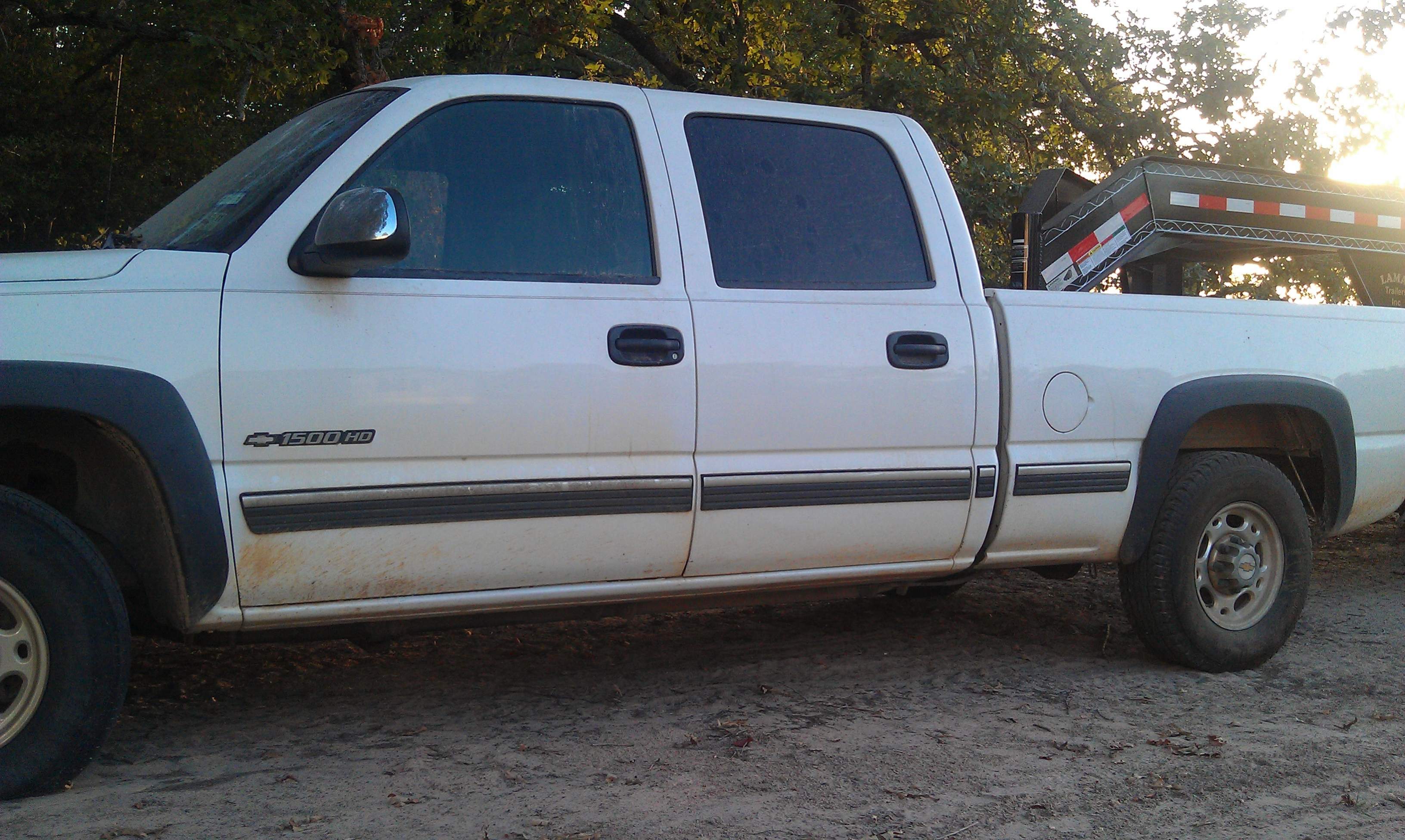

1500crew.jpg 2004 heavy/half 6.0gas is what I have been using to pull my tractor3.JPG trailer is a 24ft flattop gooseneck twin 7000lbs axles I just back on the trailer so tractor is over axles,pulls fine(70mph) truck has over 350,000miles:thumbsup:
