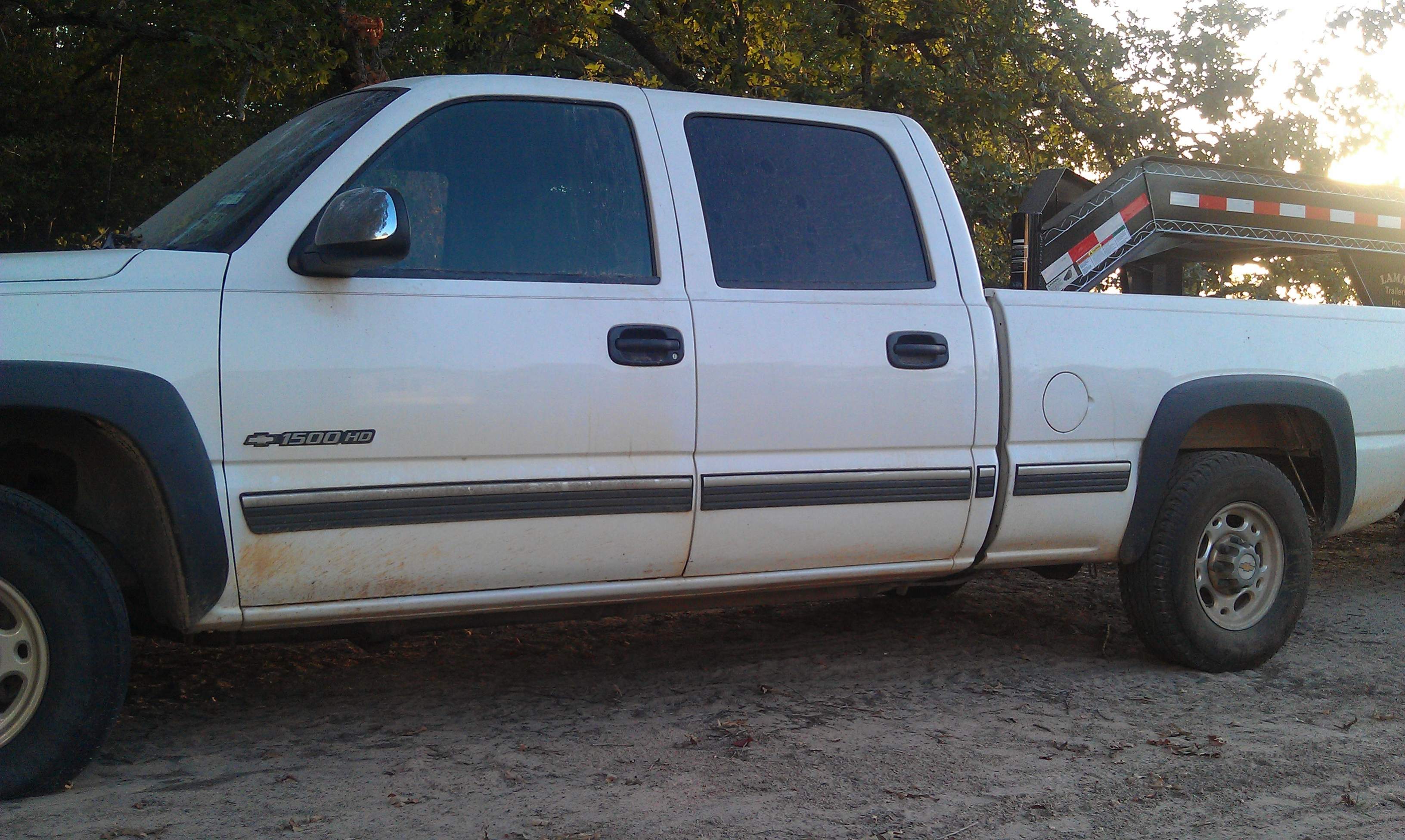

View attachment 226554 2004 heavy/half 6.0gas is what I have been using to pull my View attachment 226557 trailer is a 24ft flattop gooseneck twin 7000lbs axles I just back on the trailer so tractor is over axles,pulls fine(70mph) truck has over 350,000miles:thumbsup:
Your truck and his truck are not in the same class. The GM Heavy Half with the 6.0 is basically the same truck as a 3/4 ton 6.0L GM. Slightly lower GVWR is about it but if I remember right it actually had a slightly higher tow rating then the same year 3/4 ton GM. Had a full floater in the rear, large systems, brakes, ect. Yours is not really a 1/2 ton.
Ford had the same thing. They first called it a Light Duty 3/4 ton and it looked like a F-150, not a F-250. It was later and is still called the F-150 7700. It has 4.10 gears and a 7,700# GVWR. Just like the GM it has a full floater, bigger brakes, larger systems, ect. It would actually tow more than the same year F-250 with the 5.4L and 8,800# GVWR because it was nearly 1,500# lighter of a truck. These trucks were not really a 1/2 ton either. I had one and it was probably my favorite 1/2 ton Ford I had of all them I have owned.

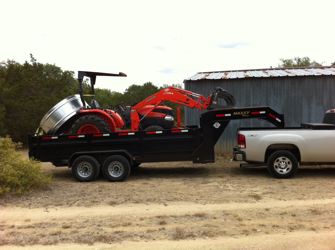

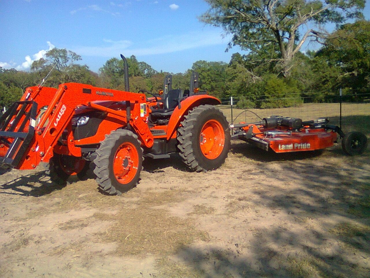

Here is the setup I use that has proven to be a very flexible setup.
Kubota L3940 with third function, grapple bucket, loader bucket, box blade, 6 shredder with water/sealant in the tires
GMC 2500HD with Duramax Diesel and 6 speed Allison transmission (AMAZING) and a high end electric brake controller
Maxey 16 Gooseneck dump trailer with 2 7,500 lb axles with electric brakes on both axles
Here is a picture with a the setup. The loader bucket is actually on the bottom of the trailer in front of the tractor and I let the grapple lay on the gooseneck as you can see. The box is on the tractor in this shot, but when I do load the 6 shredder it just hangs out the back a bit.
This setup tows fantastic and most importantly it stops on a dime!!!
The dump trailer has proven itself time and time again with 100 uses I never intended it for. The 2 sides prevent you from overloading it with anything too heavy.
Good luck, Mike
