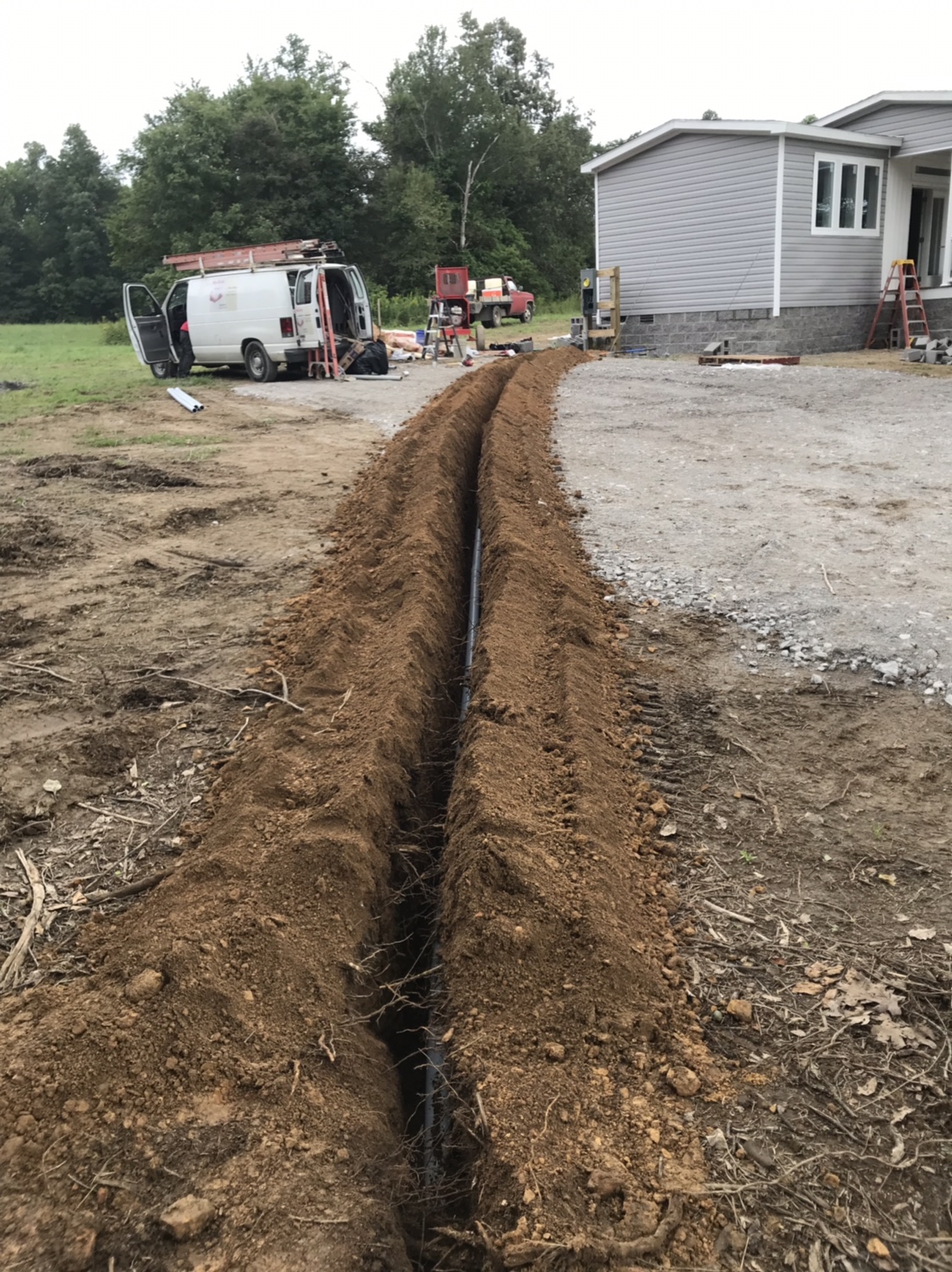

I would agree that a solar panel and a battery would probably be good enough and a lot cheaper. But they’re wanting a dusk to dawn light wired on the barn at the same time. If I get the job I’ll put my ditch witch to work. Depth isn’t a problem. IMG_9045.JPG

Do you know if this is a standard swing gate or some kind of ornate heavy iron rolling gate? That could make a big difference in power requirements.

i have dug so many miles of wire tranches over the 30+ years as an electrician ... i have no idea how many miles worth. on my own property i have a chart showing where trenches are. most are actually 5' down as i dug 1 trench, installed water line, 2 feet of dirt, then conduits for electrical and phone and internet plus spare conduit. i have trenches all over the place....300 feet from house to shop, 300 feet from house to barn, 300 feet from shop to arena then arena lighting and outlets, another 200 feet between shop and carriage barn. then add in the wifes greenhouse and potting sheds needing power .... one if 50 feet from barn, the other is about 150 feet from main panel. plus landscape lighting all over the place, front entry planter and lighting, pipes across the road to an additional 10 acre parcel for the horses for hot wire fence and winter water heater. man i cant believe all the wire ive run over the past 24 years here. no wonder my back hurts.
i never bother with ditch witch. i have to use mini excavator due to rocks. ive never doug out any buried power lines on my place. i have hit them on other peoples jobs when the idiots placed their conduit 4" below the surface. i always install red alert tape within 4-6" of surface when backfilling. ALWAYS
That is really great advice! I wish I would have done that on my property where I have installed wire and water lines. I think I will draw them in on my plot plan for the next owner.

the tape works great...but i also own a underground wire locator if all else fails. pretty good at guessing depth with the machine also. very accurate locator but i sometimes pick up a transient signal
