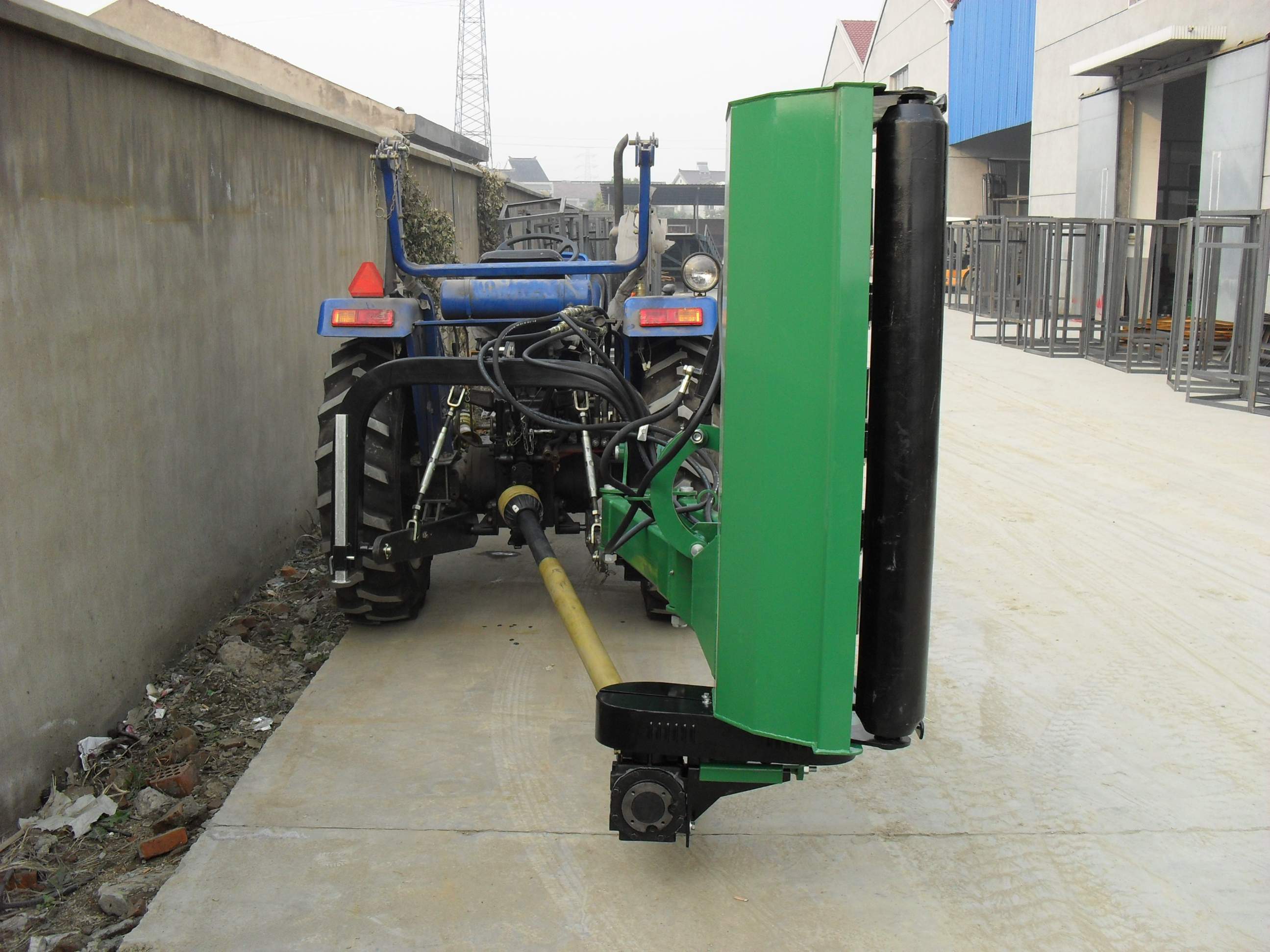

I want to buy a verge flail mower (off set flail mower). I met a supplier through ALIBABA. But I have a problem. Suppliers have not given a correct solution for the matter.
I choose the BCRL-145 verge flail mower. Suppliers supply only four hydraulic hoses and the mower.
I have a Massey Ferguson 135 tractor. I want to attach the mower to it. But there is a one hydraulic out let. How can I attach this mower to my tractor?

Here is the picture of BCRL-145 verge flail mower
It has two hydraulic cylinders. Flails are driven by PTO shaft. There are four hydraulic hoses to control hydraulic cylinders.
Massey Ferguson tractor has only one hydraulic connector to connect trailer lifting cylinder.
I think I must use two hydraulic control valves to control cylinders. How can I get the hydraulic pressure?
Thank you

You need a 2 spool valve to control 2 cyl.
Do you have a remote valve now?

If all you have now for hyd is the pump, hoses and 3pt, then you need to add a two spool valve with PB in series with the hyd flow.
Typically the flow would go like this with a remote valve.
Pump to IN port of 2 spool valve, OUT port/return of two spool valve would go to tank, PB out would go to the 3pt .
On the work ports, install QD's, and then just plug in the hoses for the two cyl.
Check and set the relief pressure.

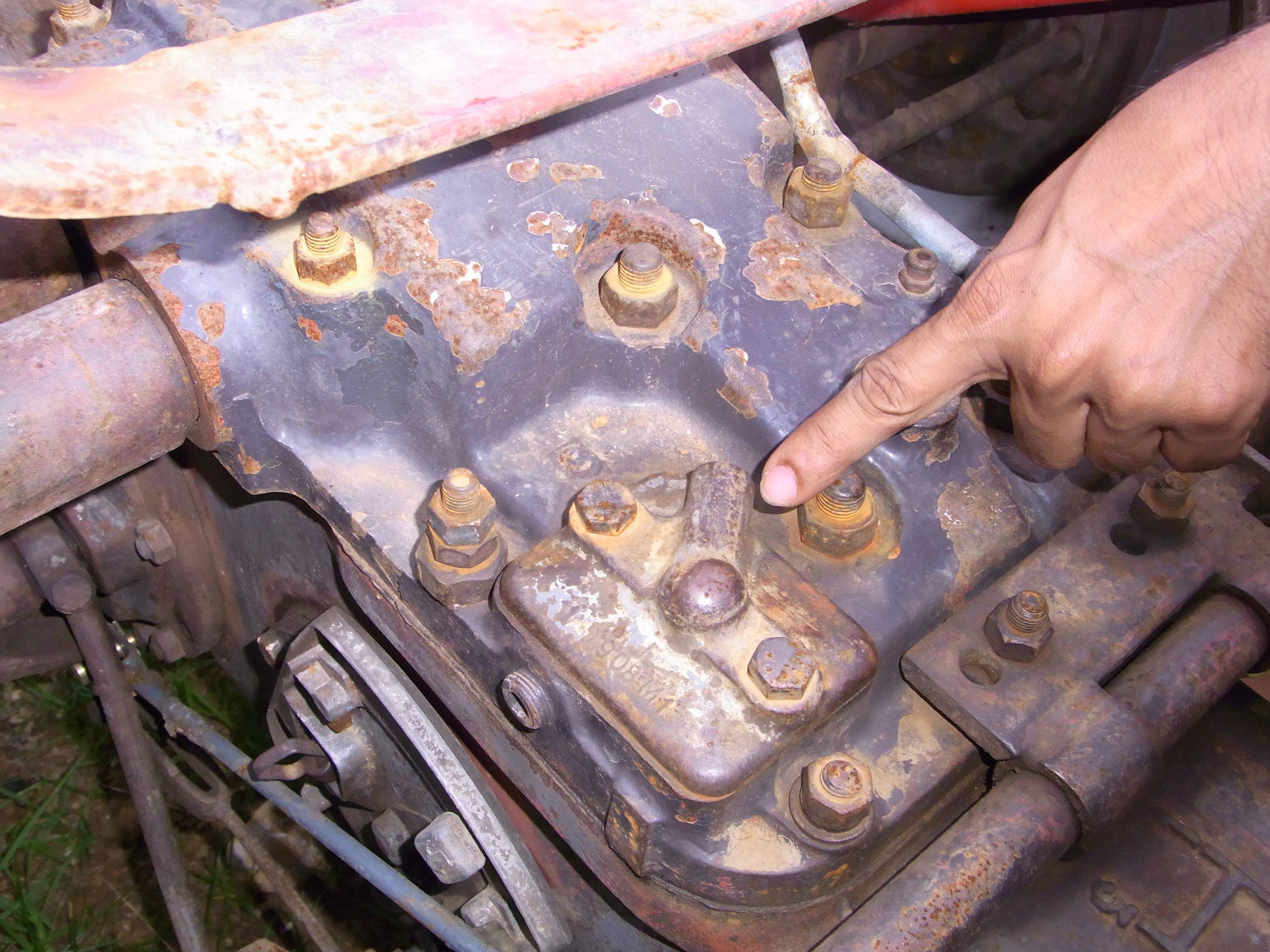

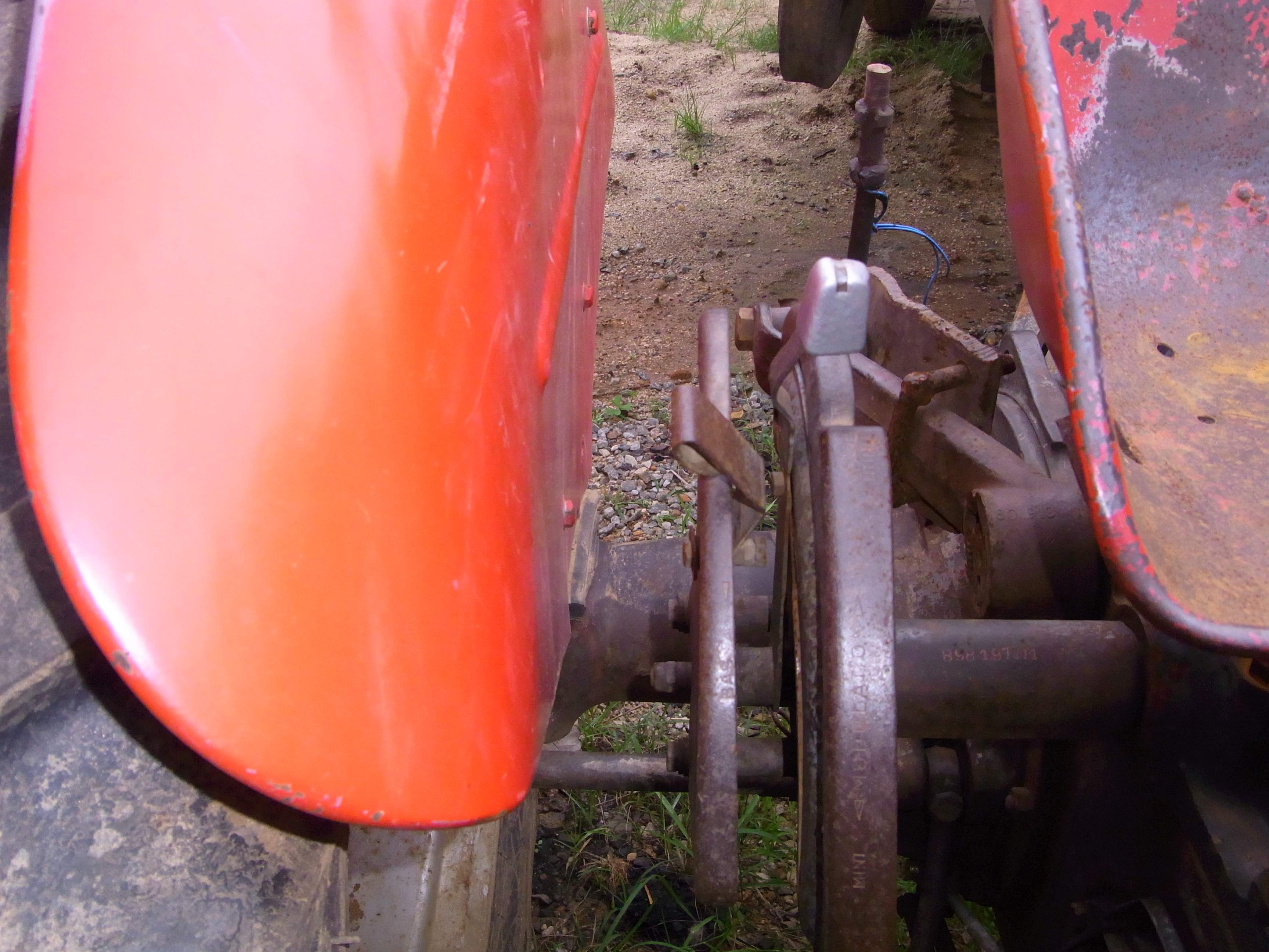

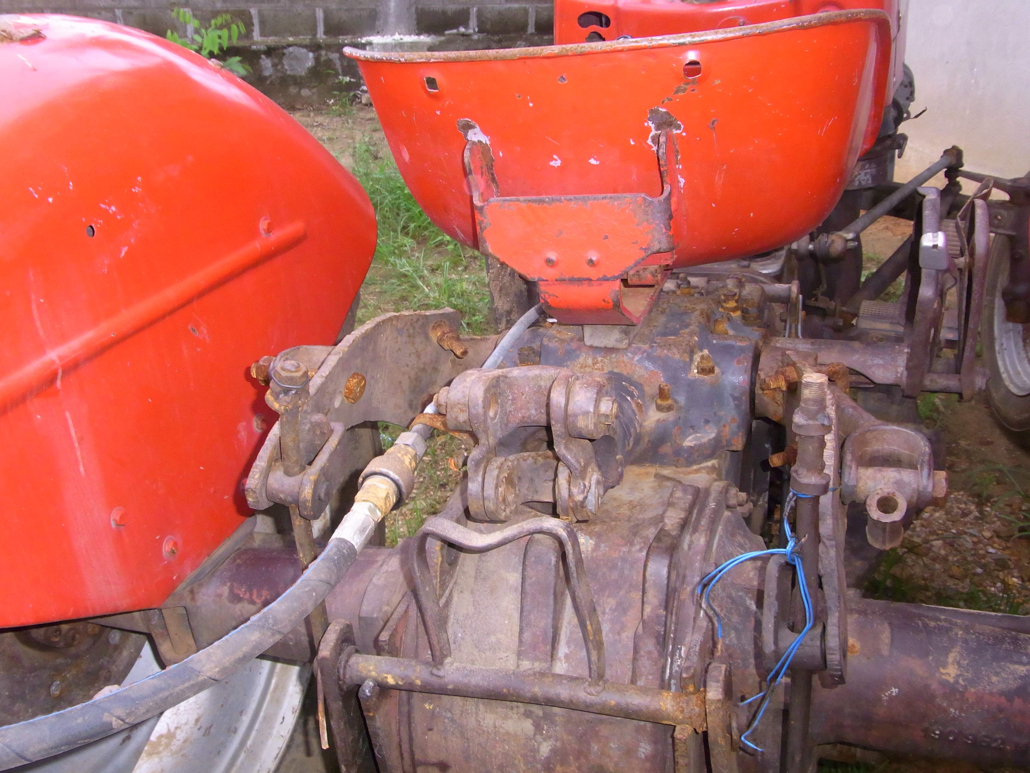

I learned so many valuable things. It is a great help to me. Now I must tell you the truth. I have never seen a verge flail mower except photos & videos. My profession is civil engineering. And I am a part time highway & irrigation maintenance contractor. As maintenance contractors we have to clear growth of road sides & tank bunds. Still we are doing it manually. I am trying to introduce flail mowers for that.
With your kind advices now I have a primary knowledge. I am happy, now I have friends to ask for a help. Thank you steve (BukitCase) for your links. I used them to learn so many things.
I am sending an attachment of photos of my tractor. I am sorry to say I did not use it for any purpose except dragging the trailer. Today I inspect it to get an idea to couple a mower. I noticed I haven’t maintained it properly. I must repair it immediately.

Bandara, you're very welcome - helping others (or getting help) is the reason most of us belong to this site so don't hesitate to ask, and if you are not sure what something means just say so -
Speaking of that, I'm not seeing anything that looks like a complete 3-point hitch on your pictures - can you take a few more, especially one that shows everything from the top of the tractor seat to the ground, and everything from outside of one rear wheel to the other? I'm concerned that your tractor may not have the necessary pieces to use ANY 3-point hitch implement.
One picture shows a SINGLE quick disconnect and hose going to the rear - can you tell what the purpose of this is? I would guess it is controlling a single-acting (probably lift only) device of some kind, but this is normally done with the actual 3-point hitch I'm NOT seeing... Steve
Oh, one more thing - do you by chance have any kind of manual for your tractor - either an operator or repair manual? This may help to locate where the hydraulic pump is located (MF does things a bit different than some others) - because sooner or later, you will need to trace your hydraulic system (and take more pics) to see if this project is possible at all, or just difficult (like they ALL are) :laughing:
