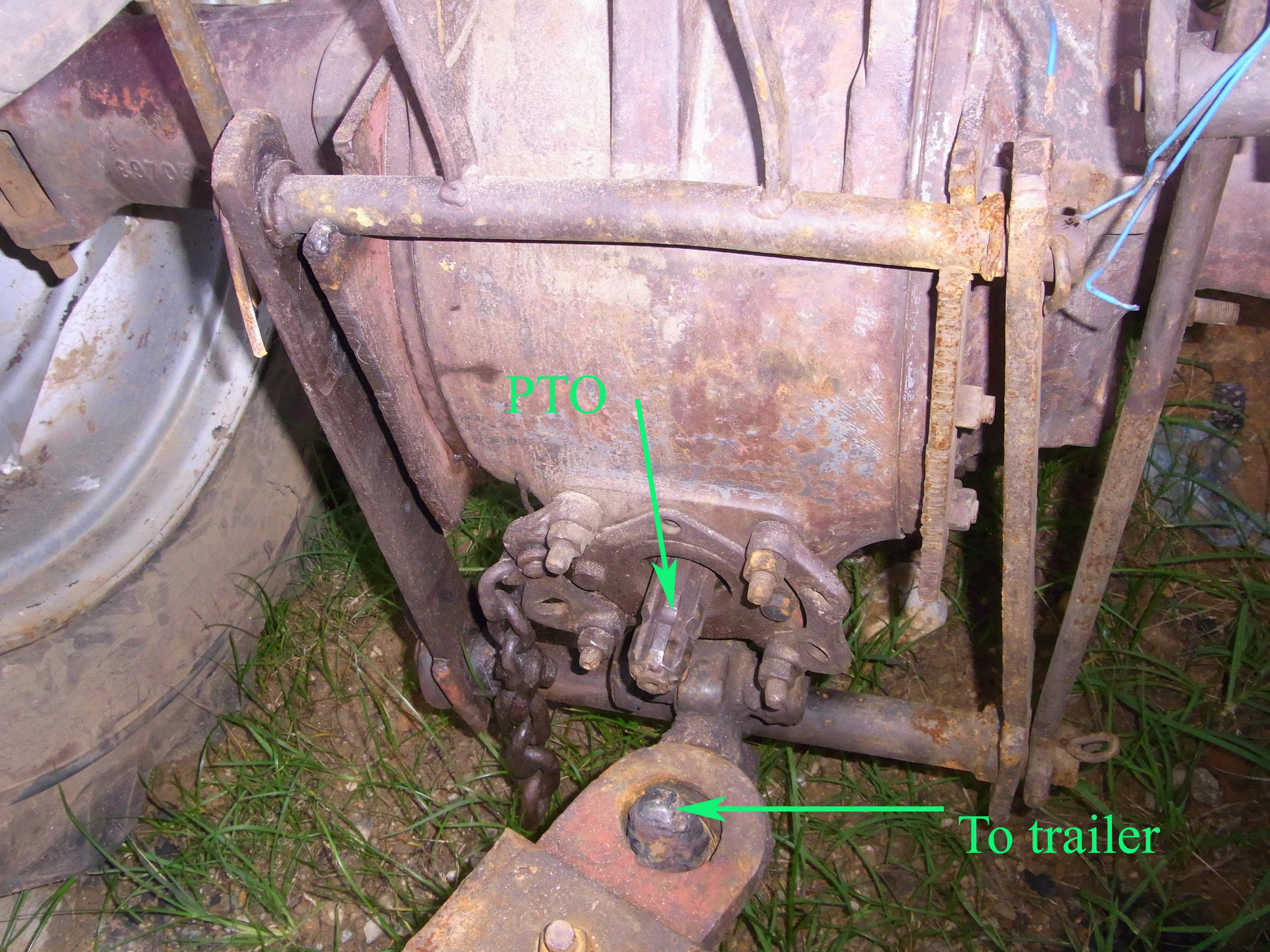

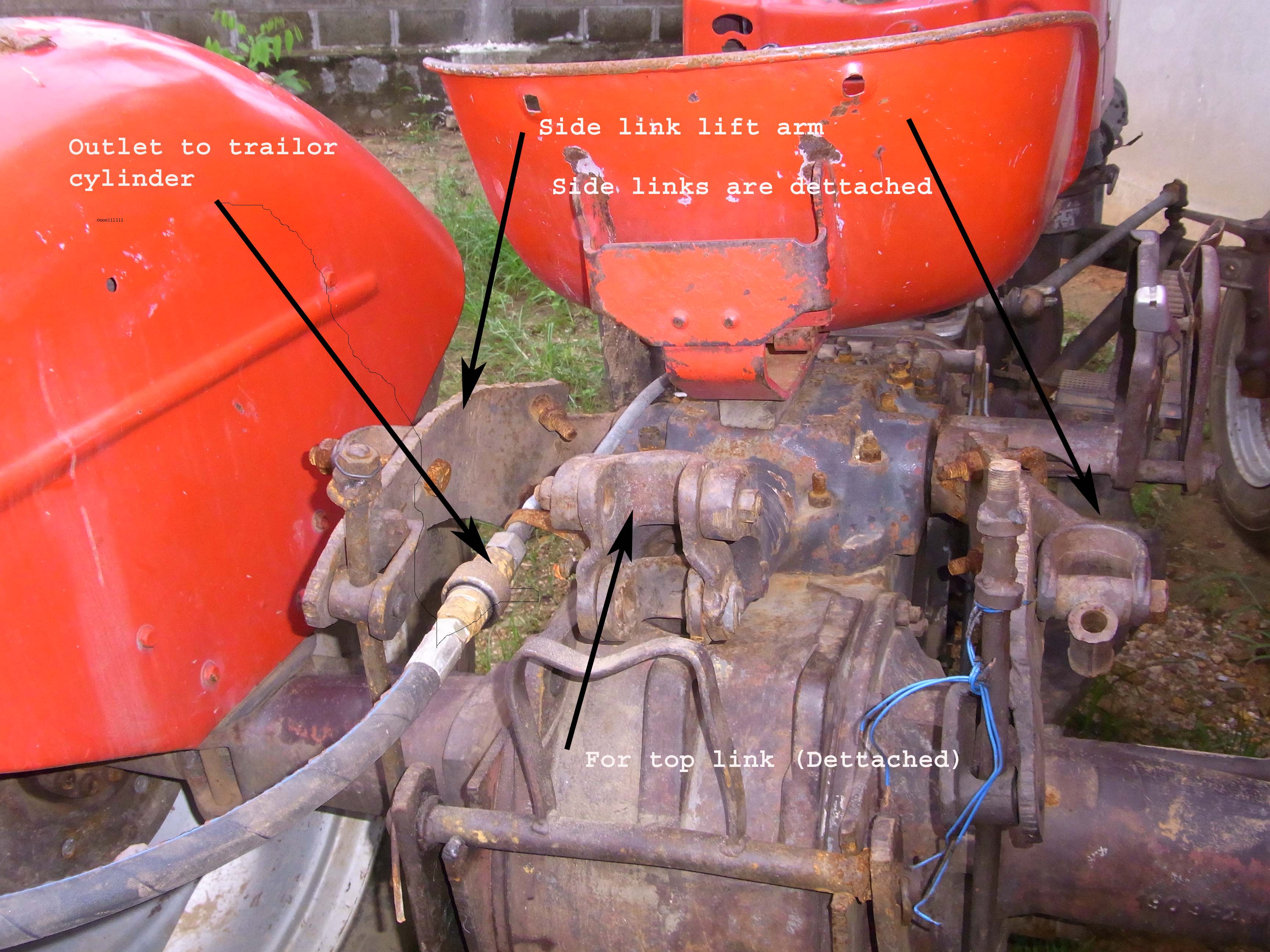

Dear friends

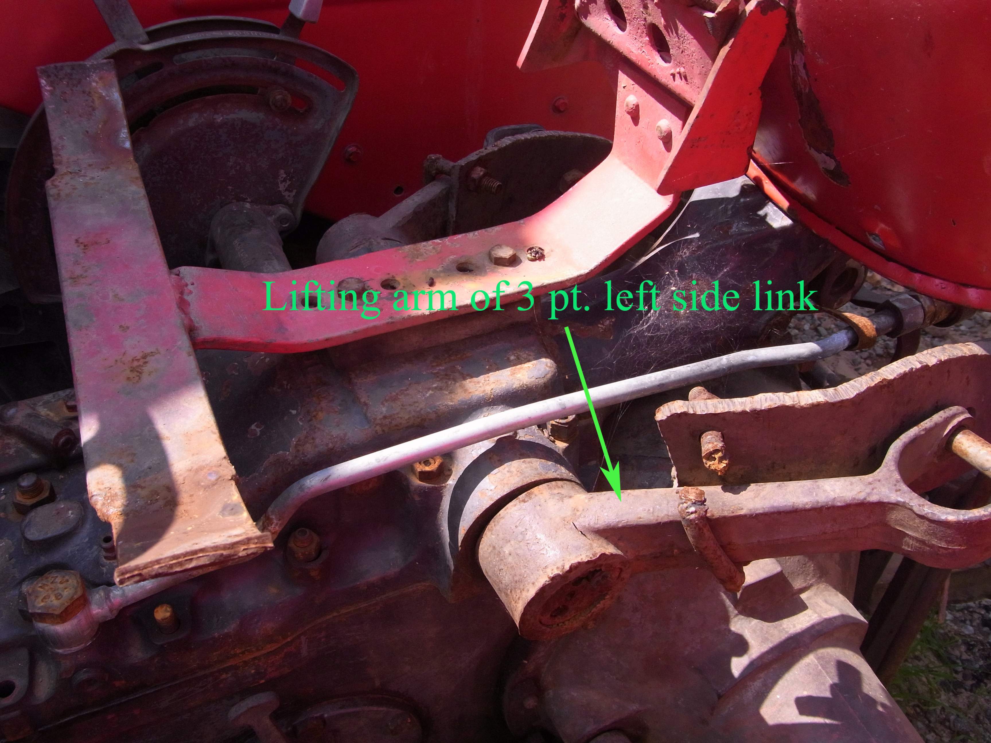

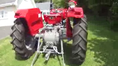

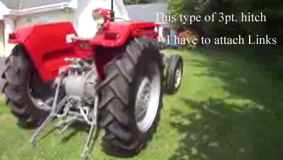

I am here with sending the photos of my Massey Ferguson 135 tractor. And you can read the PDF of MF hydraulic manual by following link.
Thank you very much.
http://www.google.lk/url?sa=t&rct=j...x9oHx7pxv1KzowDphtlJA&bvm=bv.1357700187,d.dGI
Bandara.
MF 135 (1) copy.jpgMF 135 (2) copy.jpgMF 135 (3) copy.jpgMF 135 (4) copy.jpgMF 135 (5) copy.jpgMF 135 (7).jpgMF 135 (8).jpgMF 135 (9).jpg

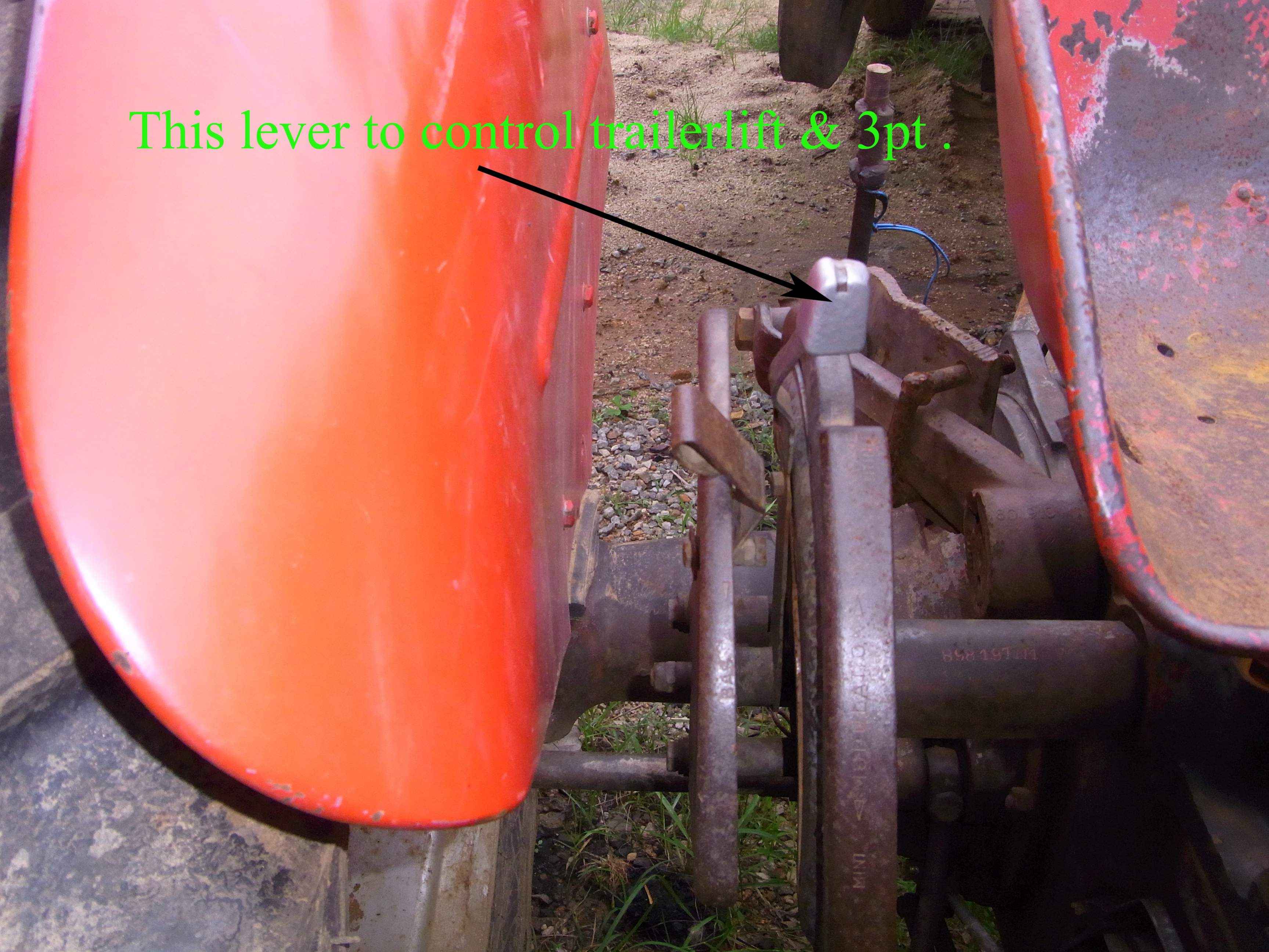

OK, just a couple more things - can you edit one of your pics to point to whatever you use to control your trailer lift? I'm thinking the smaller lever opposite the 3-point controls, but not sure.

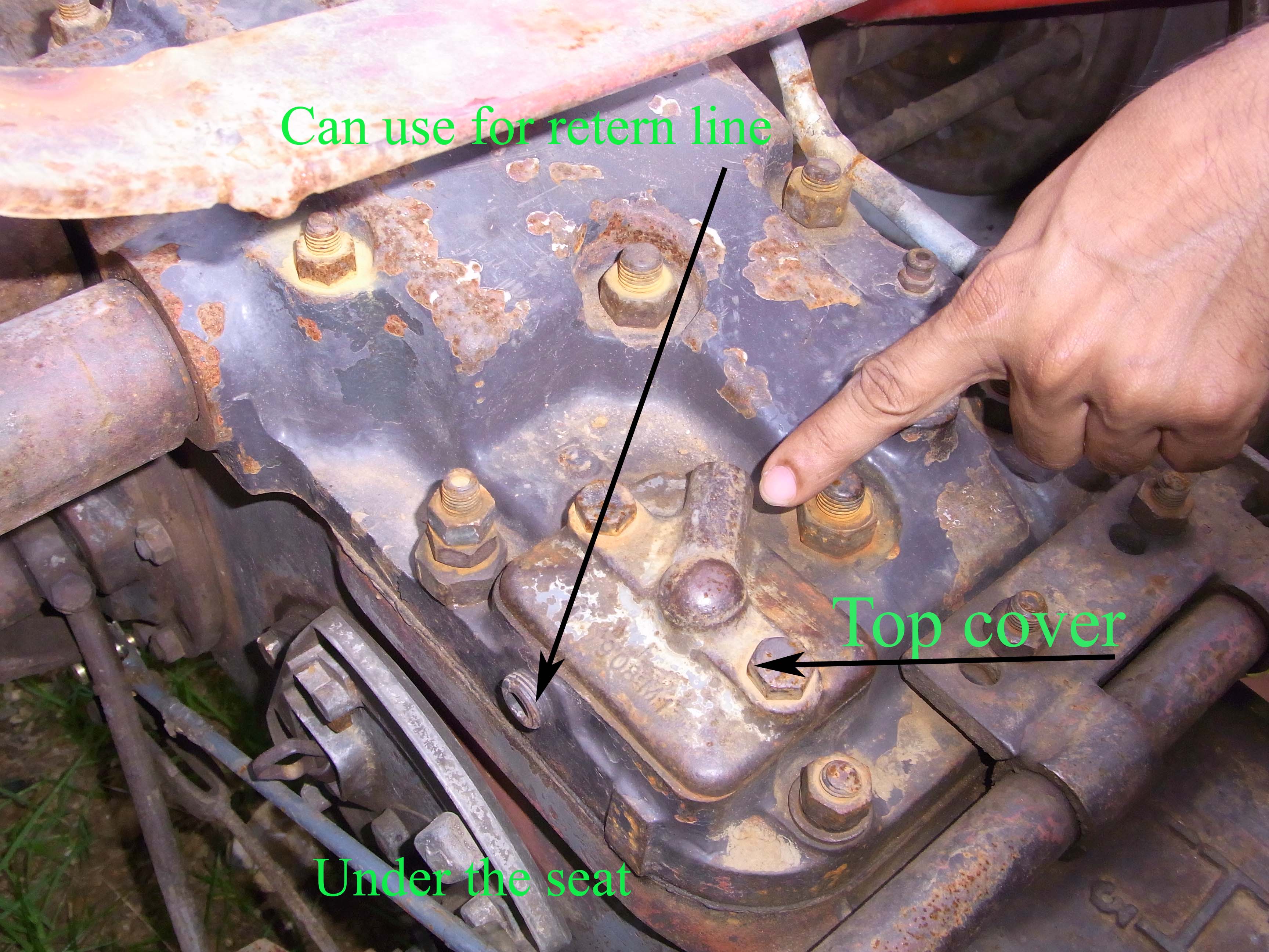

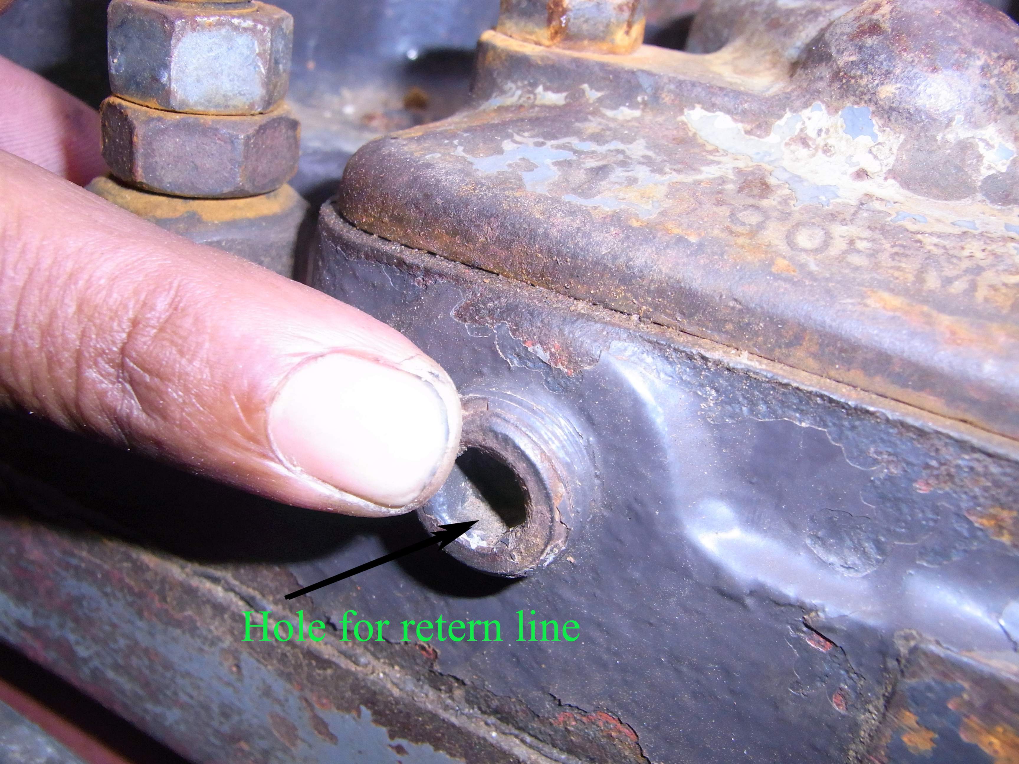

Also, the manual in the link has even worse pictures than one I paid for for my Allis-Chalmers, in other words pretty useless. I'm not at all familiar with Masseys other than in general, so we'll need to find your hydraulic pump (another picture please) and figure out where your hydraulic lines go from there - both the output, pressure line and the return line.
Your new valving will need this info so you can get it connected right... Steve
   / How can I attach verge flail mower to my tractor?
#13

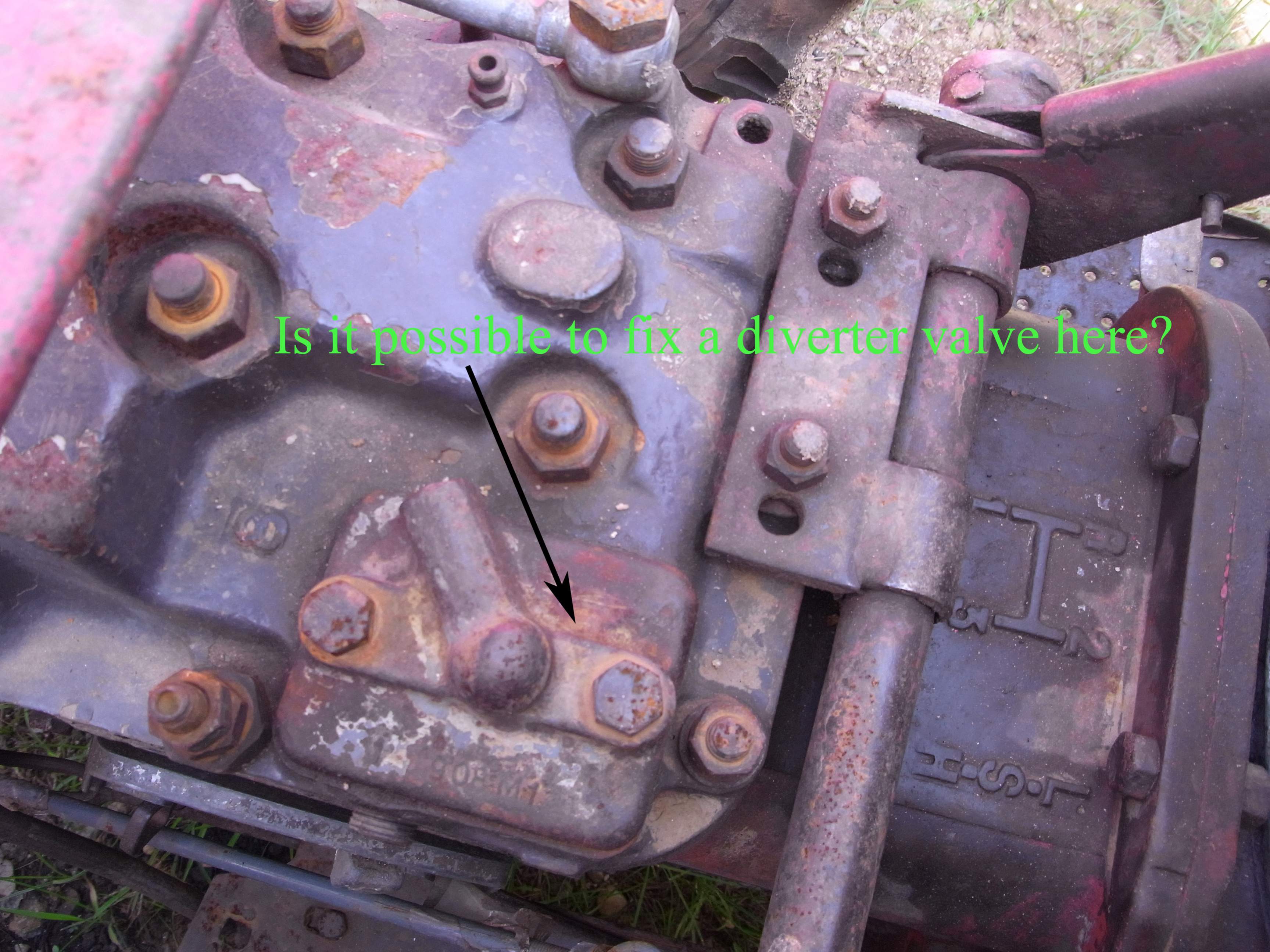

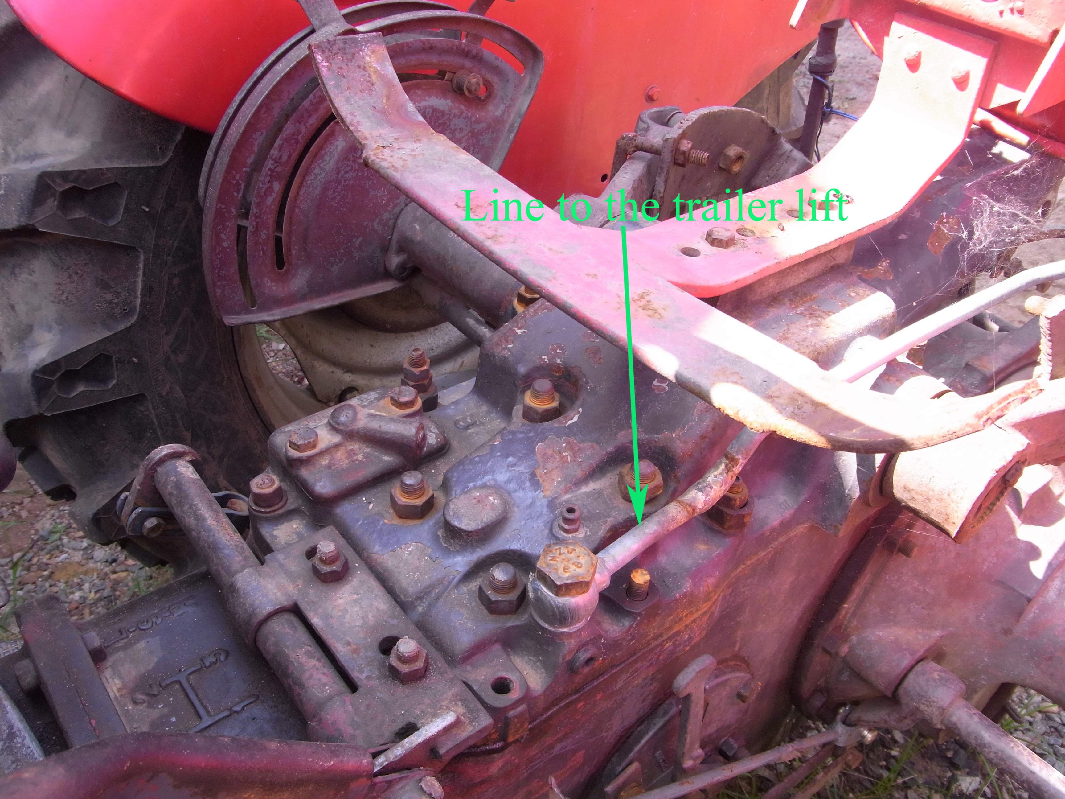

This lever controls both 3Pt.and trailer lift. Output and return come through the same hose. To lift the trailer the 3pt. must in up position. When the 3pt.in down position we can稚 get a pressure from the trailer lift line. Go to bellow link. My tractor has not a diverter valve like this.
Thank you
Massey Hydraulic System TS300 Hydraulic Selector, isolator assembly
   / How can I attach verge flail mower to my tractor? #14
If you trace the trailer connection back to the controlling valve they may have already installed a diverter valve. That part you referenced appears to be an add on to get additional hydraulic functions. You would have to use a service manual to find out where the panel the link references is located and how to install it.
   / How can I attach verge flail mower to my tractor? #15
The pictures are very poor, but it would appear that if you remove that plate you would then install a two spool valve and then have the ability to operate two cyl at the rear.
The two spool valve would sit where the cover plate sat, and two sets of outlets goes to the back with QD's.

Here are some options for a valve that will bolt right to the hydraulic cover plate. They are not cheep but they are easier than tryying to modify existing hydraulic tubes.
Remote Hydraulic Valve
   / How can I attach verge flail mower to my tractor? #18
Good find.
Looks like everything he needs to add on to his hyd system.
That double spool valve kit will allow you to operate a FEL, T-N-T, or operate two cyl on a wagon.
   / How can I attach verge flail mower to my tractor? #19
Yea the bottom one would do everything and it seems that the 3pt hitch would also work at the same time.
