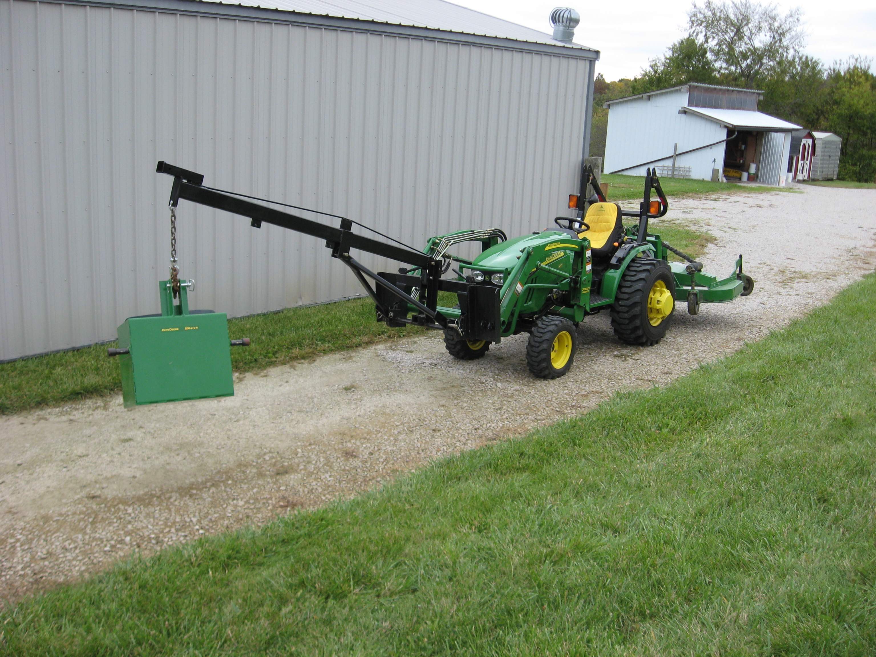

"Runner, what are the pieces you welded on each side of the drawbar used for? "
They, in addition to the holes in the part that extends upward from the top hook, are mounting points for three-point equipment that won't work with a quick hitch. I also use them to attach my boom pole.
Nice boom pole.!!
Curious to know how much it will lift being so far out front of the loader.??
Enough to lift a 500lb. attachment out of the back of th truck.??
I like it.

"Nice boom pole.!!
Enough to lift a 500lb. attachment out of the back of th truck.??"
Thanks.
Not to steal the thread (even though I kind of am, sorry) it's lifting about 500 lbs in this pic., however, if I was going load/unload an attachment from my truck, I would use my pallet forks.
I don't think the 2520 is capable of lifting 500 lbs on the end of the boom pole high enough to get it into a truck or trailer, but maybe it could.
Back to the subject, I've also thought about just strapping my sprayer to my carryall if I wanted to use it with the bigger tractor.
