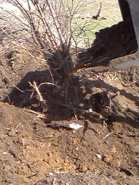

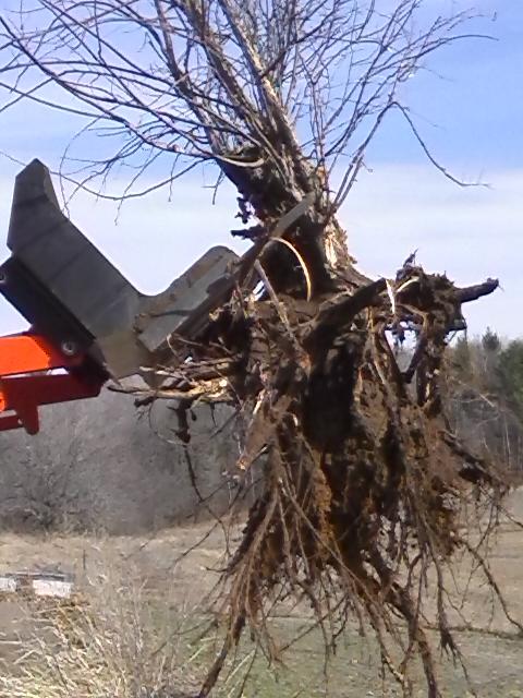

We have a town around here that to live there you need to be missing one tooth. Kind of a standing joke in the area. Were you trying to do something like what is in these photos?

This is why the tines on Loader Buddy are placed inside the plane of the loader arms. Loads are shared by both arms virtually eliminating the probability of tweaking your loader, while still offering the possibility of snagging a root one at a time while working your way around a stump. The visibility when working this way is good too. I have grubbed many stumps and trees in ten years and still have an "untweaked" loader. The biggest being a 2' cottonwood stump, took more than an hour but it went to the burn pile in the end.
