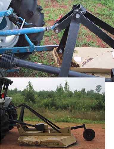

Harv et al, here are two pictures; the top one shows the "hinge link" at the distal connection of the toplink to the brush cutter. If you were crossing, say a ditch and the tractor was going up the side of the ditch and the cutter was still descending the other side of the ditch (it would be like a "V", the tractor is the left limb of the V and the cutter is the right limb of the V) a rigid toplink would be pushed by the leverage of the cutter into the tractor. Something has to give, like break or possibly lift the front of the tractor so that traction is compromised. Someone about 7-8 months ago posted a thread about going down a slope bush hoggin', crossing a swale or medium ditch and the play in the top wasn't enough and the front of the tractor was pried up, he lost traction and started sliding a little sideways to the bottom of the hill. There was something about a brown spot in his underwear ! I'd appreciate it if someone could resurect that post. As you can see with the hinge link on my Landpride, that hinge bracket can rotate nearly 180 degrees giving 12-14" of play. A 7" chain could do the same. I don't think a 2" slot as describe by Bird on your Howse gives you much of a safety factor, especially with some of the slopes on you property. Maybe something would break on the Howse before enough force to push your tractor was generated.
The 2d picture shows the adjustible rear wheel on the cutter, the back end of the cutter a little higher than the front. I raise the 3 ph a tad so the front of the cutter is not riding on the runner so it doesn't wear excessively.
RCH

Thanks, Rch -
Great picts -- worth at least a thousand words. /w3tcompact/icons/smile.gif

Harv, RCH's pictures show the same link that my Bush Hog finish mower has, but of course the Howse brush hog is different. And in '95, the Bush Hog brush hog did not have that hinged link either; don't know just when they started using that.
