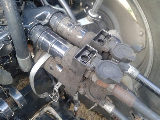

There are 4 hoses going into a FAST brand connector 2 banks of 2 and I have no idea how to disconnect them.:confused:

You push them in and pull them out:dance1:

Yes push in quickly then pull out quicker, all in one fluid motion. The brand name should be "FASTER"

Here is the Faster definition.
PUSH PULL
QRC痴 that use this particular connection technology, which includes also other similar types such as:
Single-acting sleeve free to axially retract and free push, the sleeve of the female part is designed to enable it to operate a double effect: in fact, being equipped with a double housing for the connection spheres,it can be used both pushing that pulling the male coupler into the female coupler.
One of the prevalent application is the agricultural machinery industry, that have been adopting
this connection technology for several decades now.

It helps to relieve the pressure by moving the control for that particular fitting ( implement) with the engine shut of before disconnecting.
