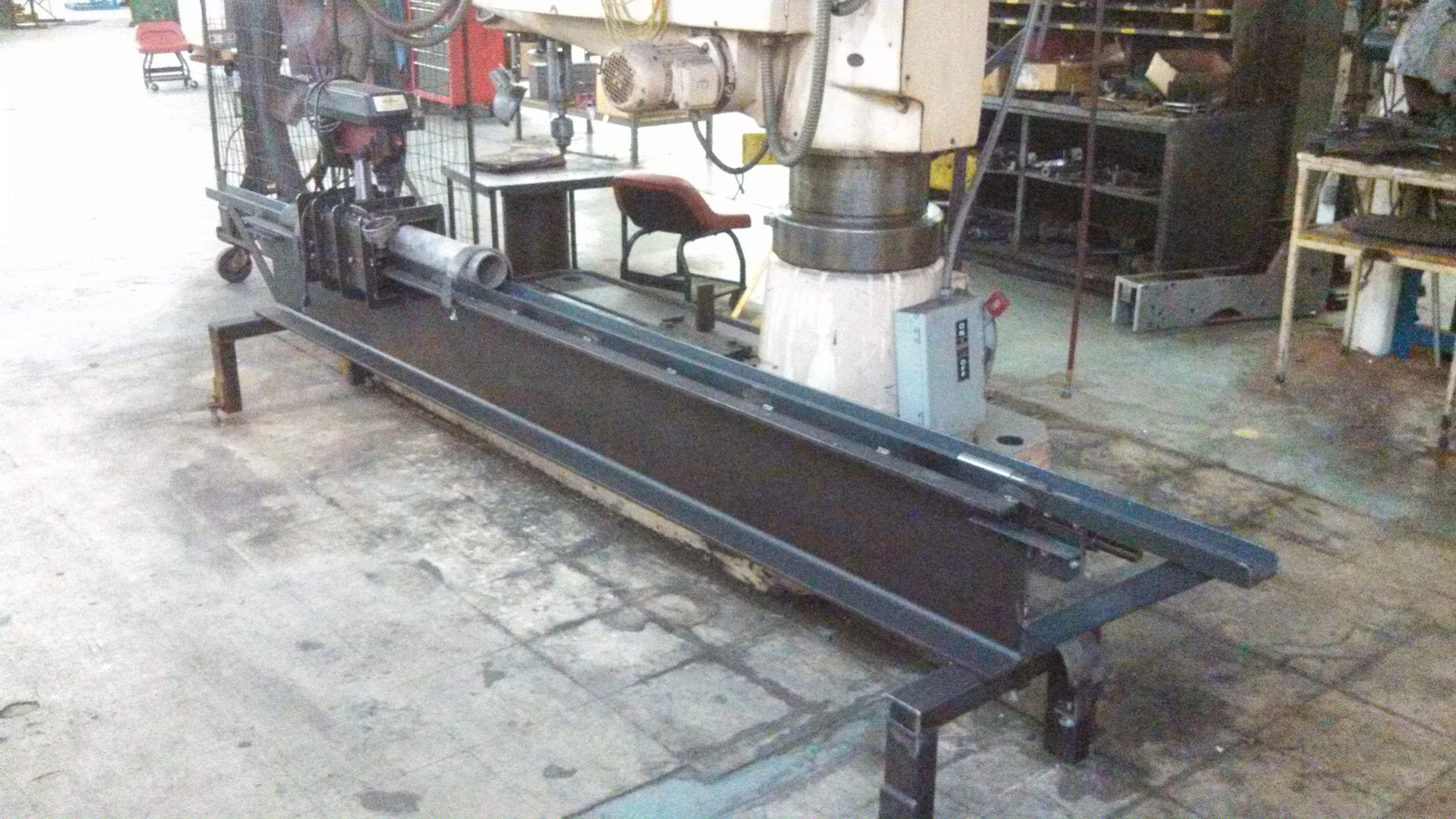

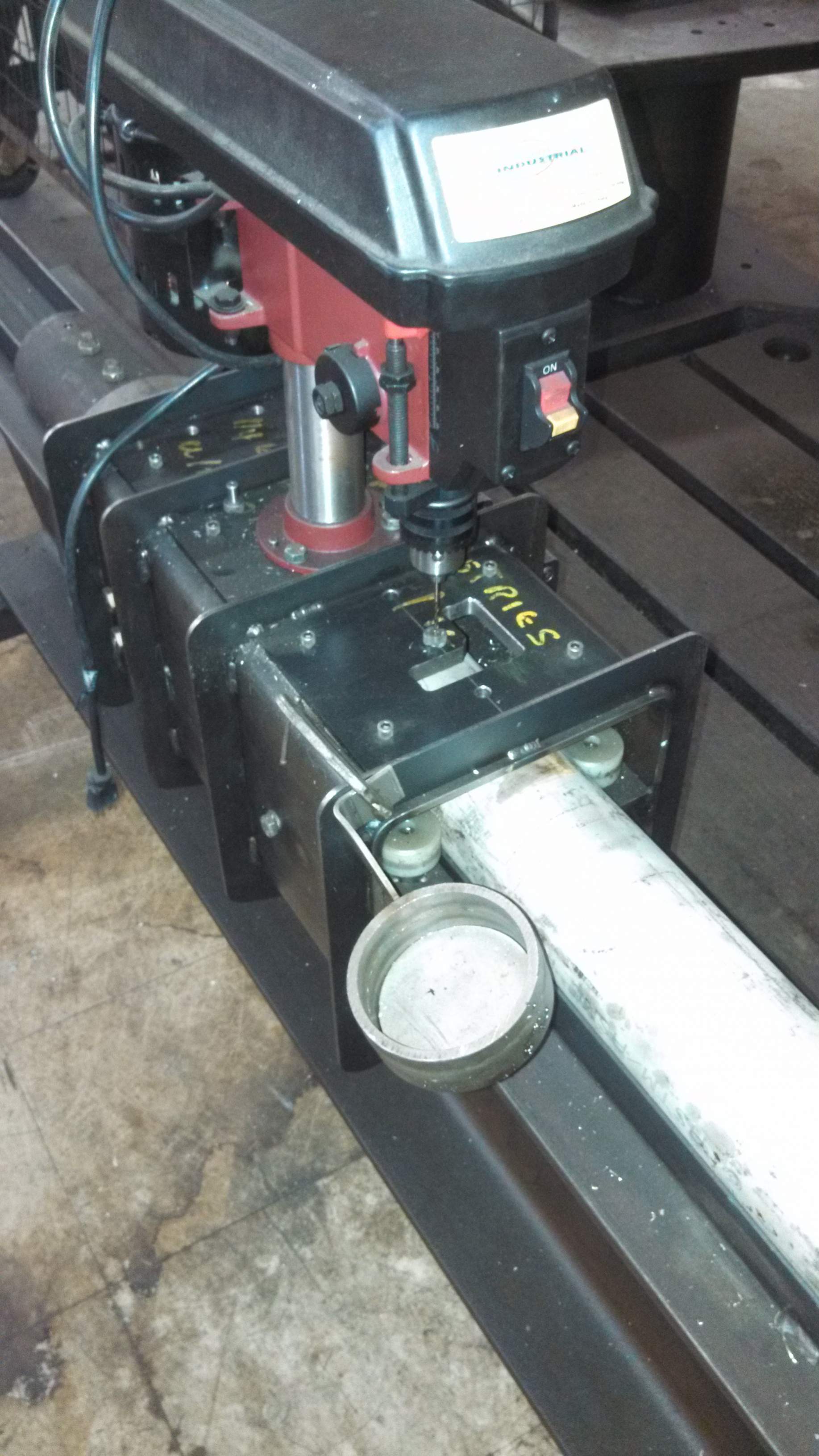

This is a precision way to do it and with the proper drill bushing and bit you don't need a center drill. The drill press rides down the I beam and the pipe is clamped to the channel iron as well as wheels that ride down the OD of the pipe to force center even if it is bowed between clamps.
Holes for stops also ensure precise spacing as well.
