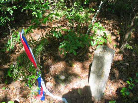

   / How do I find survey stakes? #27
This is a pic of the county highway department Right of Way easement marker along the front of our property along with the boundry marker of our property just to the left in the picture.
Our property was surveyed a long time ago but the stakes were failry easy to locate.

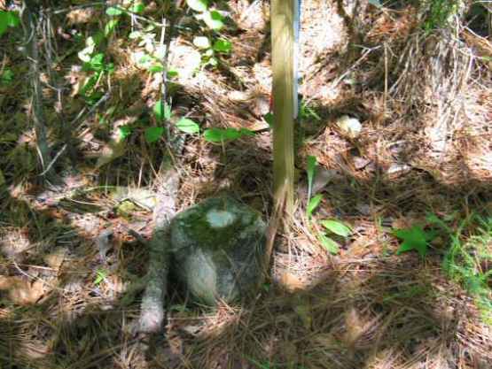

   / How do I find survey stakes? #28
This is a pic of the boundry marker for one of the corners of our property.
It's been there along time, but wasn't to hard to locate.
