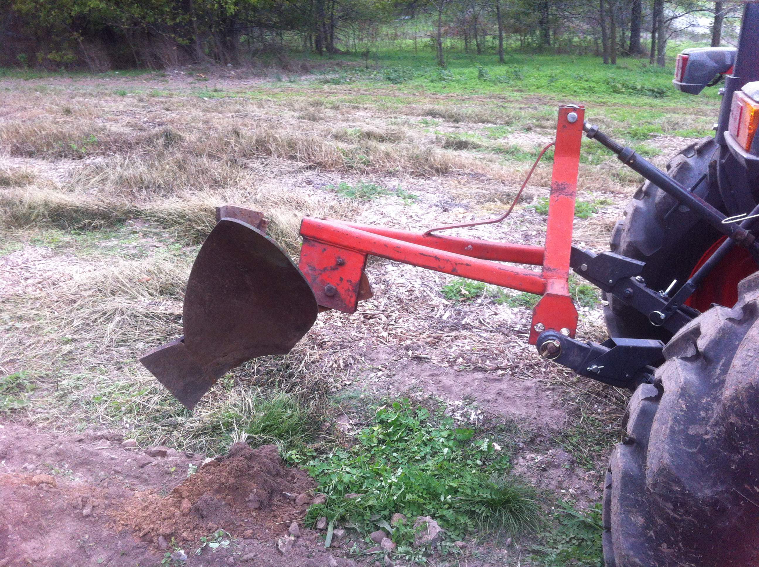

The shear pin broke on my plow. I've tried two more bolts but they instantly shear when the plow starts to dig. What do I put in there that won't break?

Could use more info and some pictures.
/ How do I fix my plow?
First pic shows how it is broken. Second pic shows where the pin goes.

Dang. Well, I would double check your adjustments to be sure the plow is not in a bind. If it is set properly you may need a better bolt. What tractor are you using? I would hate for it to break something. From the pic ( I cannot enlarge) it looks like your plow is centered between wheels. Is it?

I have it set so the right tires ride in the last furrow. The plow is definitely binding. This is the first time to plow this soil and it has rocks from baseball size all the way up past basketball size. I am going slow so as not to break anything. It is a Kubota L3540. In 2wd it will stop and spin. In 4wd it will go ahead and dig up the rock (or break the bolt). I only used 4wd until I broke the first bolt. After that was 2wd but the bolts snapped as soon as the plow started to dig.

Is the plow back end ( cutting edge not mold board) in line with the inside of right tire ? You might can take out less dirt for now to clear your field. I am so glad we don't have rocks like that!

In looking at the side view picture it appears that the brake that goes from the top link down to the main frame is bent. Could this be causing the point of the plow to dig in to much and over stress the shear pin. Is the land slide parrallel to the ground while in the furrow?

Hmmm. I see what you mean but I have the top link set up so that it is parallel at its deepest point.
