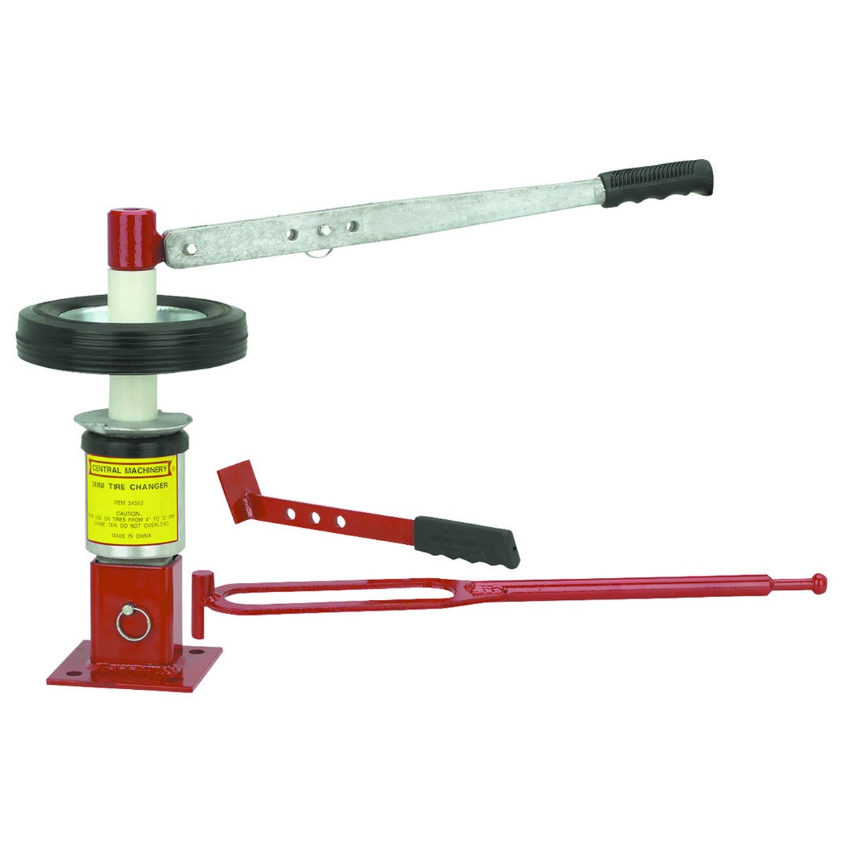

..... but it's so awkward to handle and so slippery to mount that I need some sort of machine to mount the tire or I need to know the secret. Anyone ever mount a small and stiff caster tire to the wheel? How on earth do you so it?
I have three to do (two 4.10/3.50-4's and a 13 x 5.00-6) .... tomorrow I'm picking up one of these:
Harbor Freight: ATV, Golf Cart, & Mini Tire Changer
I'll let ya know how it works out .... :rolleyes:

Very interesting mini tire changer. Let us know how it works.

The 'secrets' are to use the axle bolt in the vice (as mentioned already, use dish soap to lube the bead area, two large dull flathead screw drivers for the bead lifting levers, and two vice grips to keep the bead in place at the wheel locations you just pulled it over. Those are drop center wheels, so you need to keep the opposite side bead area in the drop center well.
That's exactly how I've done it. It still takes a long time and is hard work. I also use full size tire irons and a pair of motorcycle and bicycle ones. However, I haven't managed it without putting dents in the rim bead because they just don't make them out of very thick steel.
