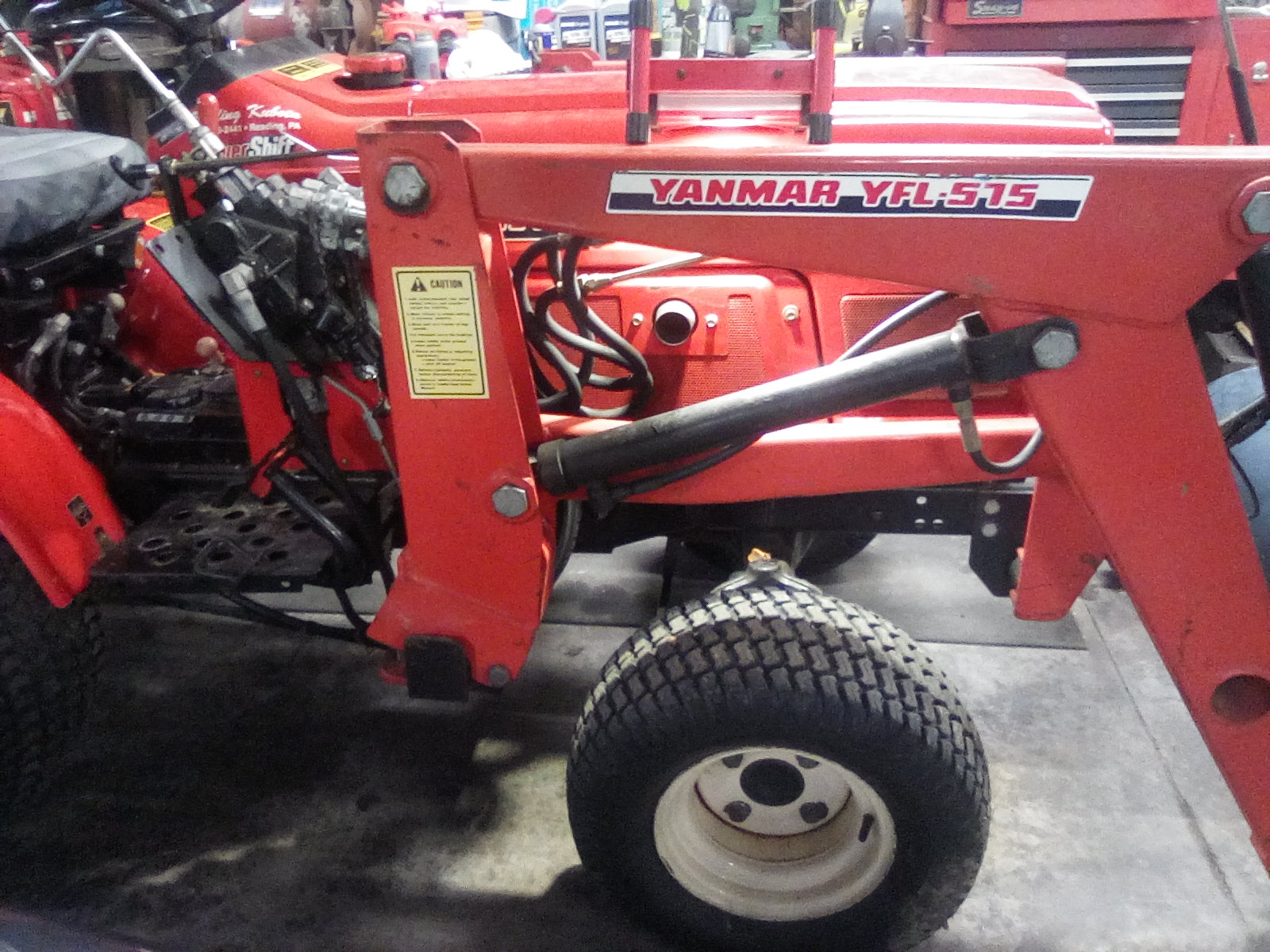

I'll add a picture of the baby of the Yanmar family.
The YFL 575.
