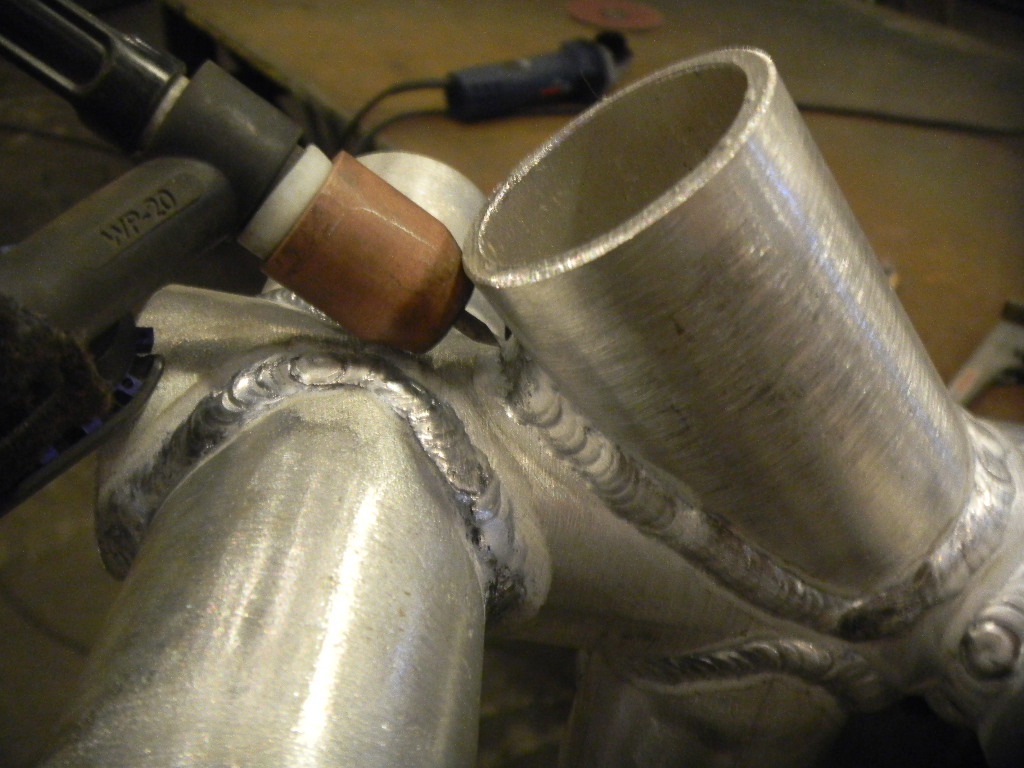

So what's with TIG gas lenses? Do they help reduce turbulence? I'm having a hard time thinking that something that helps to reduce turbulence can possibly help when there is so much hot gas being produced when welding. Sorry, I'm pretty green when it comes to arc welding with a shielding gas.
One thing a gas lens is designed to do is "focus" the gas down the tungsten to allow more stick out of the tungsten from the cup This will allow you to reach down into crevices better.
James K0UA
Yeah, that is one of their biggest selling points, not sure I buy that either.
