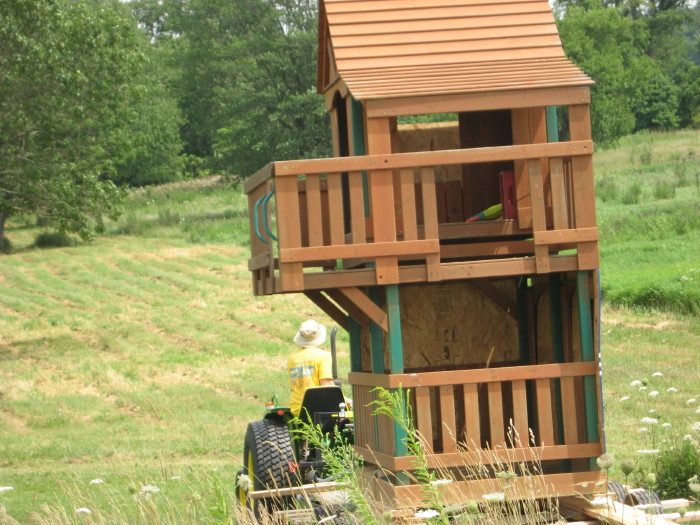

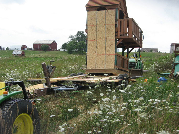

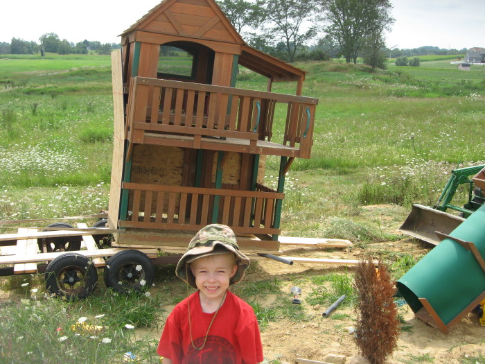

I moved my play house with my dad driving the tractor (about all he was good for..all the ideas were mine!). I wedged each side up and slid/hammerred a 2x6 under and screwed to the playhouse frame. Then I put 2" plastic EMT under and winched/rolled it onto the trailer. My dad drove it to my new spot under the trees....he almost tipped once! Then he lifted the 3PTH and we rolled it back off. It took a couple hours but at least I didn't hurt my dad.
