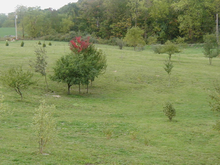

Hi Gary,
Two years ago we started on a piece of land that was an old apple orchard. It was full of brush and weeds. There were a lot of wild rose bushes and some sort of bush that is similar to Russian Olive. Some of the rose bushes were three inches in caliper but most were less than an inch. The wild berry bushes added to the thorny problem.
We bought a 4300 Deere and five foot bush hog and started to work. I cut everything I could and used the tractor or my 3/4 4x4 to pull out the big bushes. We can open burn brush in our area so we had some large scale burning days when the conditions were right.
The thorns were a problem until I added leak sealer to the tires and that was a good solution. The roots that remained were attacked with an ancient home made tooth tool borrowed from a neighbor. It worked great to hook and pull out the roots without a lot of damage to the top soil. I really did not want to reseed the whole eight acres.
Once the high weeds were cut down and most of the bushes removed, we just kept mowing the area. I was surprised this spring how well the old grasses have filled in. I have attached a picture of the area. It is no finished lawn but it keeps getting better all the time.
