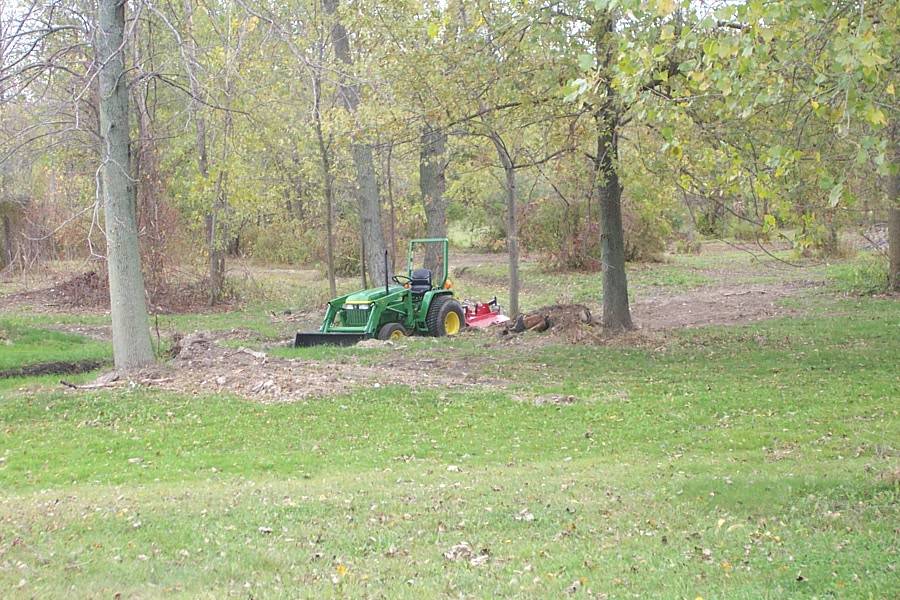

Glenn,
The ditch is 65" wide. I'll try to get some photos today. Yes it is wider than necessary, but I dont see this as a disadvantage. I've put curves in it and smoothed the reclaimed area to look and function as if the ditch was a natural creek.
I plan on leaving the ditch this wide until next year to see what the effects of erosion will bring. If I don't get smooth sides, I will smooth the sides myself using FEL or tiller or scraper or combo.
If you were to use a backhoe, my guess is that this natural smoothing would occur as well and you might have to maintain the ditch more frequently than a wider one.
I moved the dirt into piles which I scraped over severely rutted areas and smoothed these areas with the scraper without tines.
Buck

Glenn,
Here is the view from the boxscraped ditch.
Buck

That's a nice way to do gentle drainage ... time and nature will weather it and smooth out the vertical sides of the ditch ... I also like the use of grass in the ditch ... nice job
