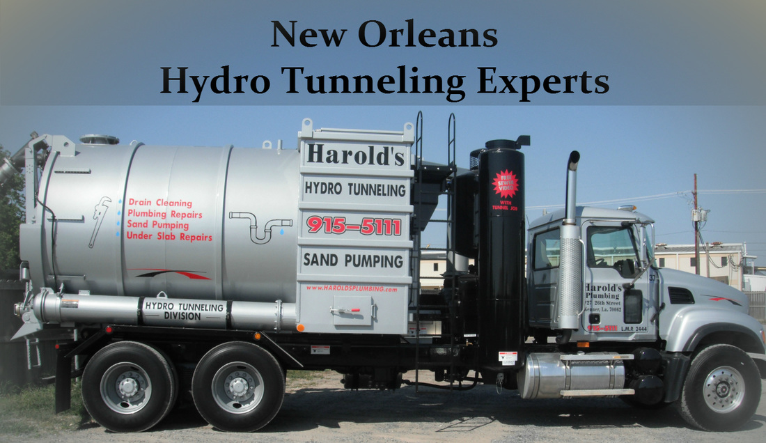

Hydro tunneling is the most popular method in our area. They go under slabs, road, railroads, parking lots, etc.
The truck has a water supply with a high pressure jet and it vacuums the loose dirt out into their tank then goes and dumps it. They can also pump sand back into the hole after or pump sand under homes that have low spots under them.
